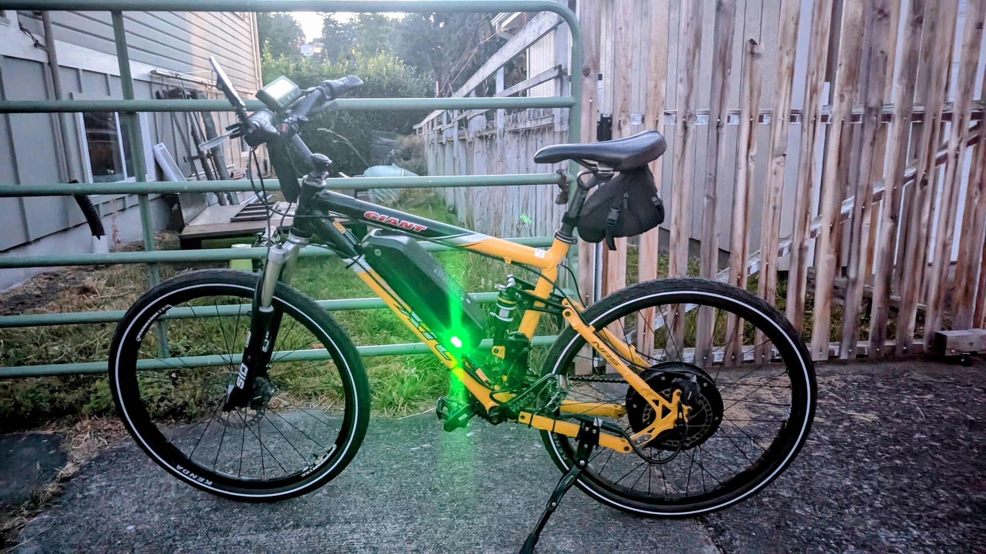

Least expensive way is to motorize a bicycle that fits the bill. And I'm sure that there are production bikes that do it too. The good stuff is expensive. Even doing a build your own can cost up to $3k. I do love my Grin motor-kit. Here it is on it's second donor bike:

nice bike!!! any models or brand for recommendation? my budget tops to 4K USD...
For motorization I have no recommendation other than to buy a lightly used quality bike that you think will work for you. Of course, you need to figure out how to fit your chosen motor, and how to fit your chosen battery.
The problem is finding that used bike, and it really should be under $300. There are millions of used bikes in the US. The best ones are stored dry and have been rarely ridden, and those seem to be the quality bikes. Grandpa's bike, I guess.
If you can get those lightly used used bikes cheap, they are just donors. You can swap the electrics into the next bike. With a good electric motor kit it's plug and play.
Do what my wife did....put 'aggressive treaded' 700's on her 29" Giant TalonE! No need to change the rims; the 700's fit right on the 29".
What’s been said!! Find a bike that can handle the roads/paths/trails you like to ride and motorize it. I recently put a Bafang BBS02 on a two-wheeled recumbent that was not selling and resurrected it into a great riding bike. I’m glad I realized it’s potential. The motor kit was an easy install but if you’re not into the mechanics, someone can put it together for you.
