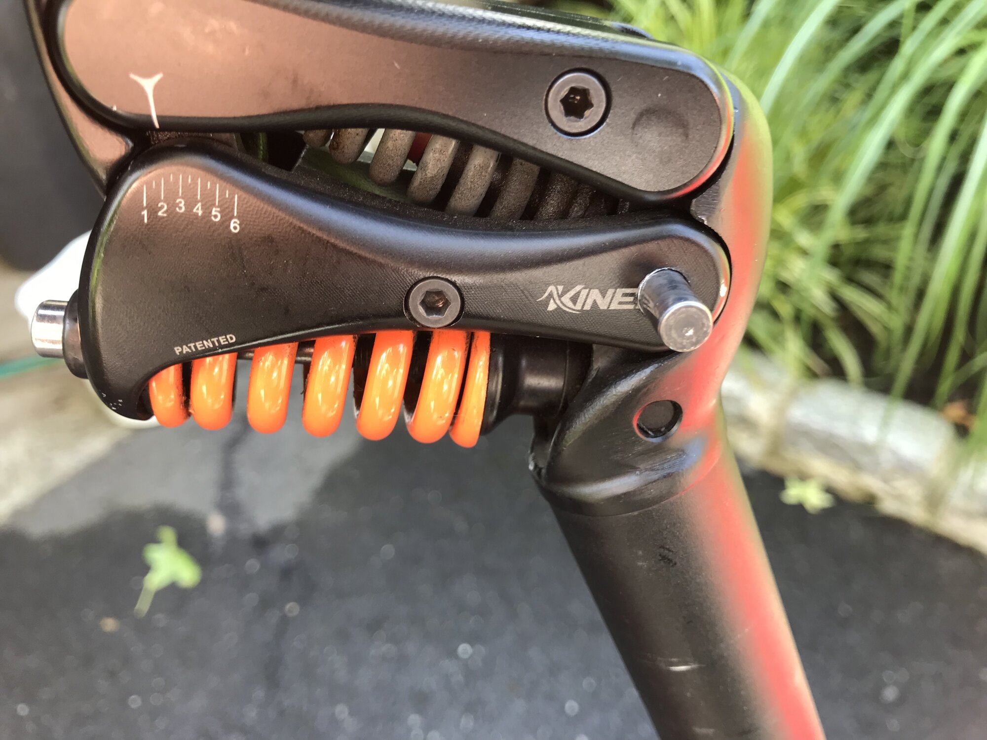

Note: Kinekt comes with replacement springs for different rider's weight. The "light" (violet) spring works for the rider's weight of 100-150 lbs. When ordering, you should specify the preferred rider's weight though to get the right spring set.

When I ordered the Kinekt seat post the rep from Cirrus said to add 20 lbs. He said bumps are magnified due to the increased weight and speed. So getting the correct springs and dial in the setting is important. I was surprise but found this to be true.
Aye. I am in the upper limit of the MD spring and find my rides too bouncy. I should find the LG spring that came with the seatpost and actually use it.
Same here, I’m at upper limit of the purple springs, including the extra 20 lbs. The rep said to use one purple and one black (next size up) spring and it’s fabulous now.
