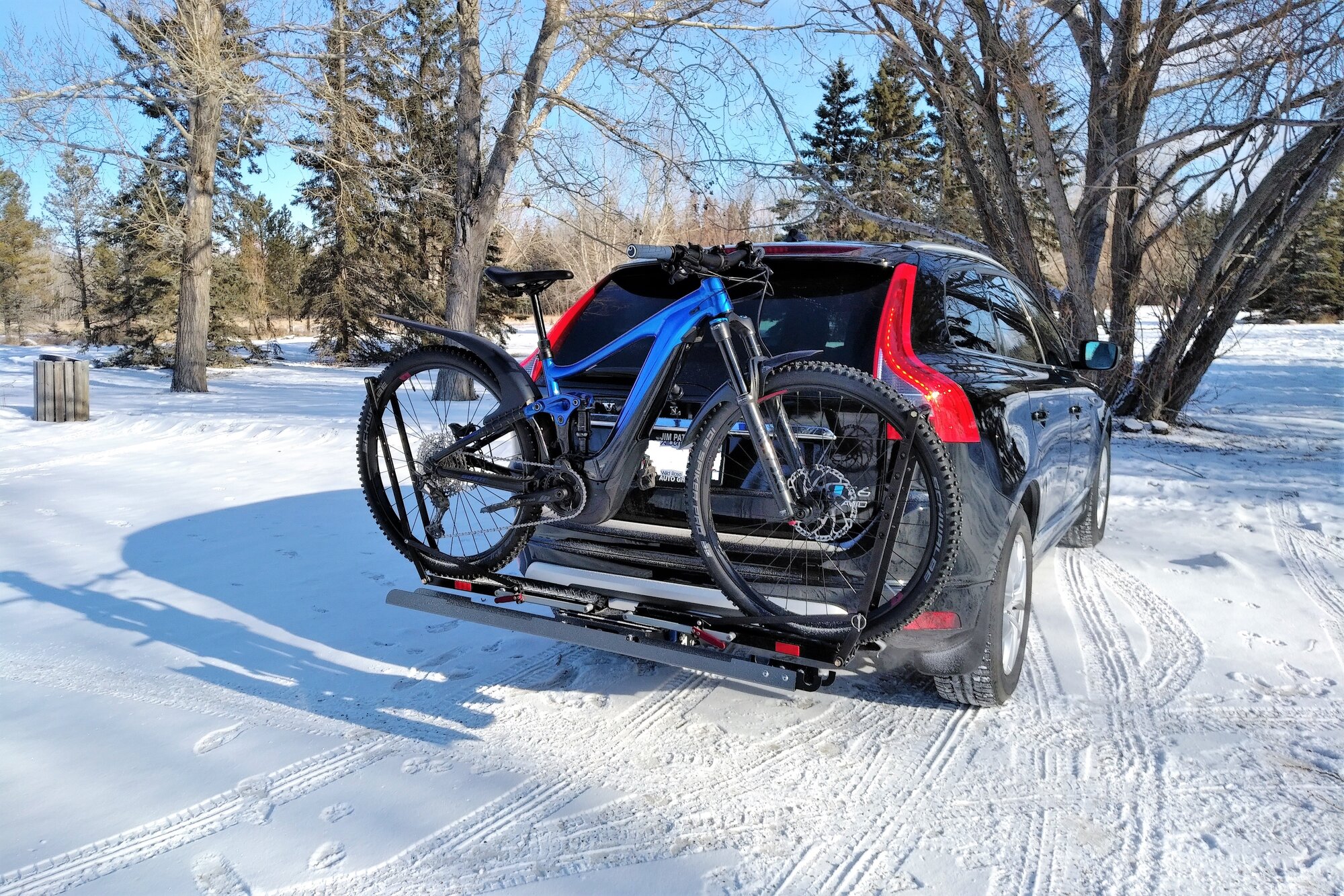

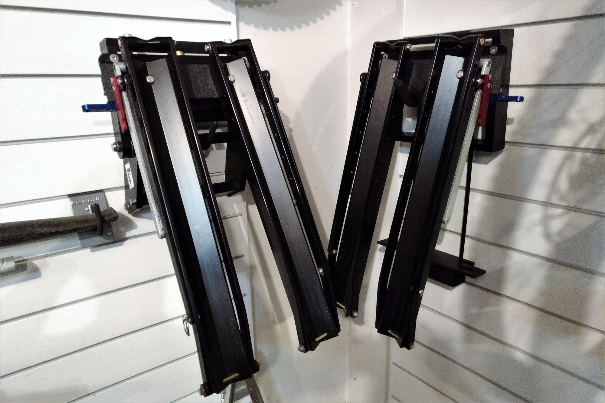

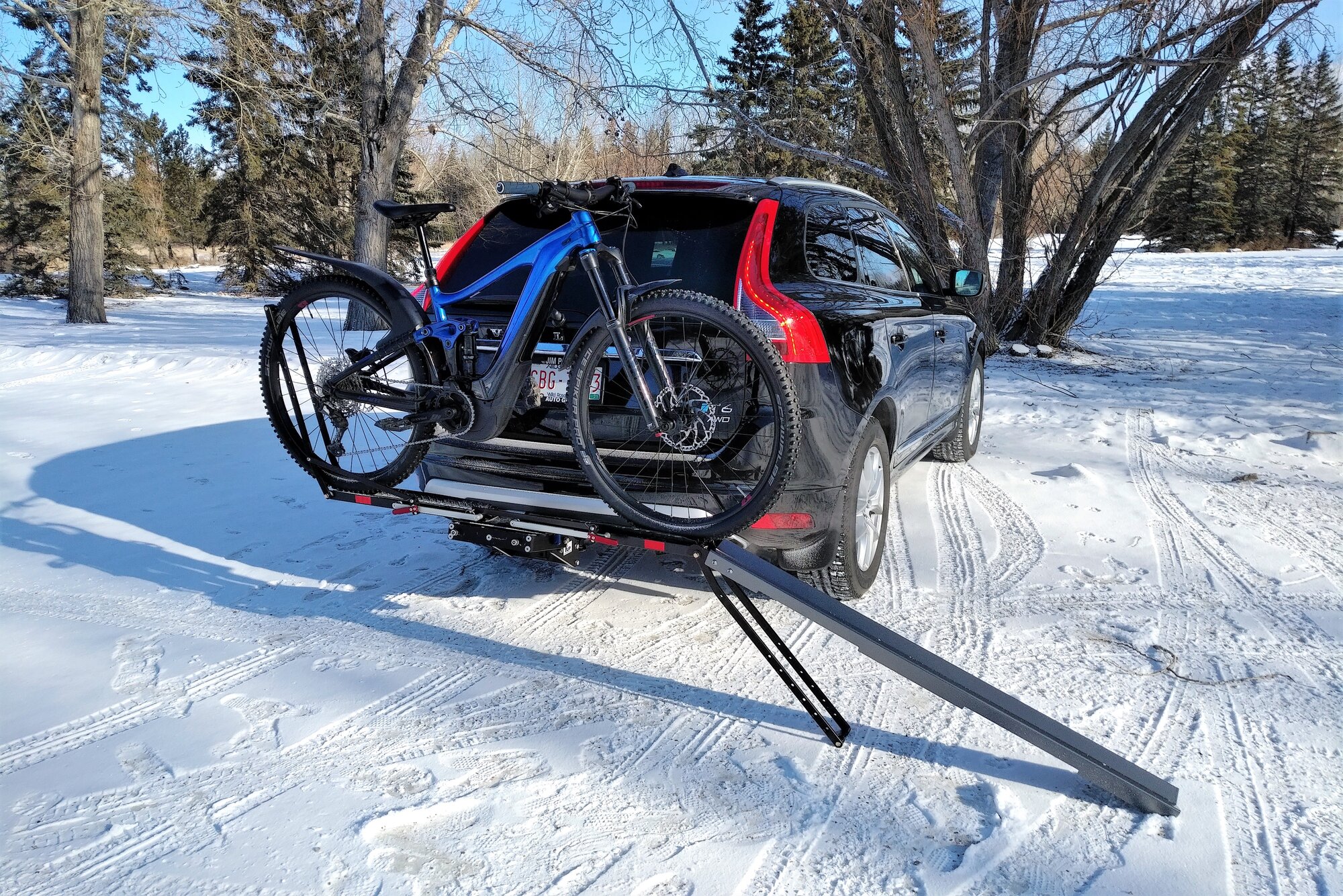

The nice feature with 1Up is the weight of the base rack which is 28lbs for the Superduty 2” single. It works great for transporting a single bike and is easier on the back when attaching it to the hitch receiver. The add on is 18lbs but unlike most racks you’re not forced to lift an entire rack assembly where dual trays are permanently attached together.
The ramp is easily stored on the back of the rack by aligning keyhole slots with security bolts. I admit that I haven’t used it much and still find that I’m able to load ebikes onto the trays in the conventional manner.

Does 1 UP make the ramp?
Yes. It’s also powder coated, can be configured to fit on either side of the bike trays and is also compatible with your Quick Rack. It does require swapping out the stock metal hardware for clevis/hitch pins at the bent arms. This allows the arm to be folded down so that the ramp can be hooked into place at the end of the tray. I think that the ramp would be particularly helpful if a vehicle’s hitch receiver is quite high up off of the ground making the task of lifting a heavy ebike all that more difficult.
