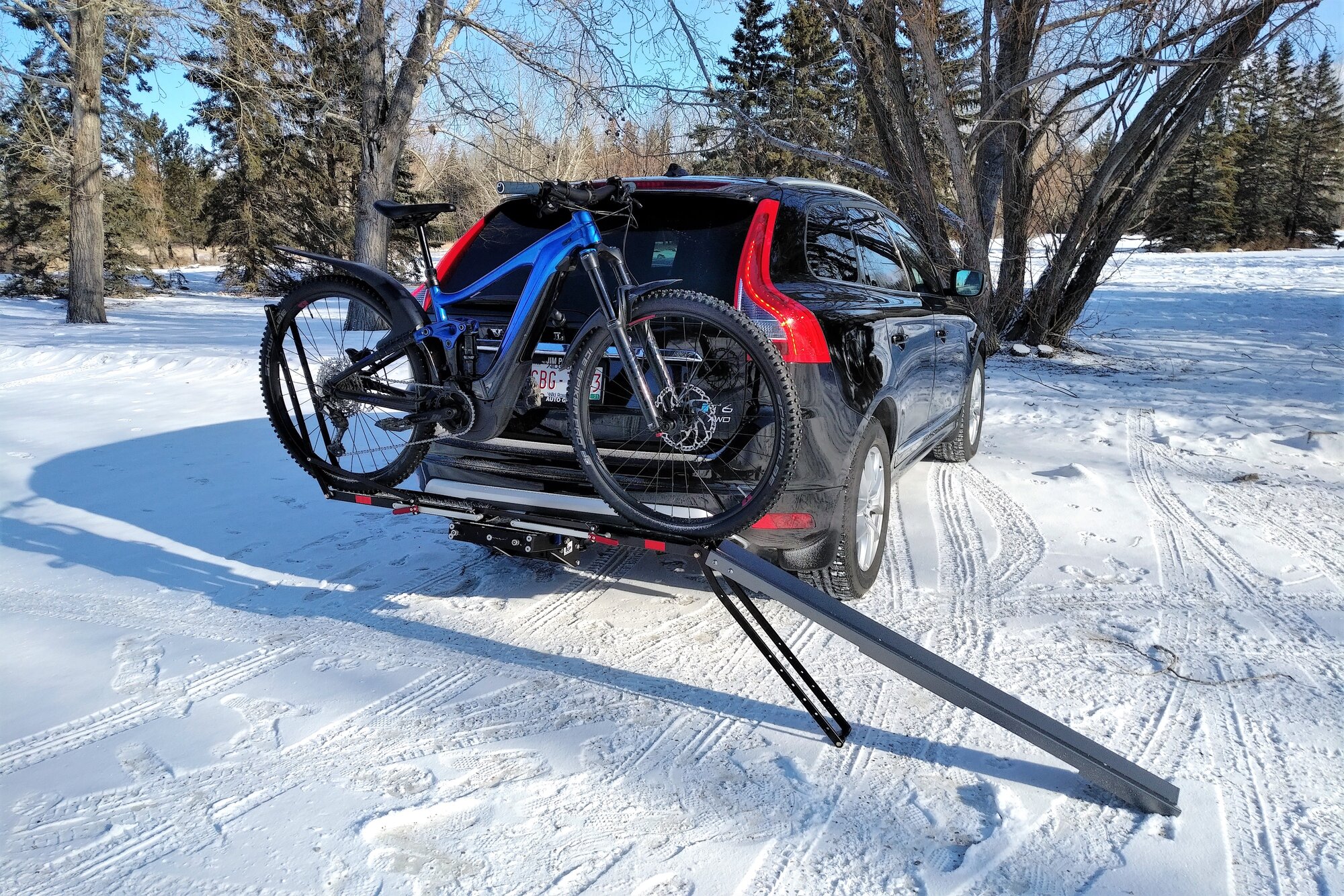

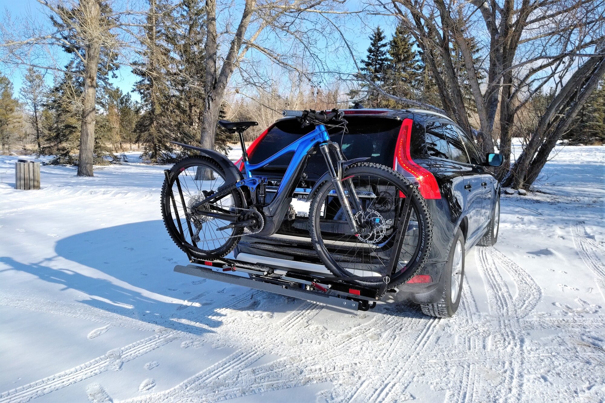

The nice feature with 1Up is the weight of the base rack which is 28lbs for the Superduty 2” single. It works great for transporting a single bike and is easier on the back when attaching it to the hitch receiver. The add on is 18lbs but unlike most racks you’re not forced to lift an entire rack assembly where dual trays are permanently attached together.
The ramp is easily stored on the back of the rack by aligning keyhole slots with security bolts. I admit that I haven’t used it much and still find that I’m able to load ebikes onto the trays in the conventional manner.

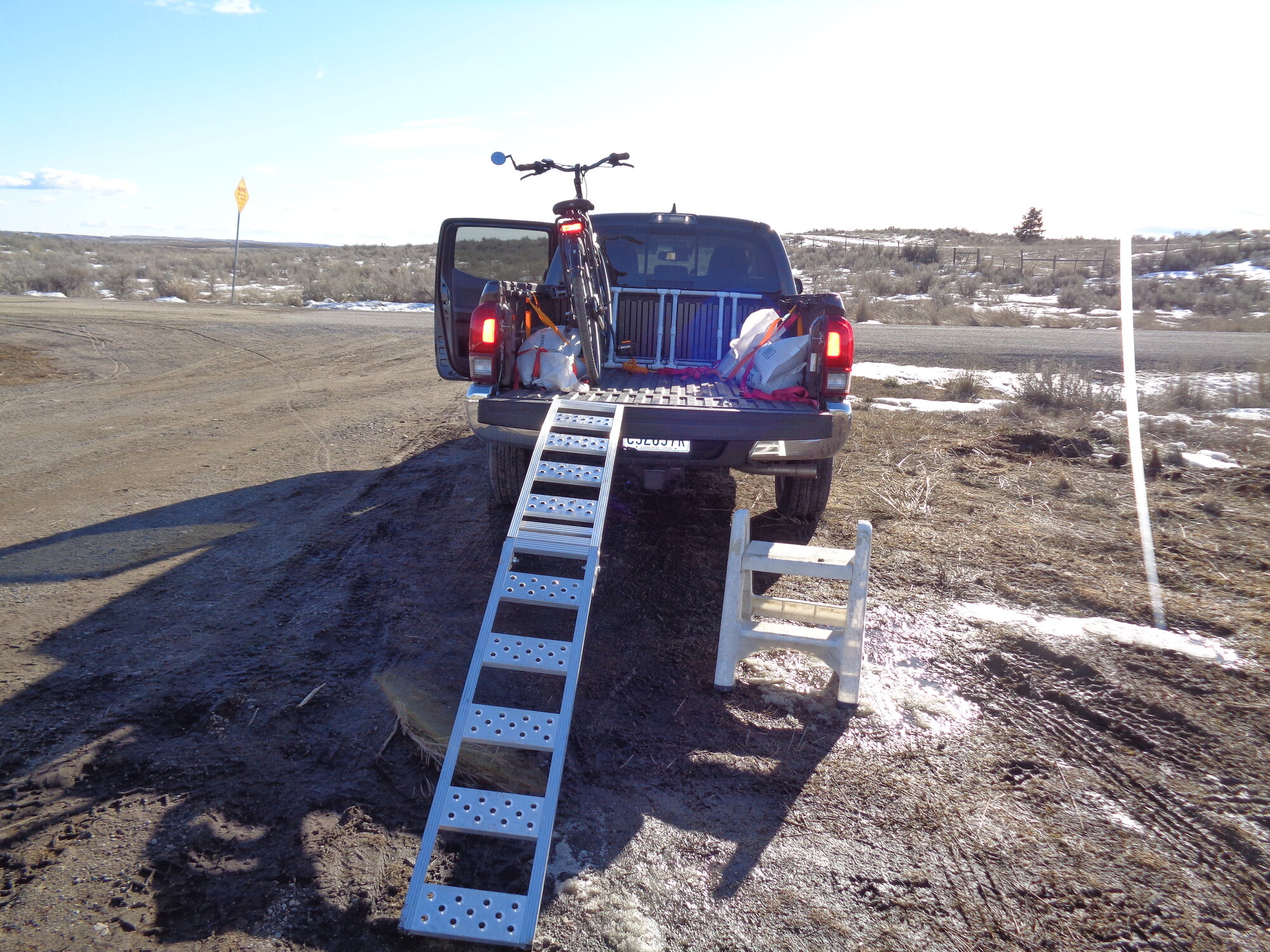

I made a "rack". Found the plans on The Internet. I bought an aluminium motorcycle ramp to roll my bike up into the pickup bed. Roll wheel into slot, use tiedowns to secure, close tailgate. And being short and oldish, I carry a folding step to make climbing up into the pickup bed easier.
this is early spring and I still had my winter sandbags in the back. Ignore them.

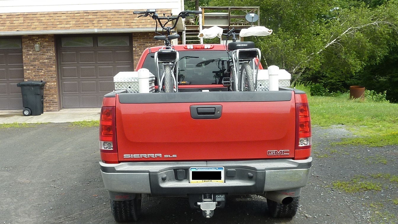

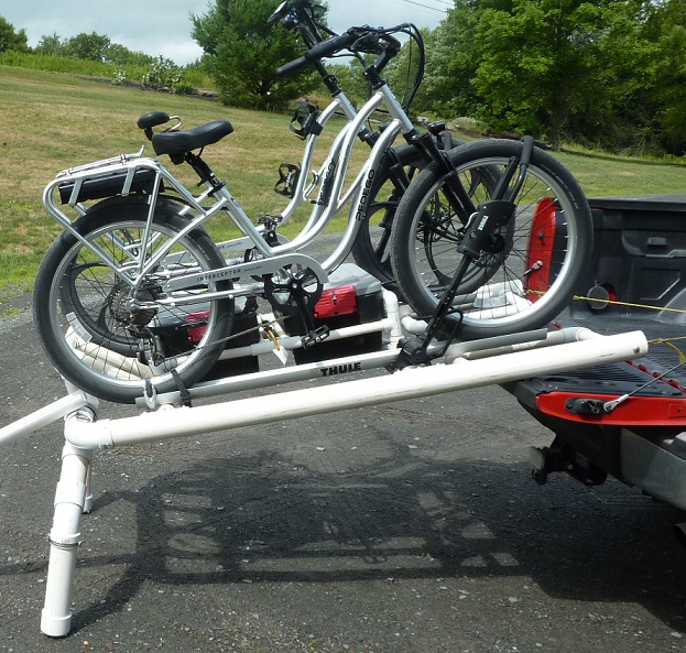

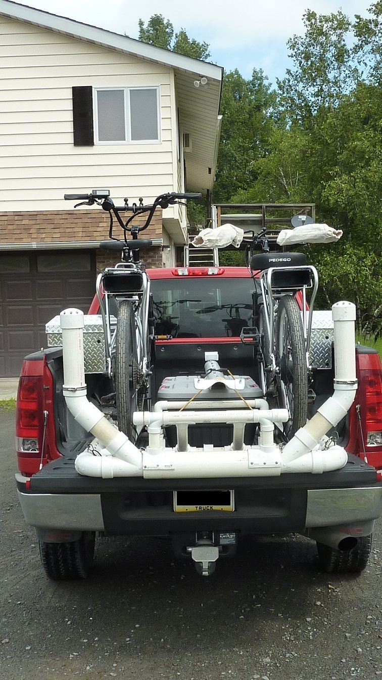

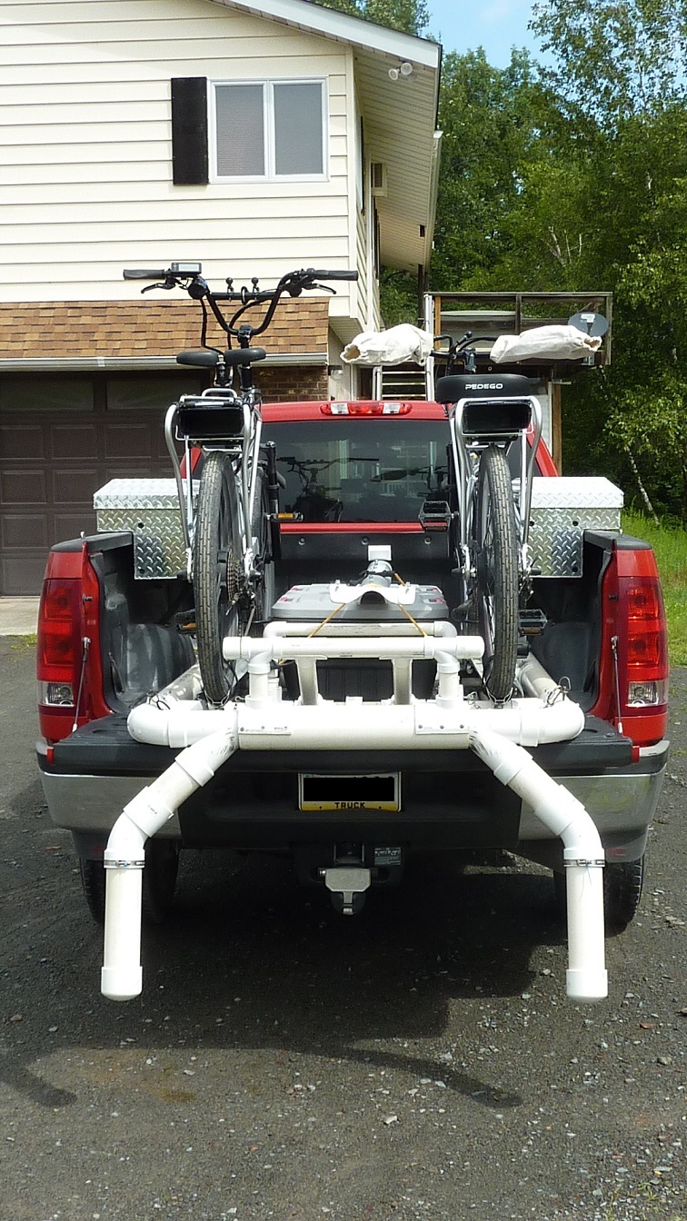

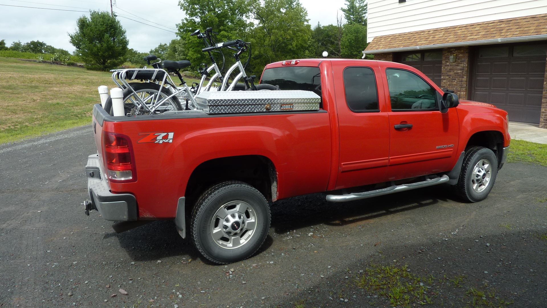

Without doubt, the safest place to carry a bike is in the bed of a pickup. This can be problematic for those who aren't up to loading heavy ebikes in a truck bed though. I've been carrying my bikes this way for many years but I'm now at the age where it's become difficult to lift and climb into the bed to secure the bikes.

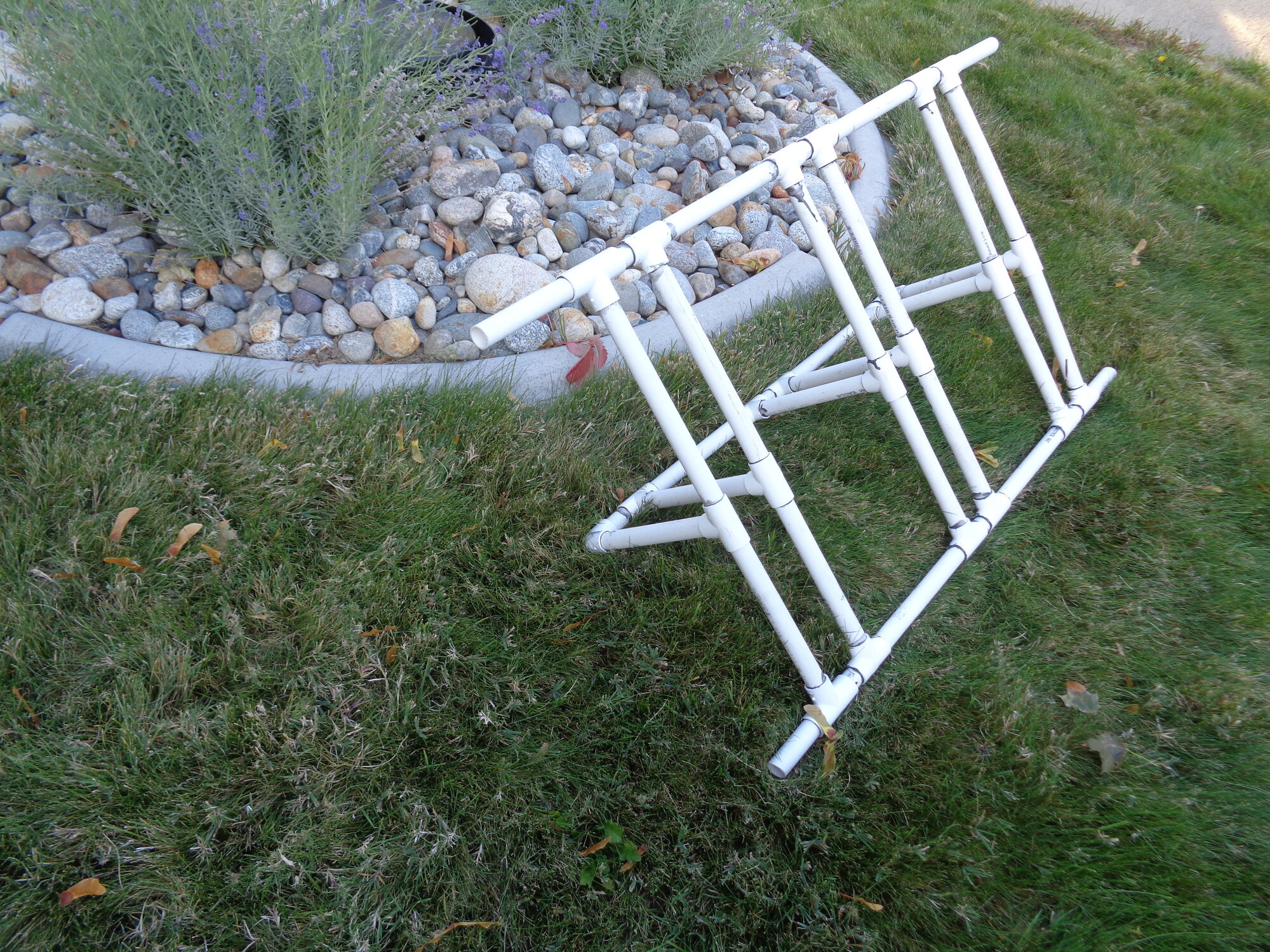

As a result, I built this platform out of PVC pipe that slides out making it easier to load. I use Thule roof racks to secure the bikes. The platform fits snugly into the pickup bed and requires no tie down at all. Due to it's nature, the PVC slides easily in and out of the bed with minimal effort.

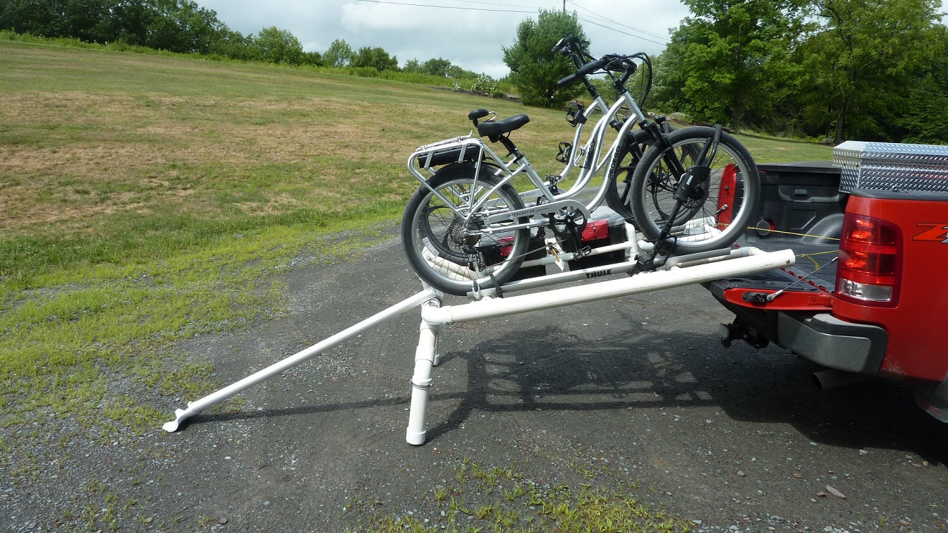

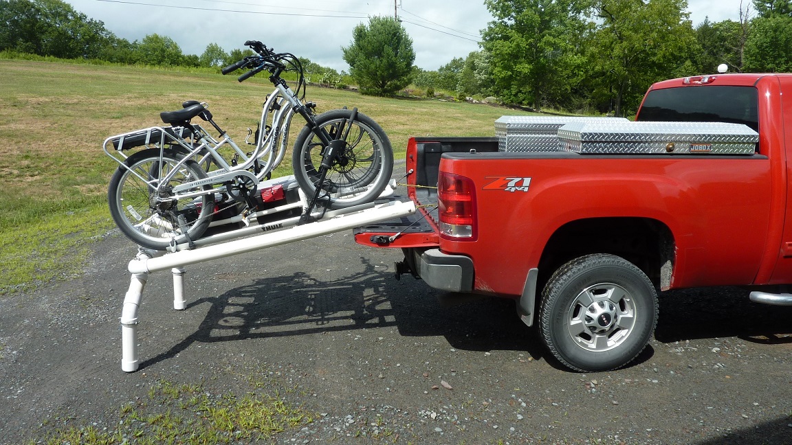

A couple of years ago, I added a ramp to avoid having to lift the bikes onto the platform.
I believe Alan made something similar using 2X4's. Perhaps he could post a few pics.
Some DIY skills are required but it's not a difficult build.
