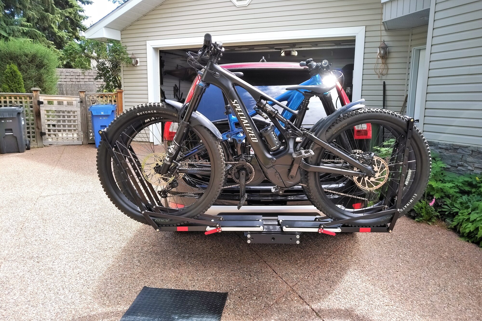

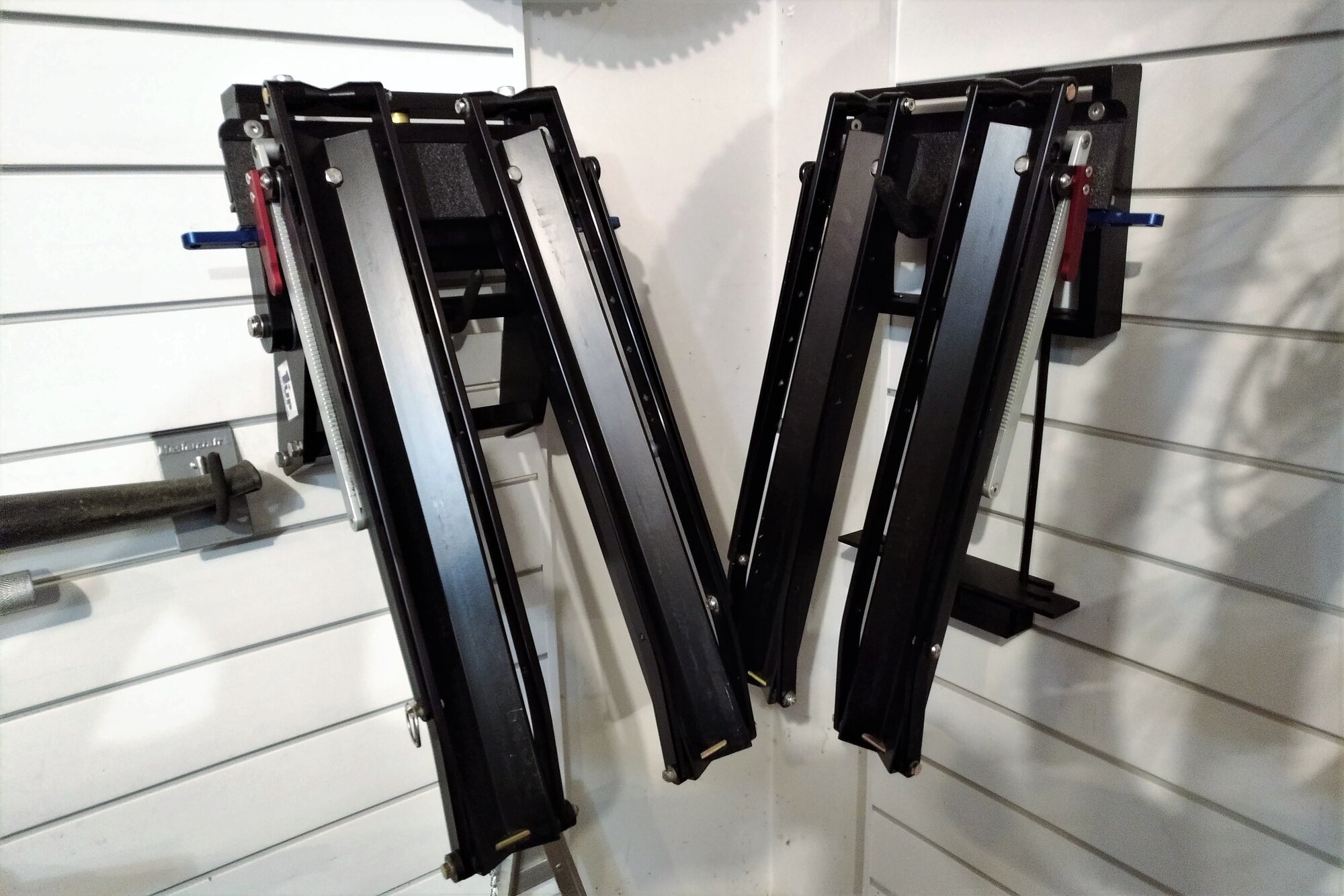

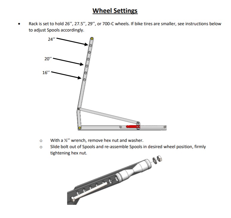

I personally have driven our Volvo with a pair of emtbs on a 1Up Superduty single with an add-on over 100 km without any issues. I can’t comment on the Thule but my neighbor who also uses a Thule Easyfold to carry a pair of Volt ebikes behind his Subaru Forester doesn’t appear to experience any problems with it either. What I love about my SD single with the add-on is that I have the option of either carrying one or two bikes. It’s all metal construction and the fact that it occupies a small corner of space in the garage also played a key role in my decision.

Pricey I admit but the Thule Easyfold is also north of $1K but should accommodate fenders as it employs frame clamps. One up also carries fender cushions and wheel stops but depending on how far the fenders extend one could also move the wheel spools further down the arms to secure the tires/wheels in place.
