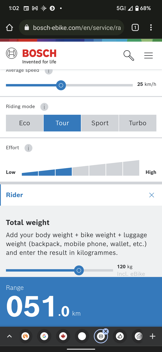

Range
Like you, I am a 90 kg (or so) person, and my legs cannot improve for health reasons. My Turbo test on an older 45 km/h Vado 5.0 with 604 Wh battery gave me the range of 43 km (loop) when riding on a 14 C morning with moderate wind and totally on the flat. I covered that distance in 1 h 28 min net with the average speed of 29.3 km/h. You are to cover several hills, so your range would be even shorter than that. Having said that: The 2022 Como 5.0 comes with a 710 Wh battery. If you rode in Turbo all the way, the range would be close to 50 km but only on the flat. Additionally, Como is less aerodynamic than Vado, further reducing your speed and increasing battery consumption.
Analysis: To get the average of 25 km/h, you would be using Turbo uphill only, and Sport mode elsewhere. (Slower average speed means more range). You would either be not pedalling on descents or you would put the assistance to OFF there (there is no reason to pedal or be assisted downhill); that helps conserving the battery charge very much.
Conclusion: While you might make the round-trip on a single battery charge of 2022 Como 5.0, you should better consider taking the battery out from the frame and charging it inside at work. (That would be unavoidable with the 500 Wh battery of the Allant+).

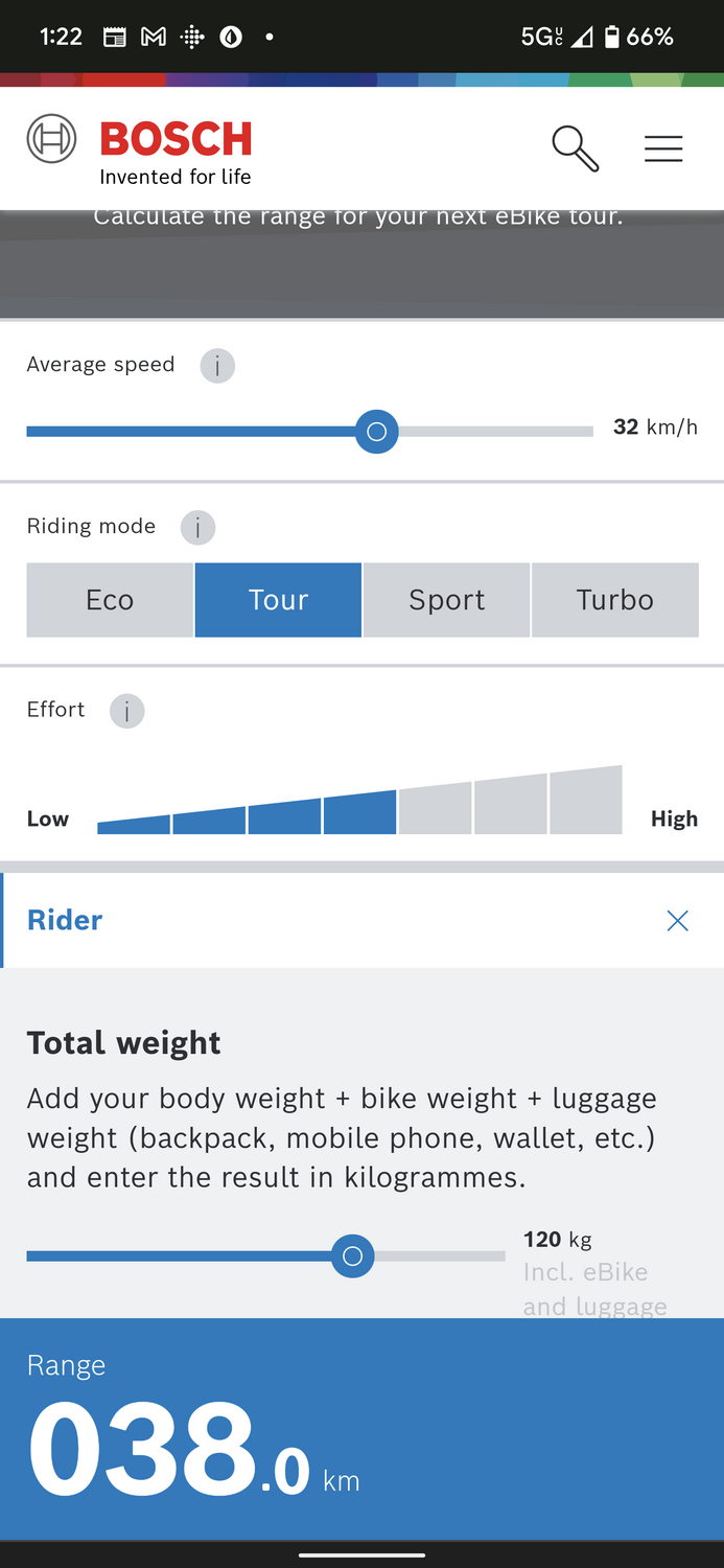

If you go to 32kph on the Speed motor then range drops considerably:

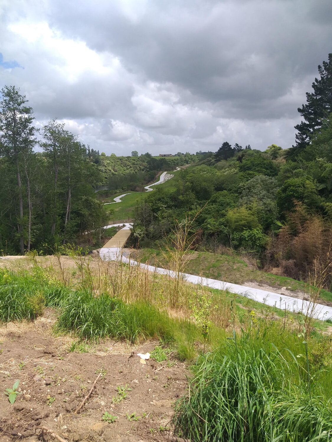

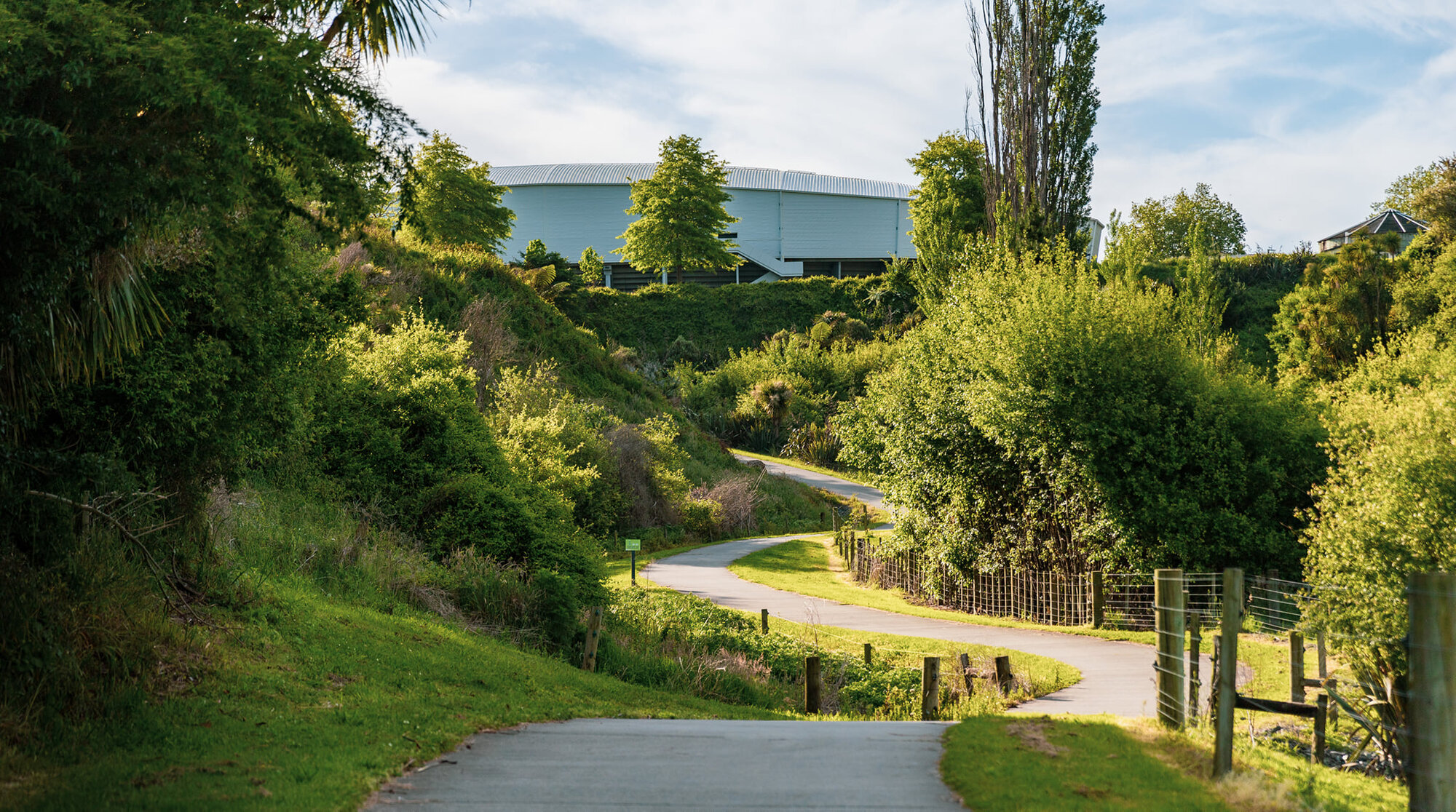

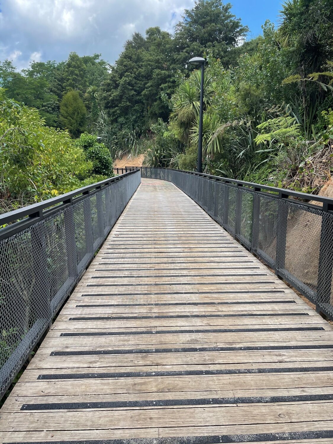

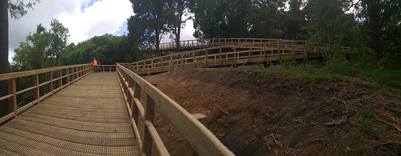

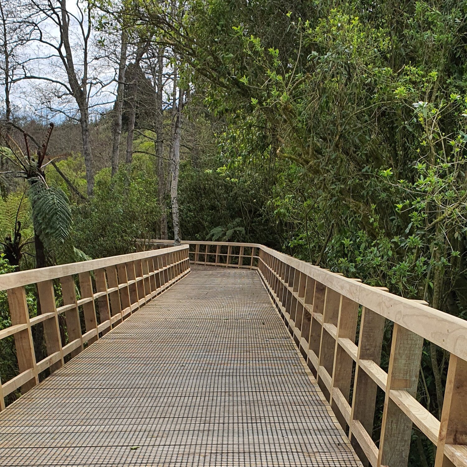

Thanks, guys, for your tips and recommendations so far. I have managed to find some progress photos of parts of the shared cycleway/walkway last night on the Government website. As per the latest update, it looks it will only complete and open around the end of March 2022 due to COVID lockdown delays. It is a 60KM long shared track linking the major city with two small cities that are neighboring along the river. They have already opened the first small city's path earlier this year linking it to the major city, but our small city got delayed due to COVID. This delay does gives me a good month or two with the bike to get practice on it and get an idea about battery life etc. I have attached some photos of the shared cycleway/walkway. It does include longboards as well now that I see them in the photos which I imagine, the ebike should have no issues with anyway? compared to concrete and tar seal road that I thought the cycleway would compromise of. Hopefully, the front suspension and tyre quality would be comfortable ride with both the Allant+ 7S or Turbo Como 5.0.
@Stefan Mikes That is a very good observation you made regarding checking the 25KM/h restriction that they have in some parts of the world. I know Australia also has the 25KM/h restriction for ebikes while NZ does not. The Allant+7S is specifically advertised as Class 3 ebike in NZ with 28mph advertising and during my test ride, I did get it up to 37KM/h on turbo so can confirm it's all good in NZ. I checked Specialized NZ page after your speed restriction comment for Turbo Como 5.0 and it advertises 28mph speeds as well and then checked Australian page and it lists it specifically on their website at 25KM/h. NZ is metric so both Trek and Specialized did not bother converting from mph to km/h when advertising their speeds Hehe. I just rang Specialized NZ HQ in NZ and they confirmed that in NZ, it will be indeed 28mph (45KM/h) for their bikes as well unlike Australia and Eruope so that is great news as well.

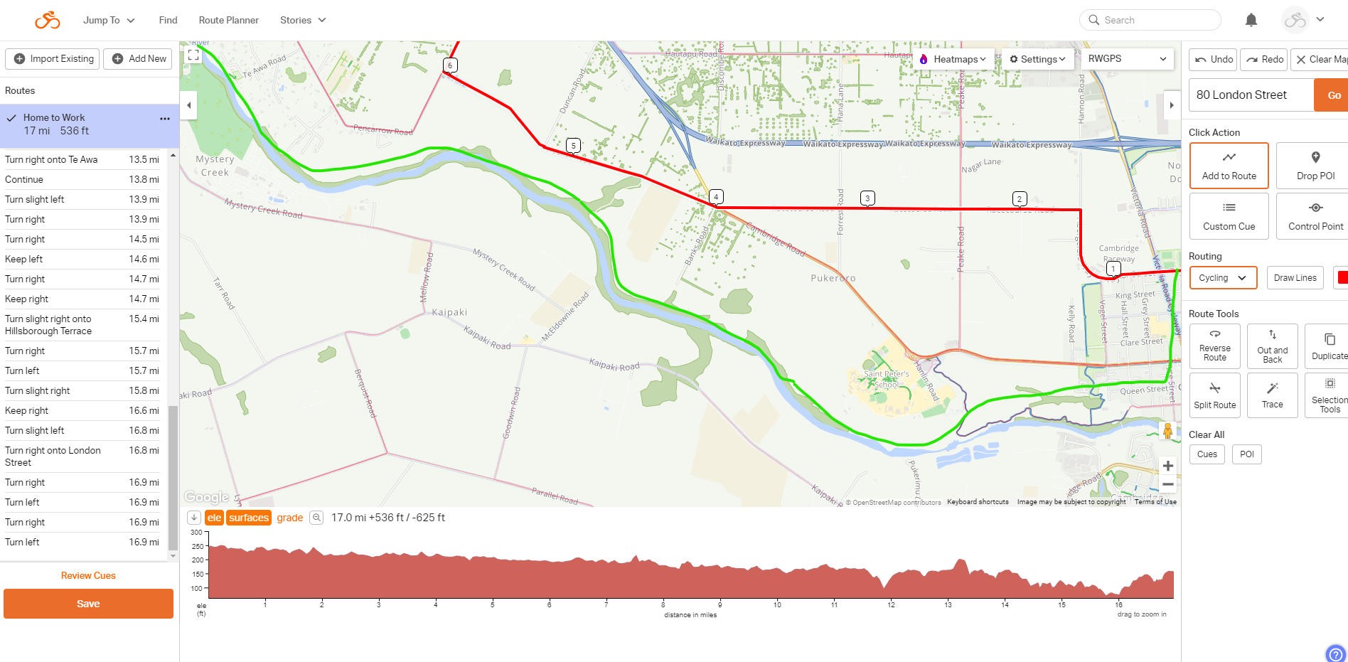

@powersquad: Please try the RideWithGPS app on your computer. Go to Route Planner. Enter your start address and make it the ride start point. Then enter your destination address. RideWithGPS will not only calculate the distance but also the Elevation Gain. Please tell me both figures.

@Stefan Mikes Wow. RidewithGPS is cool. I signed up to the trial for now to get the route planner functionality. The red line on map is what RidewithGPS has drawn. That whole marked route I can tell is the exciting cycle route from my small town to the big town where my office is. It currently goes through 80% tar seal road shared with cars and is not the new shared walkway/cycleway that will open by March 2022 that I have hand drawn in green colour which runs along the river. It's only a part map from screenshot but as you can see my office is in direction and more in line with the green marked line so when that dedicated cycleway open, I should save a lot of time. Is there a way to find out in this website, what time it will take for the existing route that has been calculated as I cannot seem to find that info on their web app atleast.

Hey, you just needed to create an account and you need to "try" nothing. You can also set km and m :) Now:
27 km and 163 m elevation gain. The round-trip on the 710 Wh Como battery should be doable at 25 km/h. You just need a little practice :)

Thanks. I left it on imperial units, but I just saw in your profile that you are from Europe hehe so metric like NZ.
Pardon my ignorance but yourself and posters have mentioned average 25 km/h speed. Is that the general average speed of a trip that ebikes end up taking hills/elevations, turns, traffic into account? I am hoping that with the new cycleway, I power my way through at max speed as possible on Turbo and if I must charge battery at work then be it just so that I can cut down on commute time. Google maps shows cycling commute of 1 hour and 20 minutes from home to office using current tar seal road shared with cars which I am guessing is with a pedal bicycle averaging 15km/h ~ 20 km/h? If I can average at least 35KM/h on the new cycleway which is shorter route than current tar seal route at 35KM/h, I can cut this down to 45-minute commute max? Hopefully not wishful thinking.
