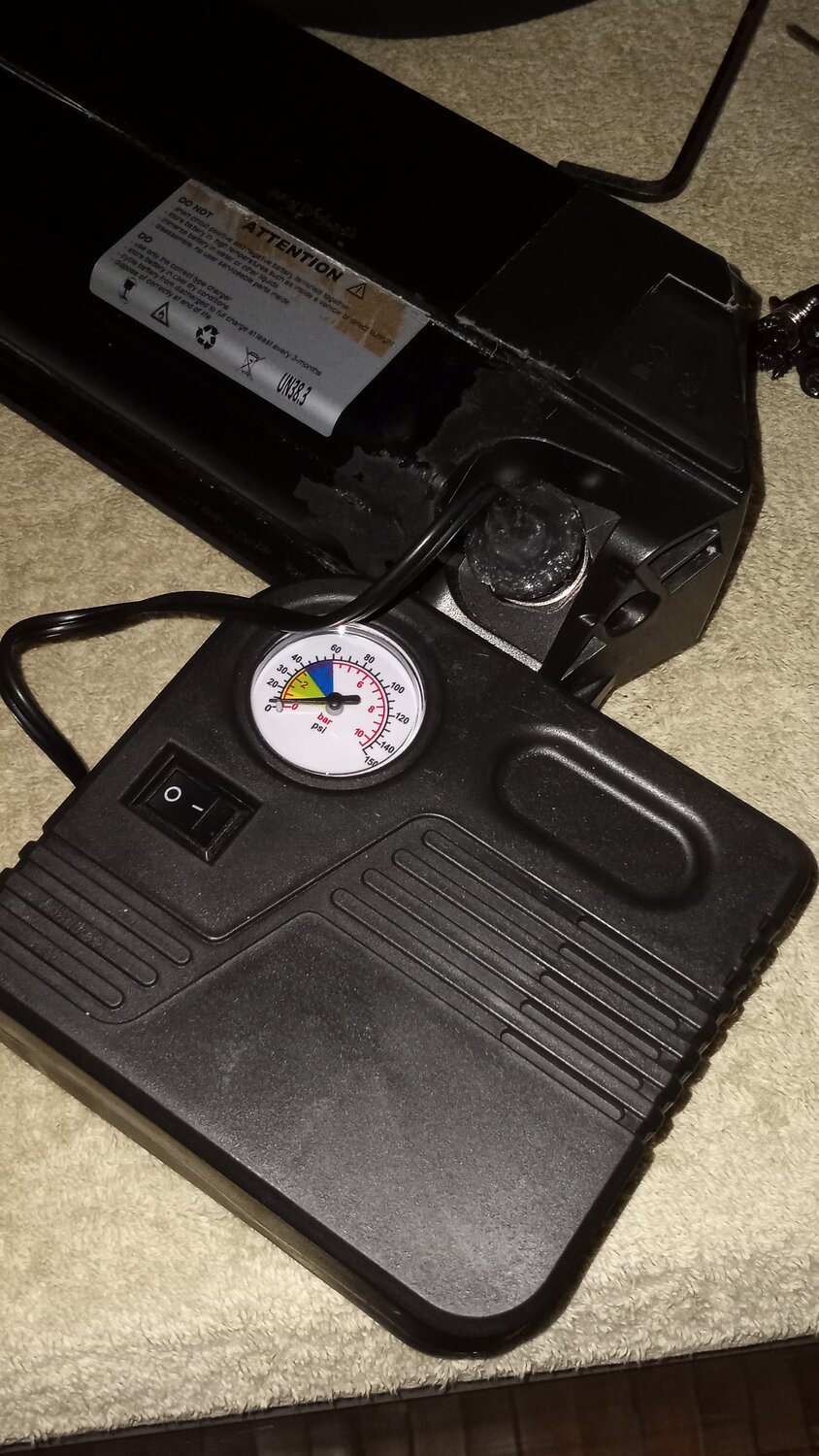

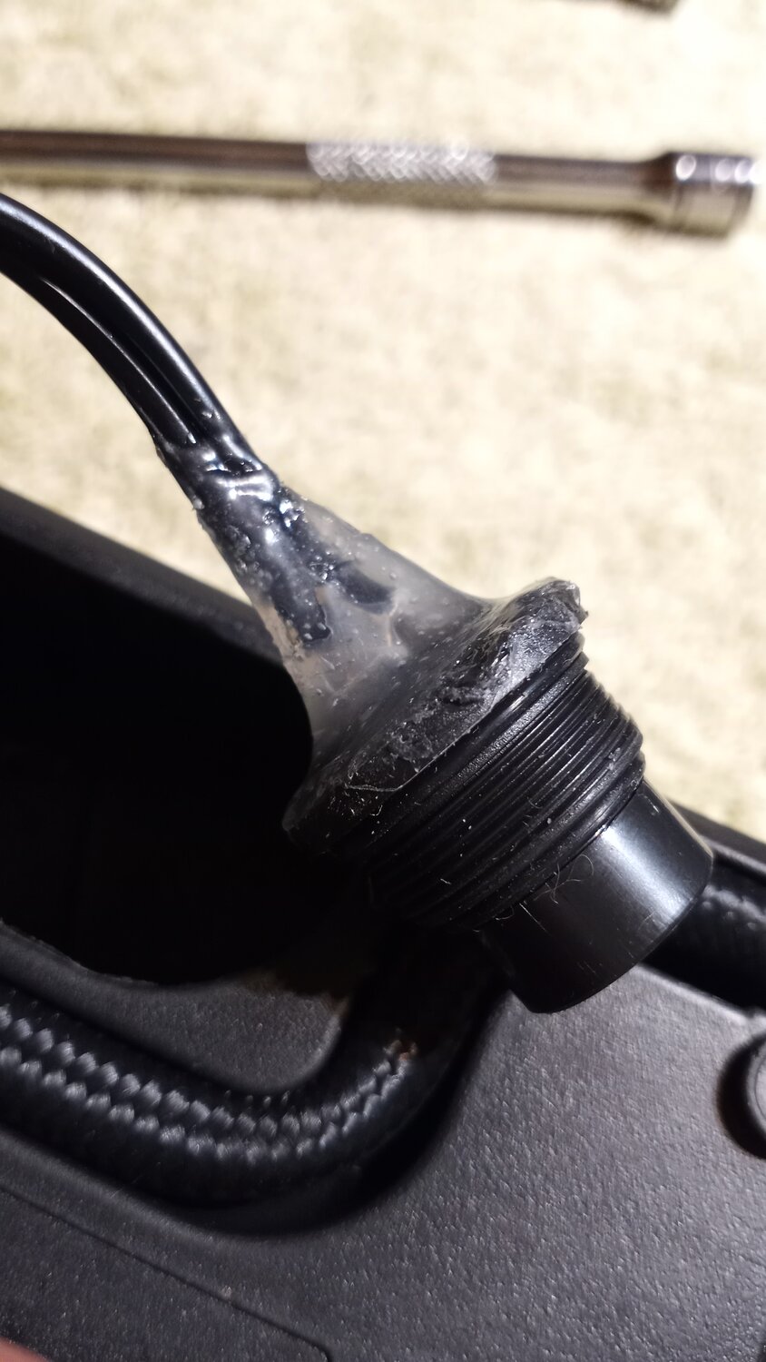

I had a spare connector so I wired it directly to my compressor.
I've got a little mini hand pump as a backup, but it would probably take an hour to pump up a tire.

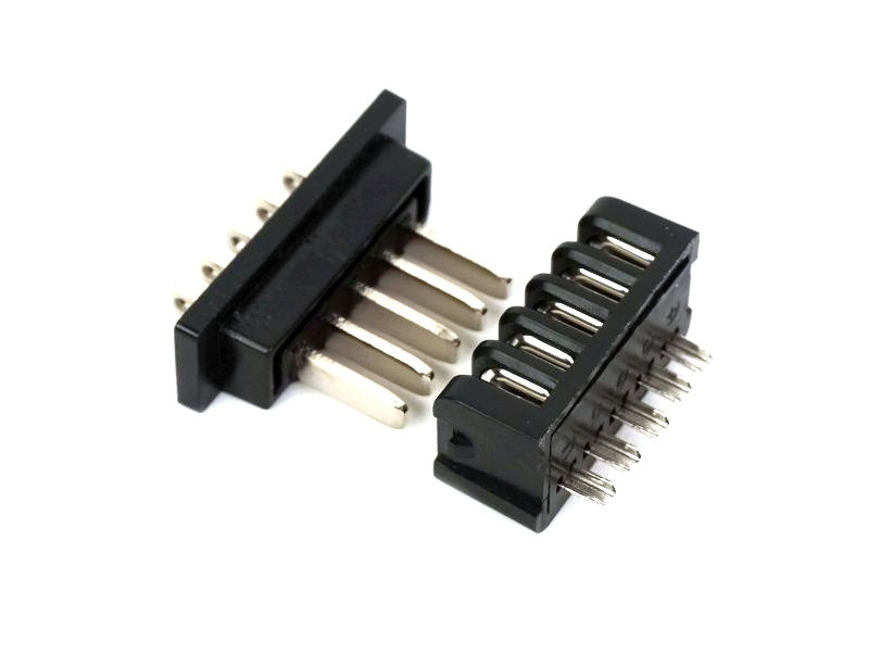

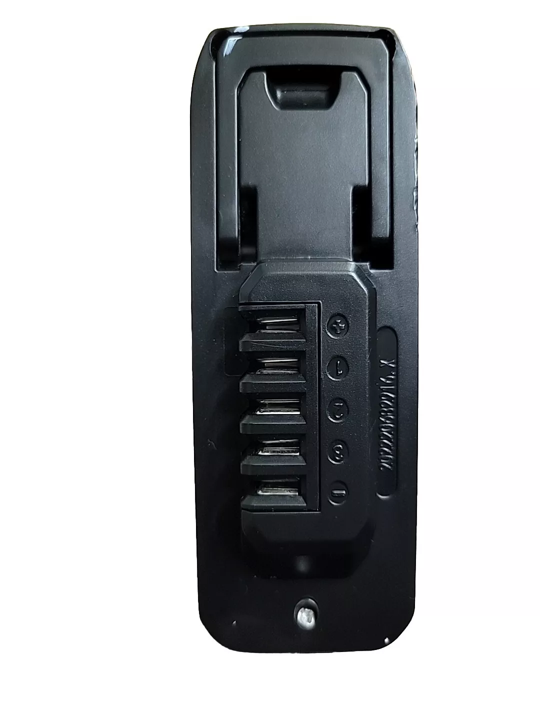

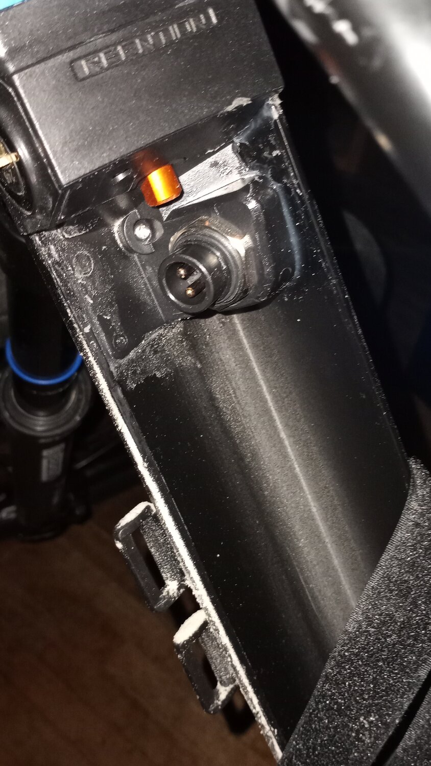

The best way to do this is to remove the battery from the bike when you want to use the pump and wire this 5 pin connector to it:
The two outside pins are + and - , which are clearly marked on the battery.
You will also need to get a pump that will work on 48V.

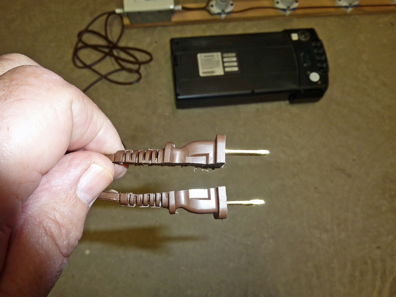

A simpler way to do this is to buy a cheap extension cord, cut the molded plug in half, and wire it to the pump. make sure to observe the correct polarity when plugging it into the battery:
