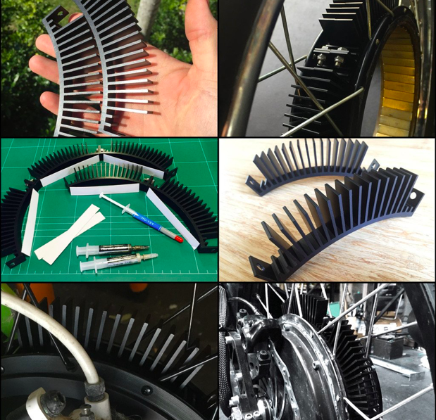

That would indicate geared and not direct drive. The gears are internal to the motor, basically a small direct drive with a set of gears around it. Definitely make no holes. Statorade much less feasable. Light oil fill, or ATF, and/or, heatsinks. Hubsinks (TM) are available for several models that bolt together, also you can cut some aluminum C channel to size, cut some fins in it, and use an epoxy with good thermal transfer. These may help, but with a geared motor not so much. There is no good thermal path from the hot parts to the case. The real answer is pedal more, or put the motor in a smaller wheel. You have too high speed a motor for your application. The heat is because the motor cannot spin as fast as designed, the smaller wheel lets it spin faster and generate less waste heat.

Will try hubsinks, I am doing about 50 percent of the work going up the large hills to my house. After a 30min. Ride I can keep my hand on the wheelhub but its pretty warm, thanks. I also only ride at about 15mph, im in no hurry.
First, that's not hot at all, BUT, the windings inside are a LOT hotter than the outer shell. You really need an internal temperature sensor to have a good idea what is going on inside. Around 180F and above is when bad things start happening.
What is your speed on the hill, and what is top speed on the flats? Rule of thumb, maintain over 50% of top speed while hill climbing, or time to overheat can be from 1-2 up to 5-6 minutes, based mainly on the total mass of the motor.
Whoa, Nelly. Sorry, I re-read your top speed of 33 mph. YOU _ HAVE _ THE _ WRONG _ MOTOR.
Unless your are maintaining around 18 mph on the hill, that will seriously overheat. Need your motor make and model, preferably pics and a currently active link. Also battery voltage. And Wheel size. Those performance numbers point to possibly Direct Drive, where Statorade or ATF and hubsinks may be the best answer.
Hub sinks are available. That and Statoraide will help a lot. BUT a direct drive motor is a poor choice for lots of hills!
https://hubsink.com
