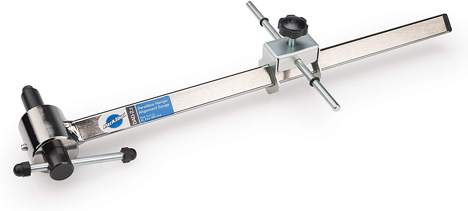

So how does one straighten a derailleur hanger? I thought they were basically pot metal so they would break instead of ruining the derailleur.
The hangers are designed to me more malleable/easy to bend than the frame and derailleur they are attached to, to help limit damage to other components. As such, they are made so they can usually be bent back into the same plane as the cassette. The tool for this screws into the hole where you mount the derailleur. It references the rim of the rear wheel and allows the user to bend the hanger (within reason) to line up with the rim all the way around at one point, usually the valve.

I use this tool from Park:
It makes derailleur adjustment easier and in my case, shift smoother when the hanger is in the correct allignment.
Like all Park tools, it isn't cheap. There are other, less expensive options if you do a search.

I've looked at those. What happens if rim is not true?

No, I just got it and there’s no rush with below freezing temps and lots of snow. The bike isn’t shifting smoothly in all gears, and I suspect the hanger got bent when I destroyed the original derailleur with a stick on a trail some time ago. Park has a good video on how to use it.

Great tool... here is the video from Park Tool.
Rear Derailleur Hanger Alignment | Park Tool
The rim needs to be true for an accurate adjustment. If it isn't, that's a separate problem that should be addressed. A rim that is out of true should be obvious if you give it a spin. You can always put the front rim on the rear for adjustment purposes.
