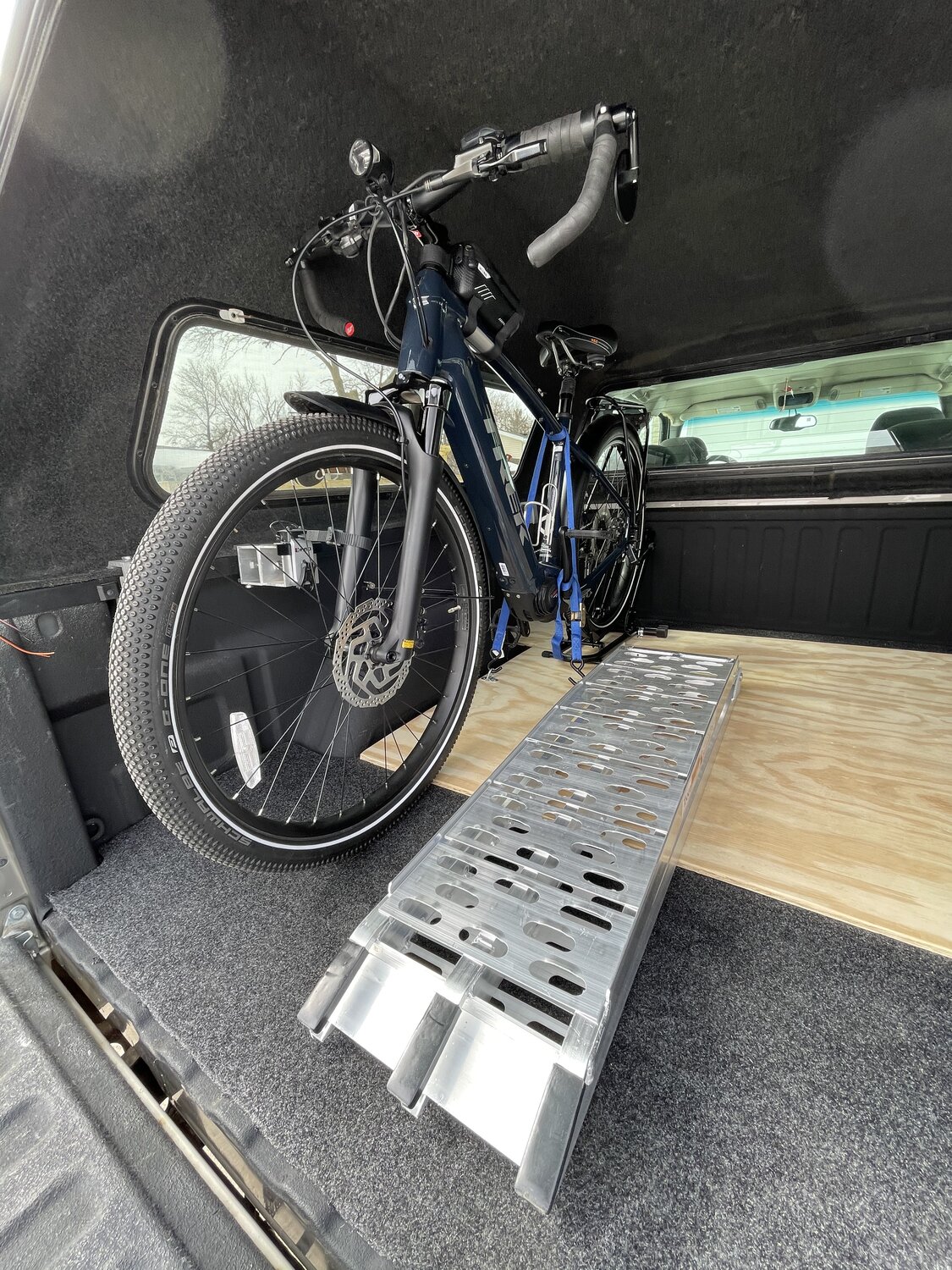

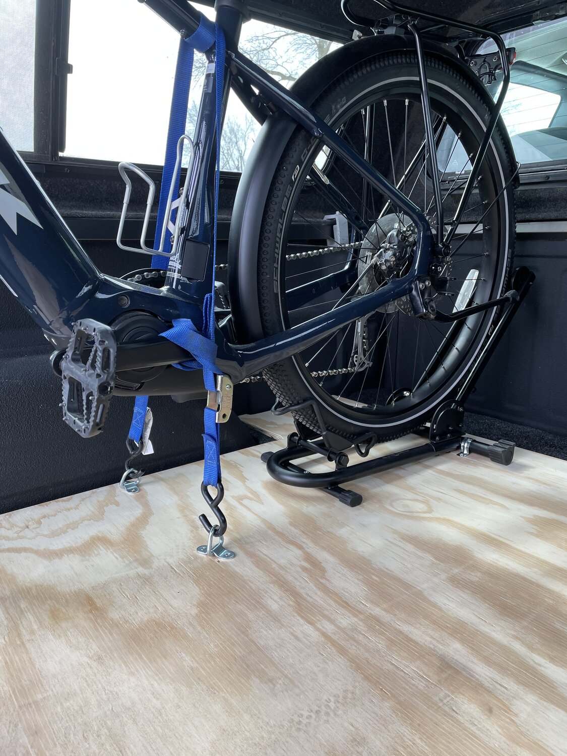

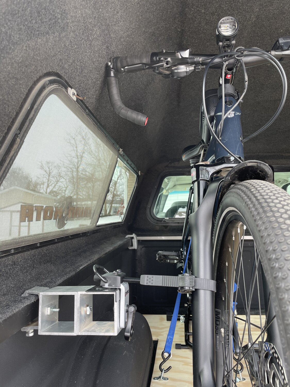

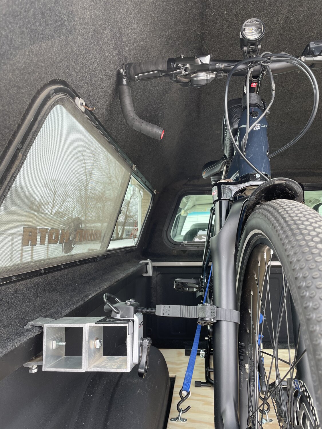

So took the UnderTopper system on a 400 mile trip and it’s very easy to load/connect and is totally solid! now I just need to update the truck w/new tires, shocks, etc., and it’s cross-country time! Anyone got a proven/cheap way to make a 5.3 Silverado get 30 mpg?
That's a great setup you made!

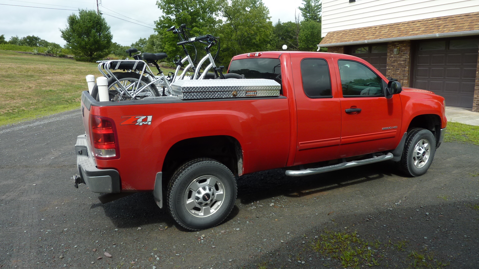

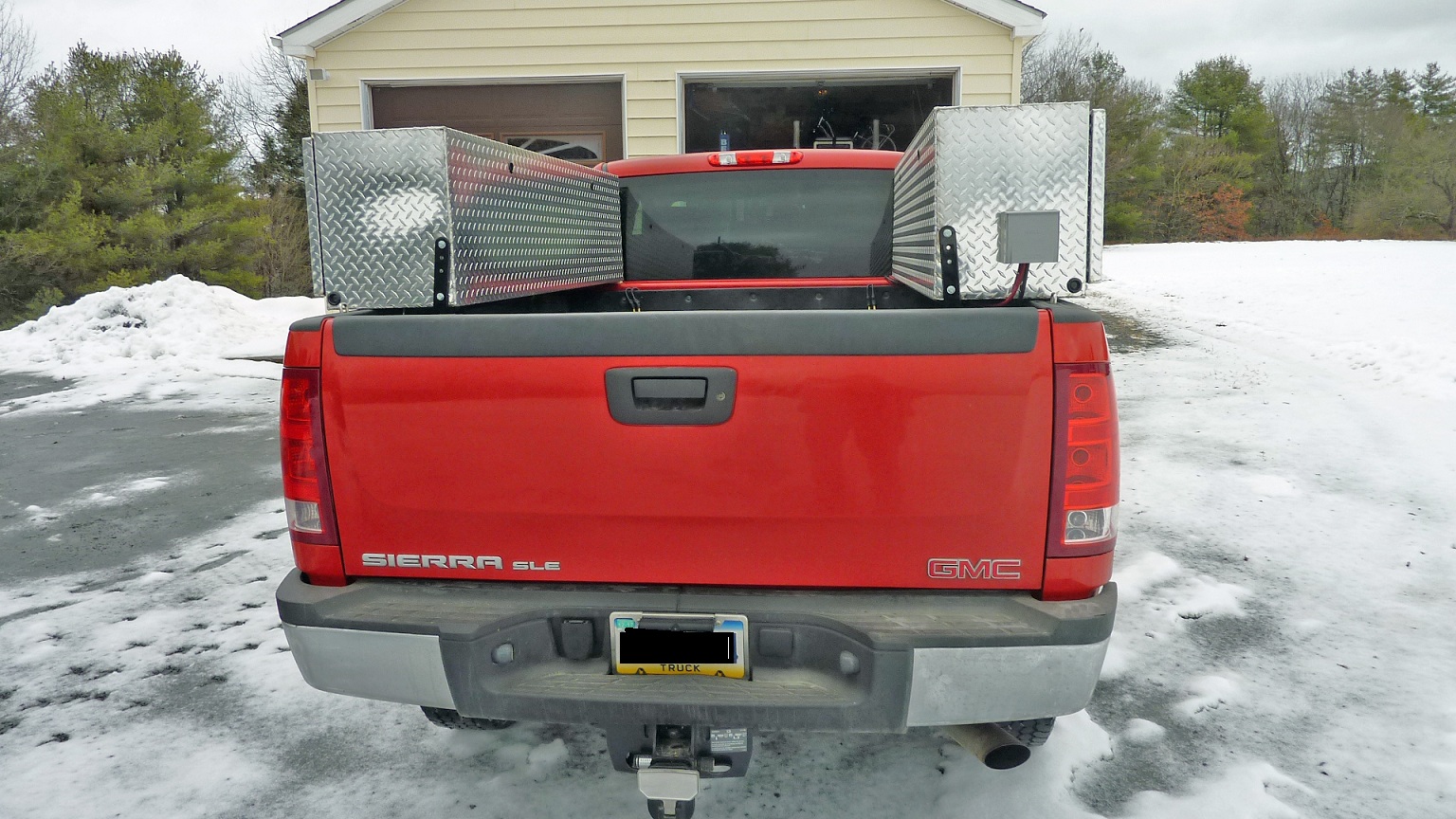

I wish I could do something similar with my GMC Sierra which is pretty much equivalent to your Silverado. With the stem riser on my bike, I couldn't locate a topper high enough to clear the bars.
Instead, I replaced my low side tool boxes with full the rise type. The bars still extend above the top of the boxes but I'm looking into a soft top of some sort.
The high side boxes also offer more than twice the storage space. They allow me to better organize, and have easy access to my riding gear.

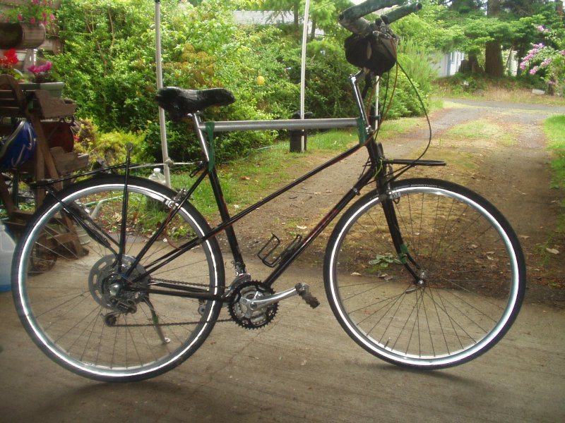

I´ve decided to turn this into an ebike. It´s an ´84 Univega mixte, tange pro tubing. The frameset weighs
just 3 1/2 pds. The top tube is a piece of alu sail spar added to support my inframe pannier, but also
adds structural support. I put a 700 wheel in back which barely clears the brake mount. I have a 48v 1000w
28¨ x 1.75¨ motored wheel, but the most that will clear is 1.50¨. This means I have to cut the upper stay
spreader & mount a new one 3/8¨ higher or I could put a 1. 50 on the wheel which may not be enough
for the extra weight. I have everything else for the kit, & a choice of 13ah or 8ah batteries to mount under
the dbl. tubes. I originally used the wheel to replace the one on the CCS motor with damaged spoke bores.
(now a parts bike). It is a much better whl will 12g spokes. The conversion kit is meant to turn a road bike
into a 40 pd., 40 mph bike. With the 8ah bat., I think I can bring it in a 35 pd. The the 8ah charges in 2 hrs.
I bought this bike pristine on CL for $60 from someone without a clue what it was, a race-bilt at 22 pds.
(tacoed the original whls)🙄.

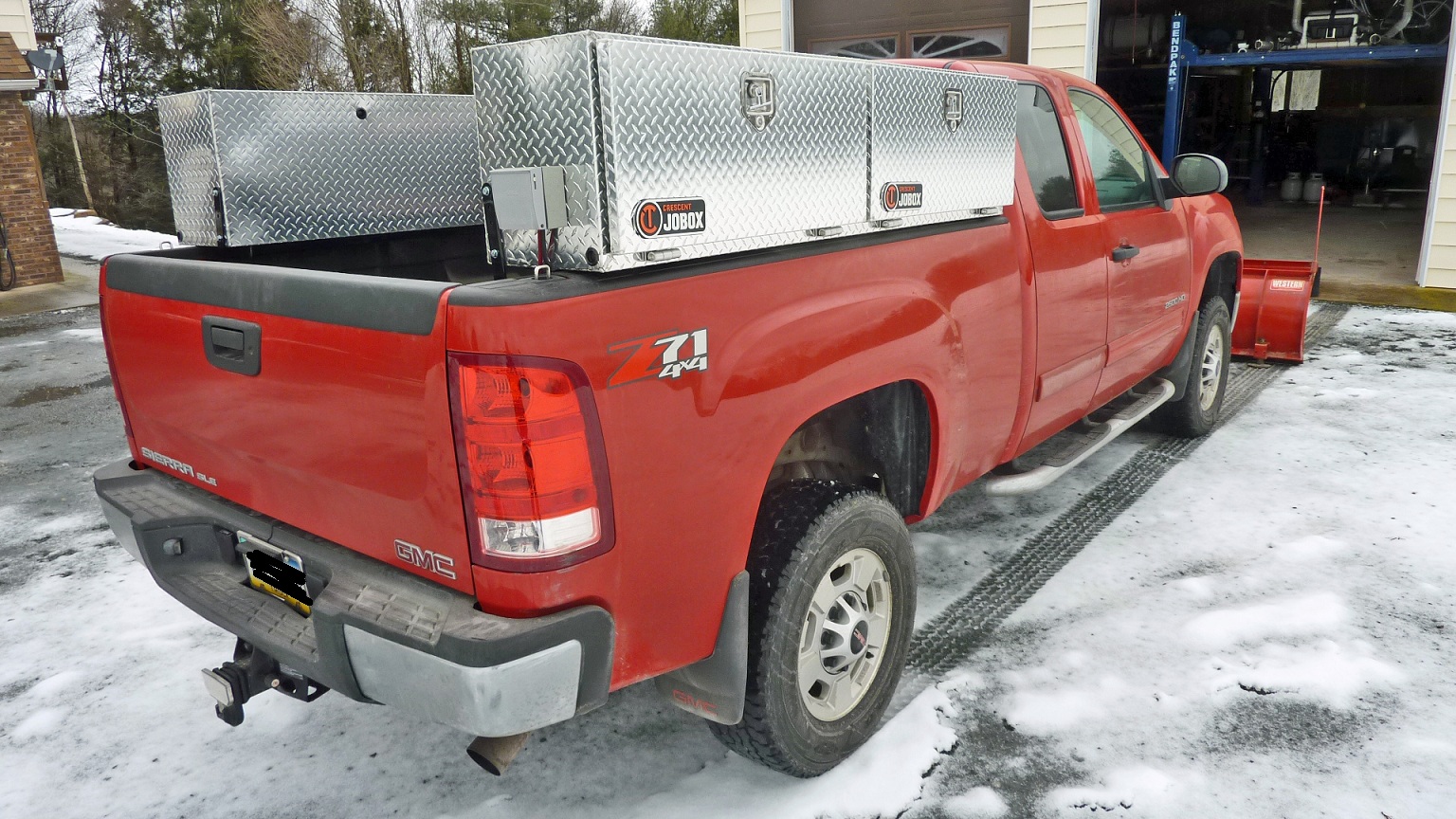

View attachment 80337 View attachment 80338 View attachment 80336 View attachment 80335

Yup. Ran into some snags, but shouldn´t be too hard to fix. I can move brake down to middle stays
& use a 700/38 instead of cutting the spreader. That gains the 3/8¨ I need. Front & rear derailleurs are
shot, I have a new rear. Can´t find a triple the will fit the skinny down tube, so going back to a 50/34 compact.
I need to ditch the disc on the motor wheel to get a fit, also racks to keep down weight. A better brake set
would be nice. If I didn´t have horizontal dropouts, I could a 700/47 on. Should end up with an ebike I can
load on a bus rack no sweat.

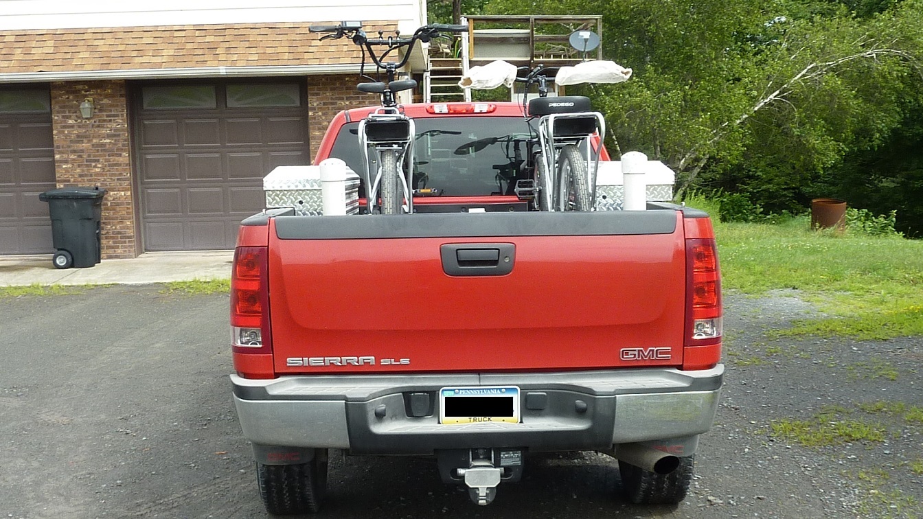

I finished my second winter project just in time to take advantage of the warm early spring weather. The first project was to replace the low side truck storage boxes with the full size version which was shown in post #46. The second project was to add an electric winch to the slide out bike rack to make it easier to load.
I added a boat trailer winch to an unused storage container mounted on the rack. I put the winch on the rack instead of mounting it in the truck. That way, the truck bed is completely empty when the rack is removed.
Now, I walk behind the rack and guide it while operating the controls as the winch pulls the rack into the bed. No lifting or pushing is required.
