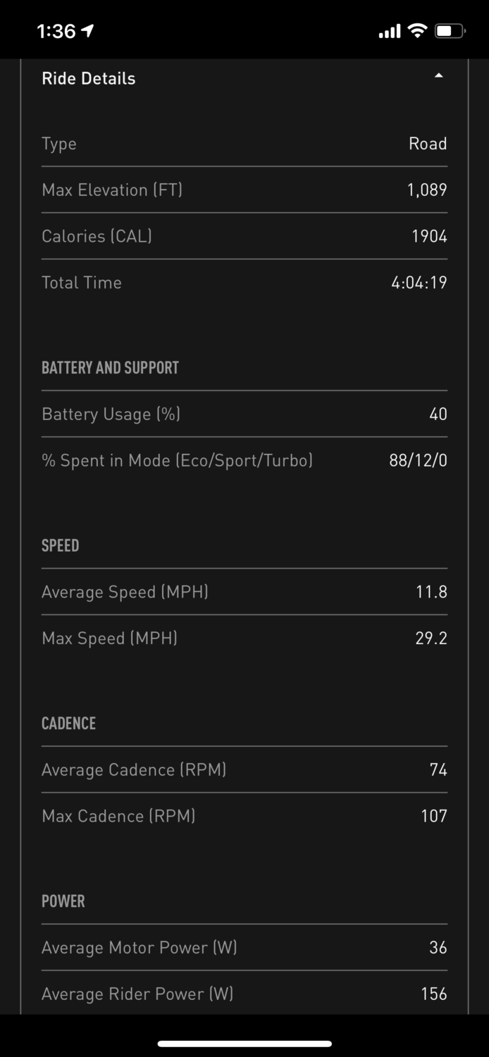

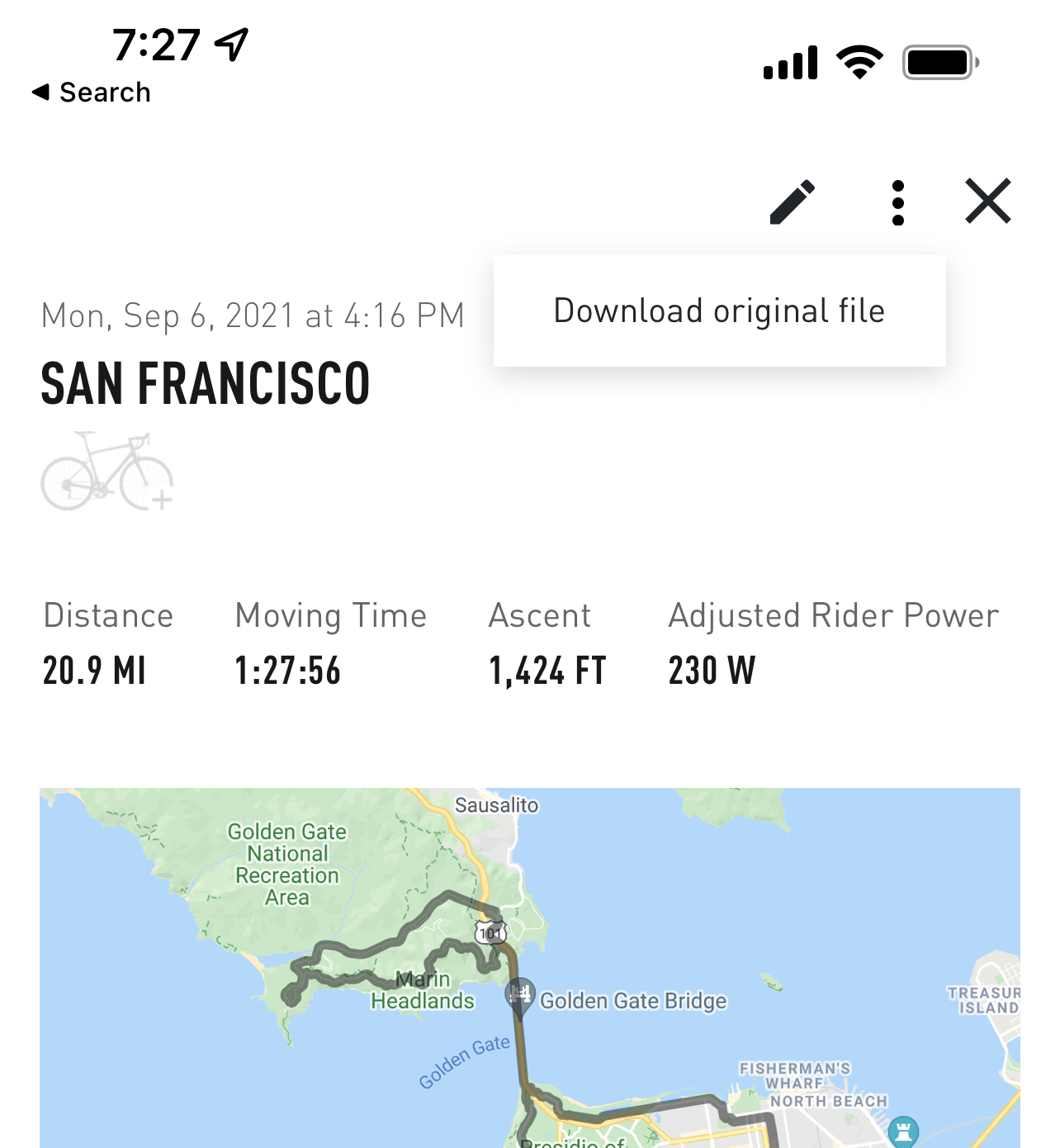

I might have missed it. Where's the EXPORT option in RIDE?

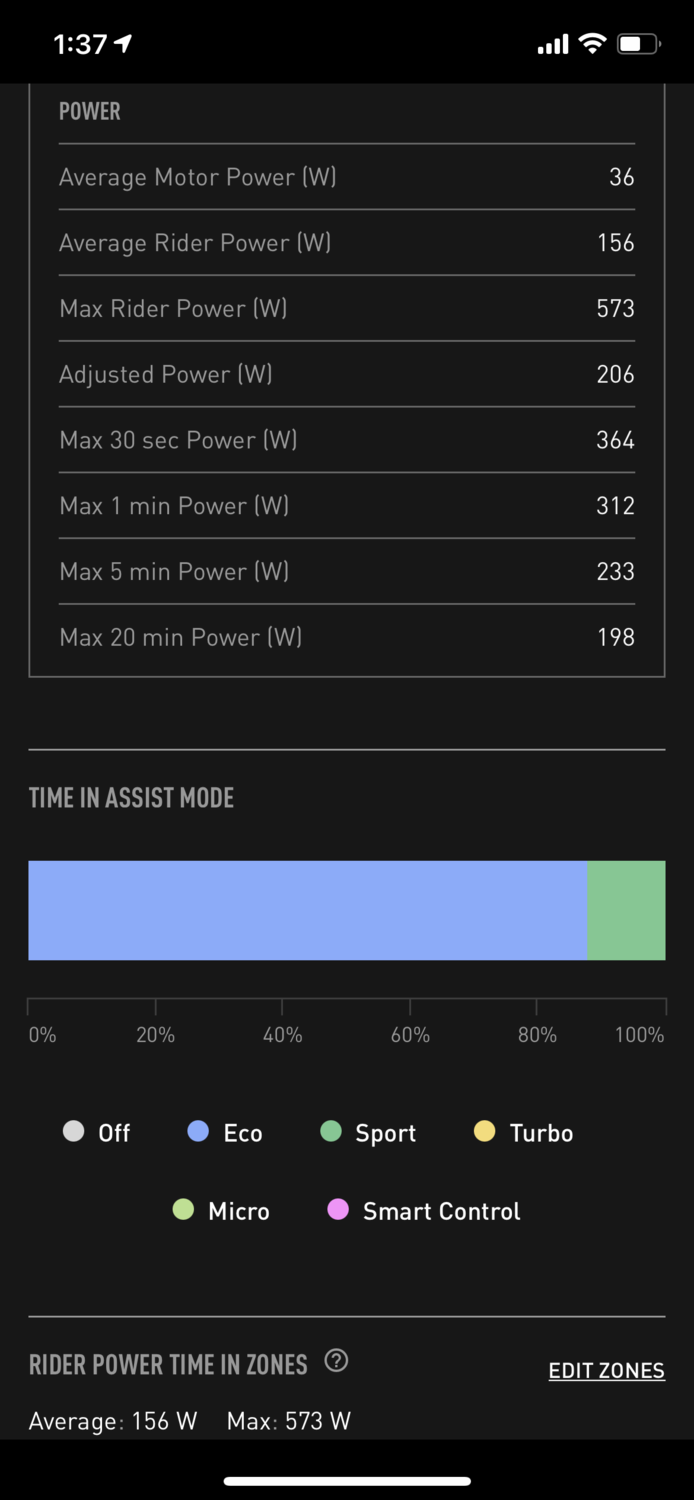

I’m not sure why but sometimes RIDE includes all the motor and rider power data and sometimes it doesn’t. When is does there seems to be a wealth of k formation regarding e-bike parameters so I think the app is useful for e bike rides as well as acoustic. Often it seems to record two versions of a ride, one with and one without the additional data. Glitchy
