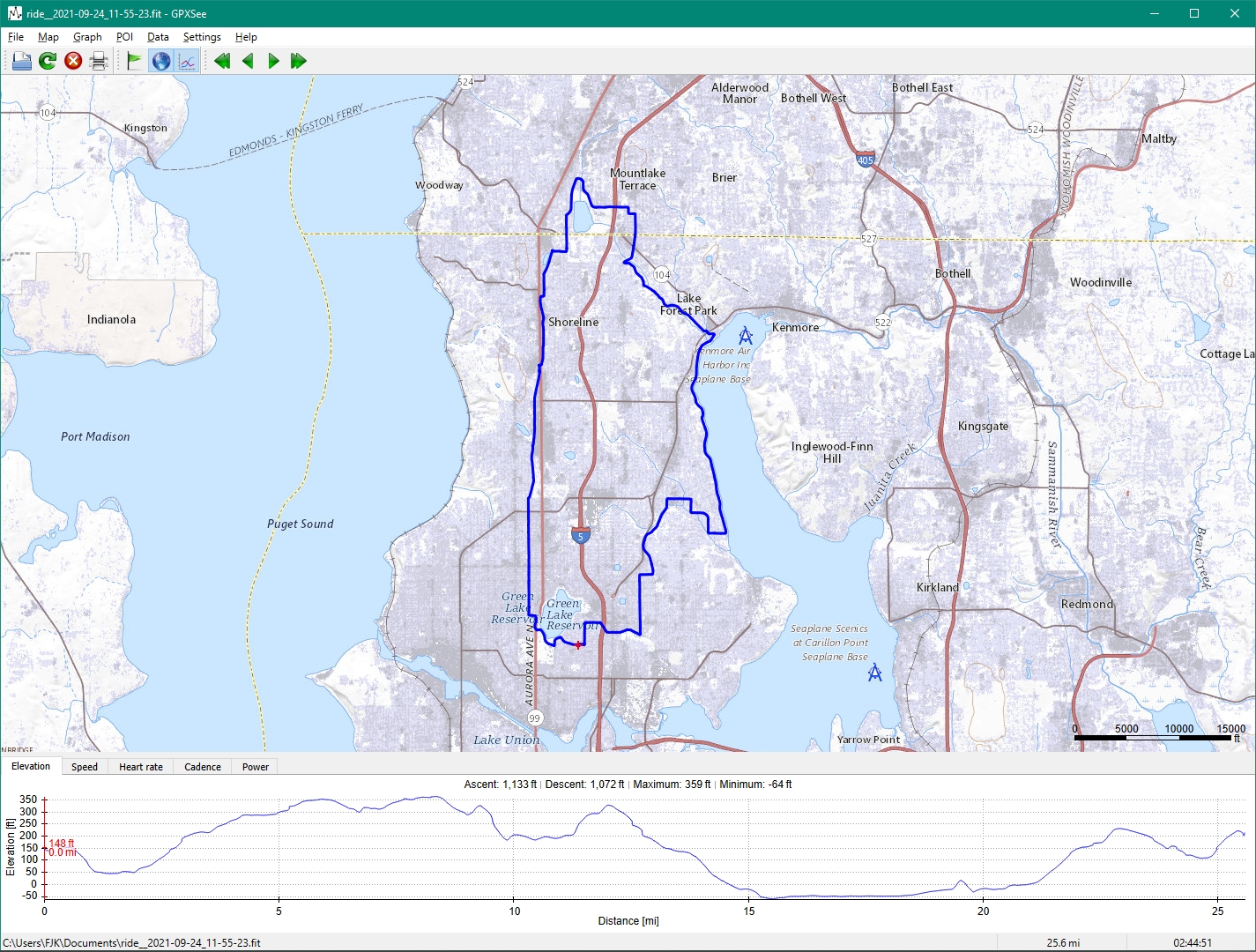

Yesterday's 26 mile loop. About 1,100 feet of gain. Used 63% of the battery.

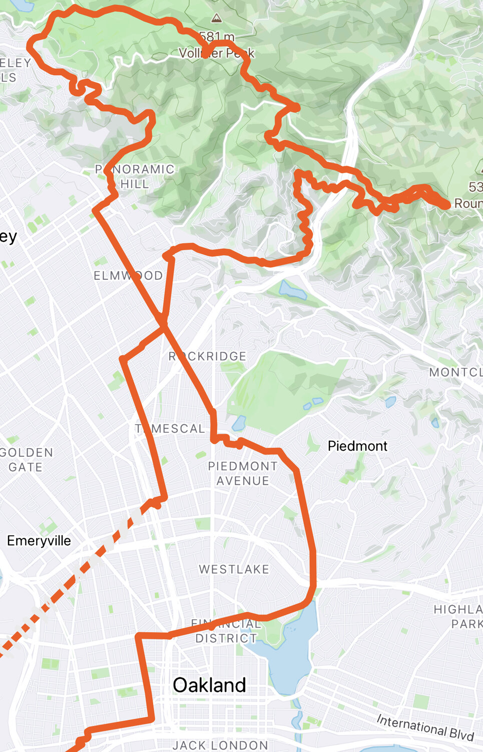

Yesterday I did a ride in the Berkeley, CA hills that included an "infamous" climb. It's a road in Tilden Park called South Park Drive. Here's a description:
"South Park Dr gains 730′ in 1.4 miles up to Grizzly Peak Blvd; it’s a steep stair step climb! The first section begins with grades of 6-8%, at Big Springs the road tilts up a bit more with grades of 10-14%. It eases up for a short stretch around Laurel and jumps back up again to 11-13% grades around Owl. The road continues with steeper grades of 13-15% all the way up to the gate at Grizzly Peak. The climb up this quiet road with minimal traffic is a slug fest!"
My whole ride was 9 miles, 54 minutes, 1,269' elevation gained, 167.00wh consumption, 221.84% support level. Of course I was at 100% for most of South Park Drive, and in the lowest gear. What I learned from this ride is that I can do almost any climb on this bike, and that's good news to me. My previous bike with the huge battery and the Bafang BBS02 motor made a climb like this look easy. While I was working my tail off doing this on the Vado, I was pleased that I could do it at all, given how much less power it has compared to the Bafang. Bottom line: I love my new Vado SL 5.0!
By the way, I tried Stefan's Mission Control Profile--35/70, 70/85, 100/100--and it worked very well. With that Sport setting I rarely needed Turbo (except S Park Drive, of course).

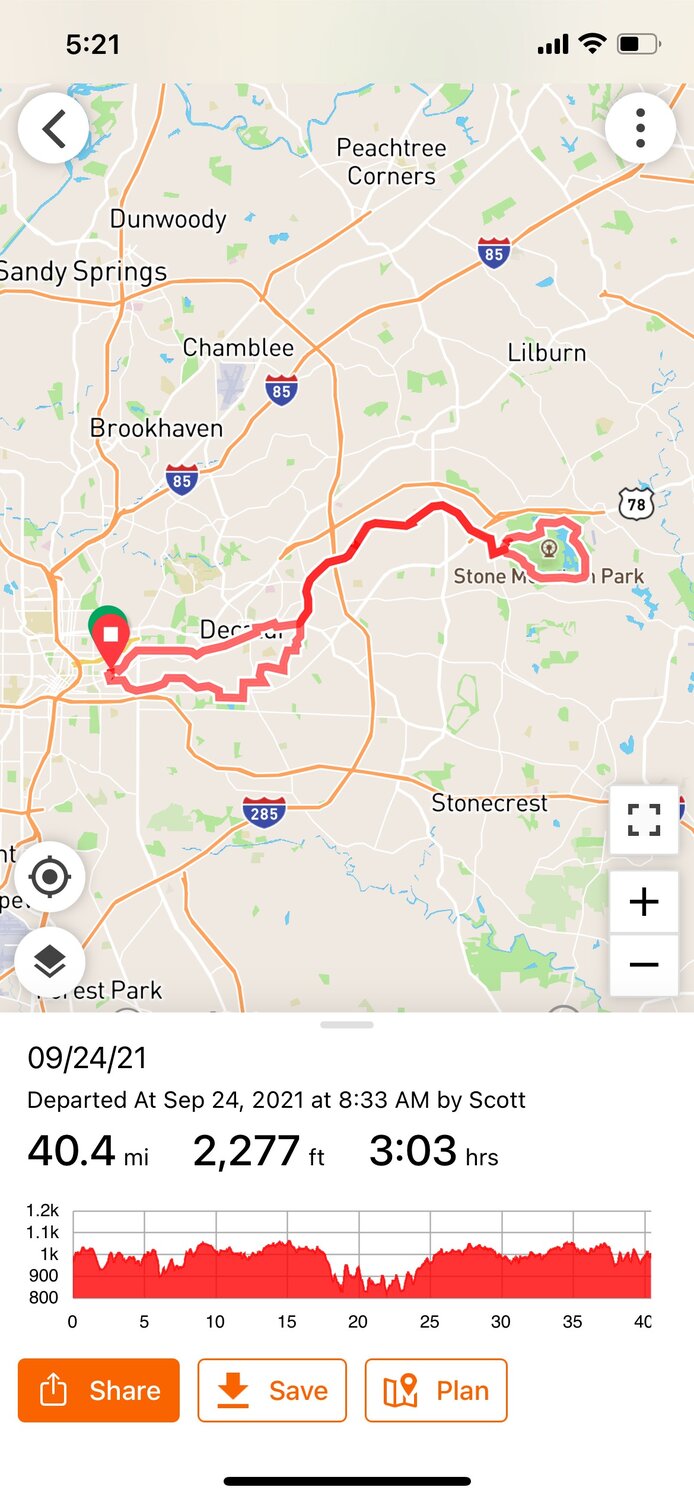

I am not as technical as some but have had good results with a 5.0 SL gradually lowering the assist levels using the Mission Control App. Stephan is an expert here but the net result for me, as I have slowly become a bit stronger is no range anxiety thanks to less demand on the battery. Most recent ride was 40 miles, 2277 ft of climbing and 133 watt/Hrs used or about 1/3 of the battery capacity. It was a hard ride and I was tired and sore next day but with the lower settings in Mission Control I had plenty of headroom and could have asked for more from the bike if I couldn't continue to contribute as much. I love this bike because it allows me to set the parameters and as a result I am getting a little stronger. Im a bit lighter but not the strongest rider and well into the Medicare years. I think as you continue and with some experimentation using Mission Control you can make your ride and save the $450.

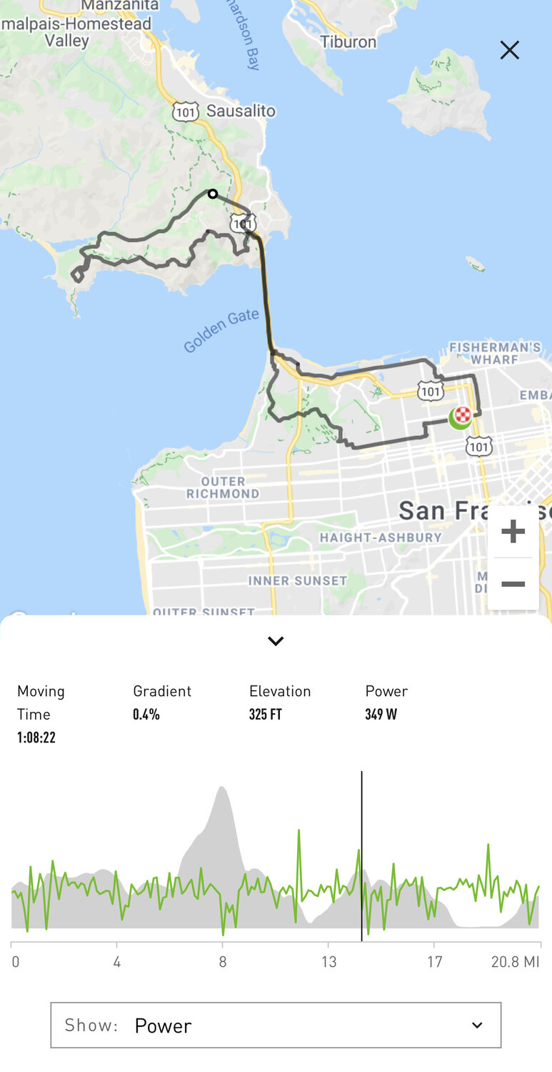

I'm curious about one of the images you attached. I recognize the RideWithGPS image, but I'm wondering if the other one that says "Analyze Ride" is from Mission Control. I ask because "My Rides" in my Mission Control looks different and doesn't show % spent in each mode, which I would find very useful.

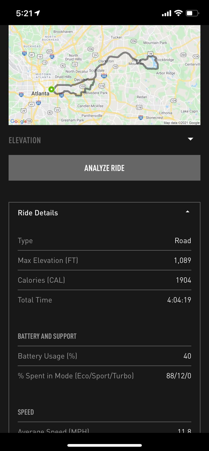

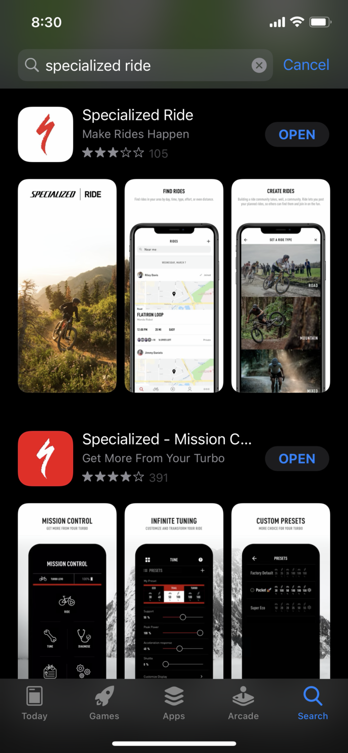

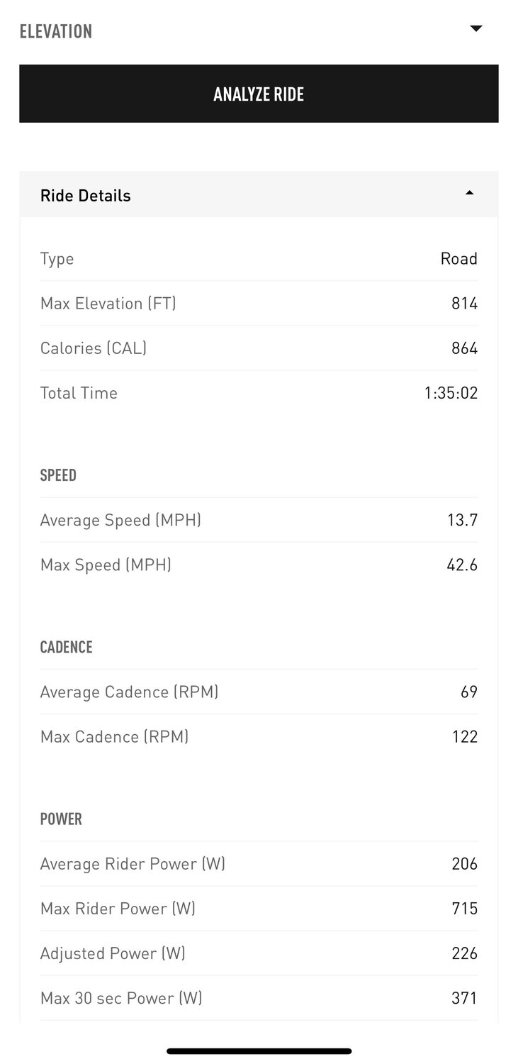

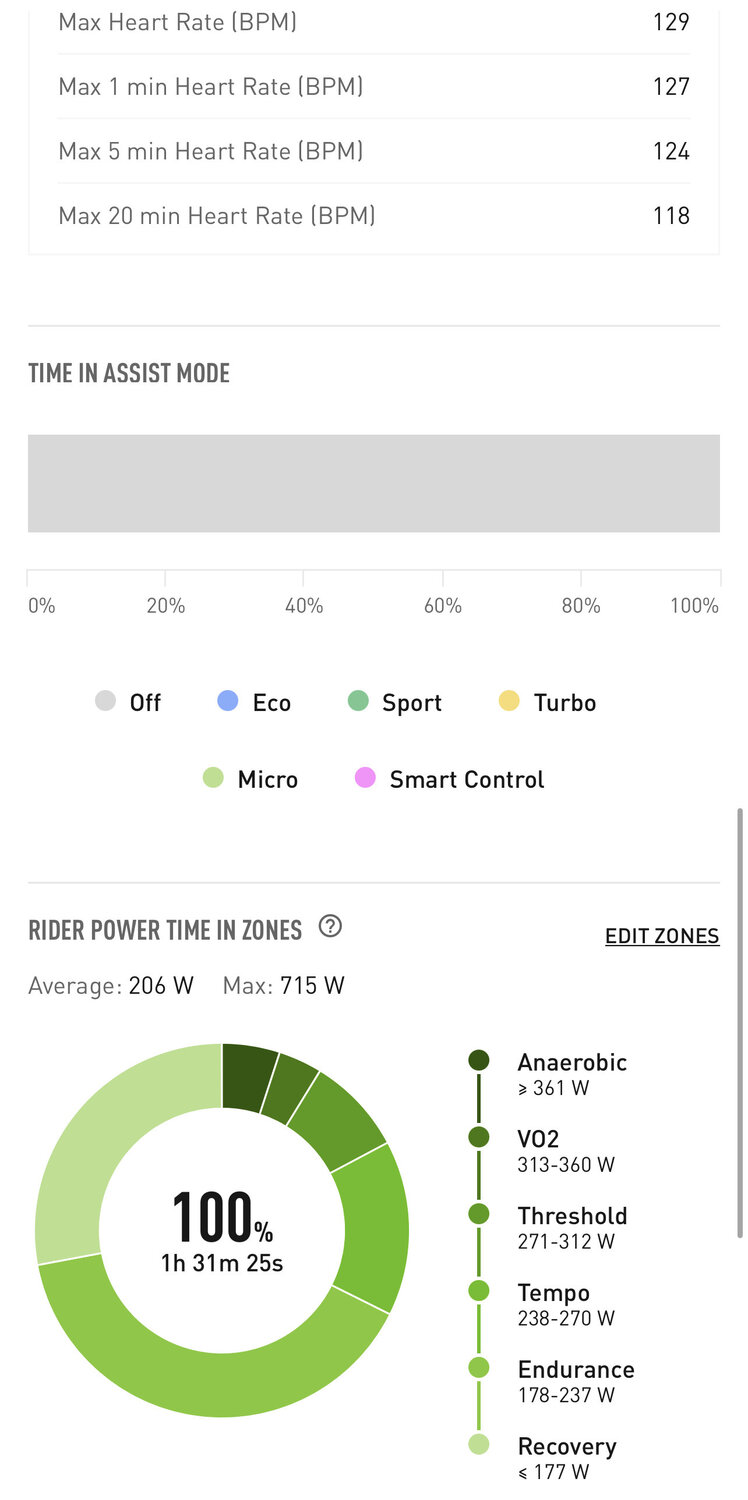

Hi John it’s a Specialized app called RIDE. I can’t remember how I found it but it’s available on the App Store and it does provide some additional information that Mission Control doesn’t. I take it all with a grain of salt but I have enjoyed the extra info about power and battery usage.

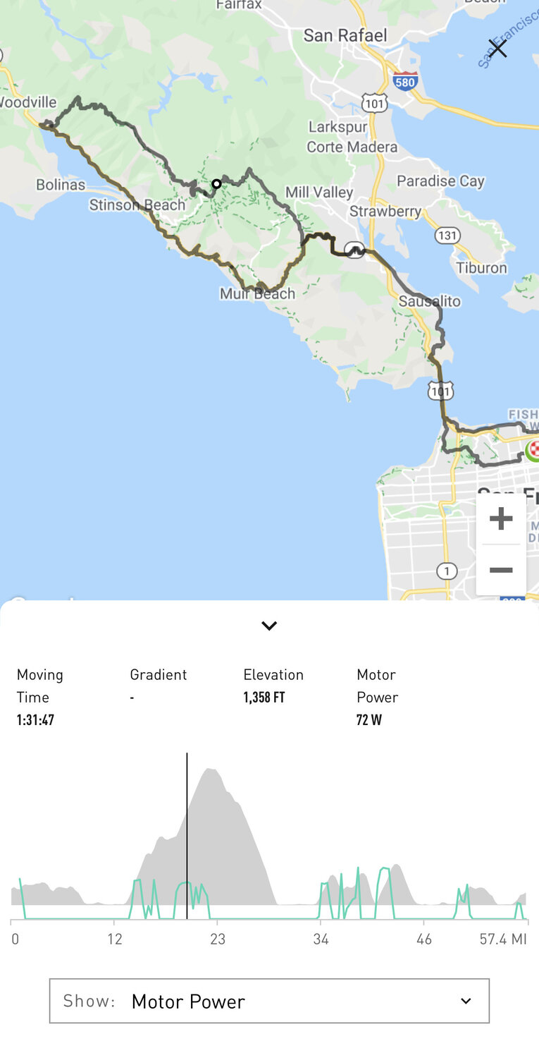

OMG! how did i not know about this app!?!? it's actually got really great metrics - motor power stats, time in various modes, rider power zones, weighted averages! the time spent in various modes is really cool, as is the motor power graph. i've always wanted that data.
Thanks, Scott. I'll download RIDE. Do you know if you can run it, Mission Control and RideWithGPS all at the same time?
bluetooth devices typically can’t connect to more than one other device, so i doubt you can connect to the bike in both mission and ride. however, rideWithGPS doesn’t connect to the bike with bluetooth, it only uses GPS, so you can run it (and strava and whatever else you want) that doesn’t read the bike sensors directly.

I ride thru Mt Tam with 6000 elevation and cover 65 miles. It is supercharger2 with 2X500Wh batteries.
nice bike! ... but a totally different beast than the Vado SL, at twice the weight and 3x the battery capacity ;)
mt tam is a great ride though, i like the loop from the bridge to fairfax, fairfax-bolinas road, ridgecrest, then up to the summit. and panoramic back down towards sausalito. 63 miles and a little over 5,000 feet of climbing from SF. stunning ride.
