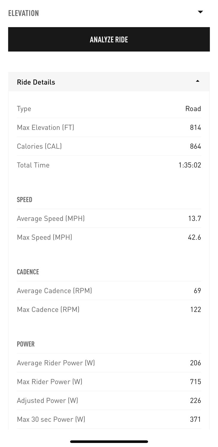

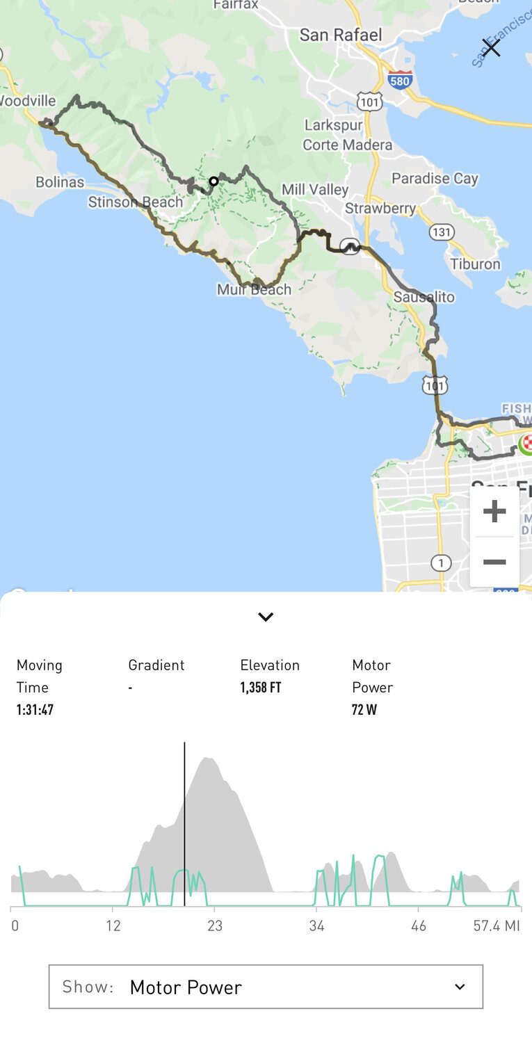

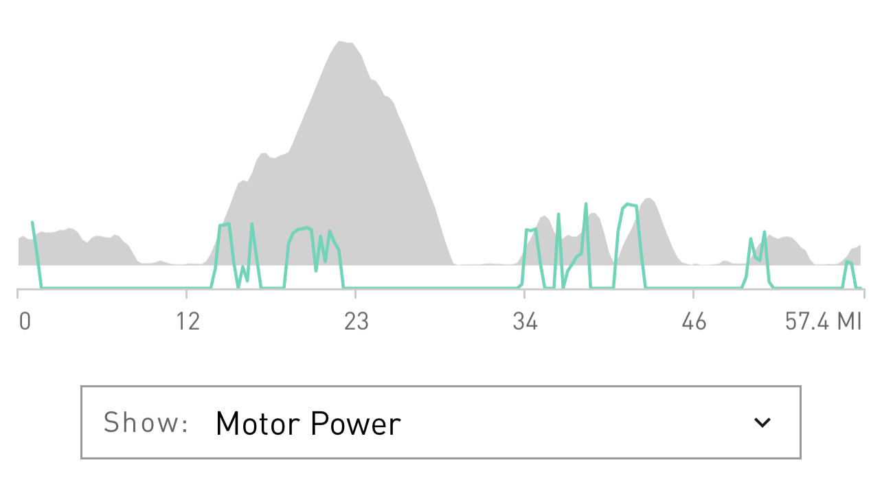

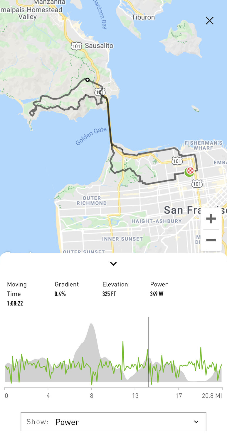

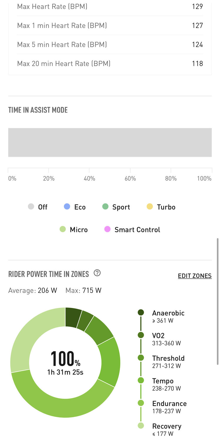

OMG! how did i not know about this app!?!? it's actually got really great metrics - motor power stats, time in various modes, rider power zones, weighted averages! the time spent in various modes is really cool, as is the motor power graph. i've always wanted that data.
View attachment 101243 View attachment 101251 View attachment 101245 View attachment 101246
