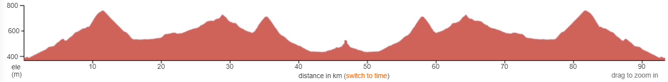

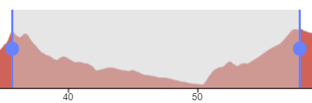

Have you guys used Smart Control in Mission Control? I was thinking of trying that, using Distance and setting Ride Length at ~15 miles, Elevation at 3,900', Remaining Battery at ~8%. I'm not sure about where to set Climb Response--maybe at 30'. Any thoughts?
I was using Smart Control for some time on my full power Vado to find the feature useful on the flats. My attempt to use SC in a really hilly area led to such unpredictable results I got scared to not to be able to complete my group ride (and switched the SC off); so I have never got enough experience with Smart Control. My feeling is Smart Control initially offers very little of assistance to be on the safe side.
Think of this: Smart Control knows nothing on the elevation profile ahead.
You might be descending for the most of your riding distance to be confronted with a dramatic climb towards the end of your ride, or
You may need to climb at the beginning of your ride and descend without pedalling after passing the summit, or
You might need to do as many as 7 serious climbs on your trip.
How Smart Control could handle all of these scenarios remains a mystery to me. So I believe in manual control of Assist Modes and even adjusting them during the ride.

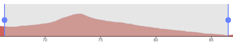

My front wheel motor bike had tackled a very substantial one mile cliff a few times but it was challenging for the bike and me. The LAST time I did it, the motor completely cut out about a block from the top. I was lucky as suddenly the bike was teetering and I managed to disengage from the spd pedals and land on my feet. For a moment I was aghast - had I killed my electric bike/motor. I dismounted and rolled the bike to the top. I pressed the power button and it came back to life. RELIEF. The other thing which makes that hill, well, interesting is that with the front wheel's motor-weight, the front end on such a hill is quite squirrelly. And trying to maintain a straight line is harder - it is like the gyroscopic forces want to keep the wheel moving to the side if it sways that way. I have to work to get it back in line and keep it that way. You also have to maintain a certain forward speed to keep the bike in balance, too.
But while my friend wants to do that hill again and has, I await at its top. I see no reason to challenge my bike's decision! o_O
A friend's guesstimate: "Maximum grade 11% on the climb up from the beach" based on what I was able to provide. I guess that does not sound that steep according to some of the numbers people have posted. But since that bike's motor/system seems more powerful than my Creo, I have not even attempted it.
