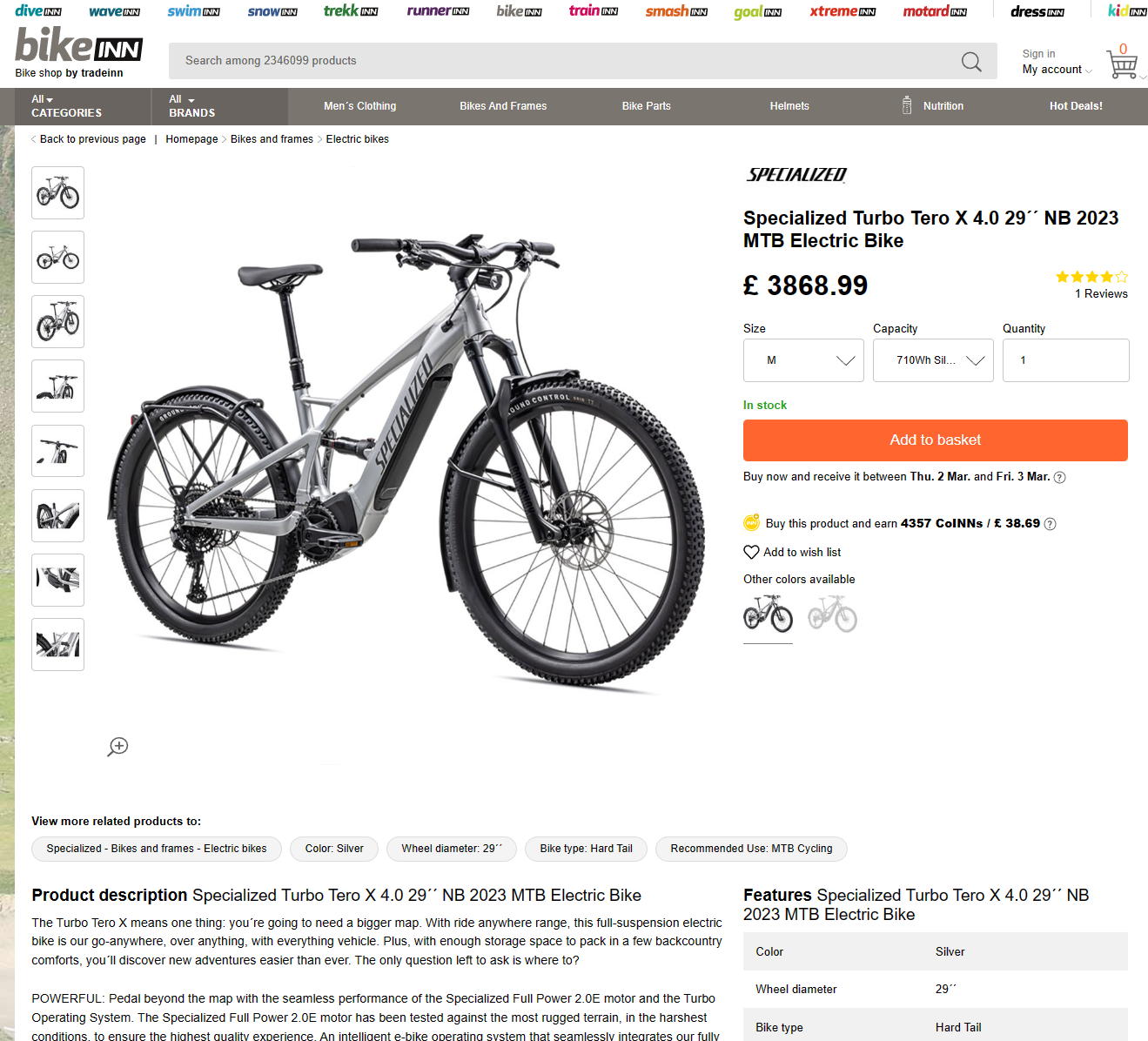

Just found this on one of the european sites (deals from Spain) - was this already mentioned in another post? I can't remember. Looks like the tero x is the purer eMTB breed than the cross-breed the tero started out as.

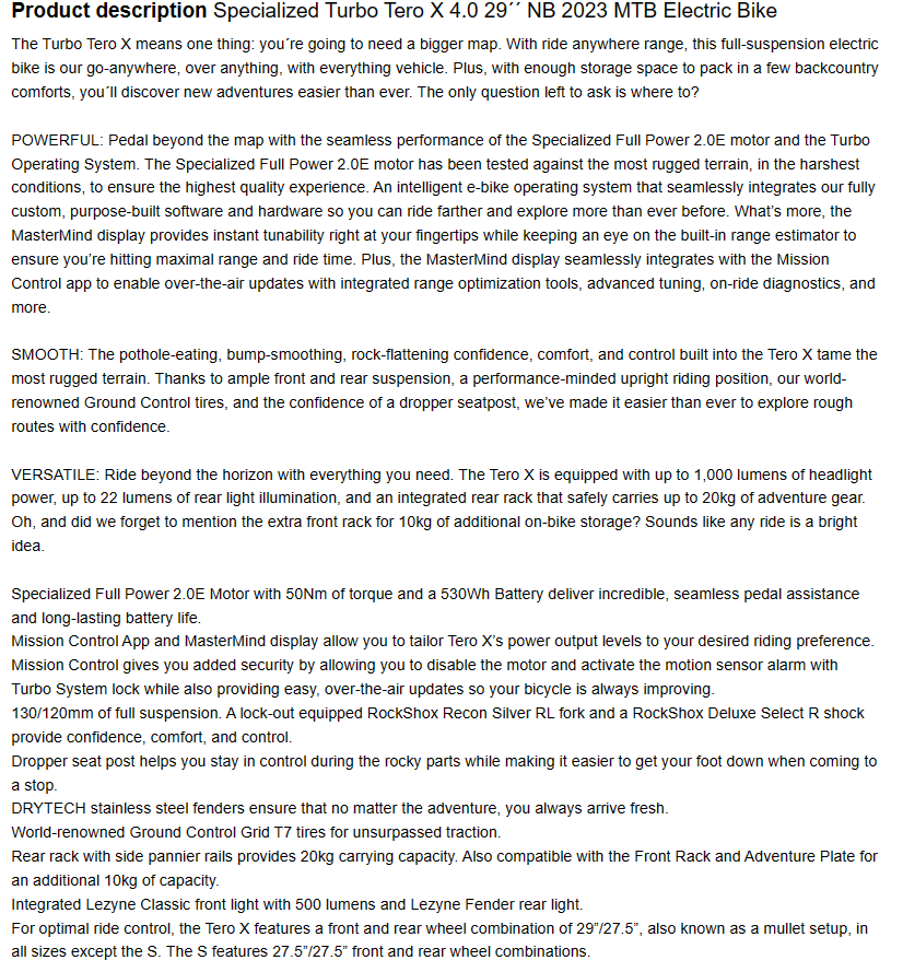

From what i can see in the bike.inn page for the tero X 4.0 (lowest spec) - this is the marketing blurb

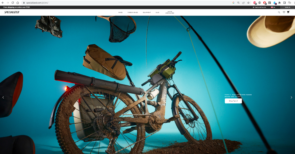

Read my post #74. Specialized.com page for Poland lists 3 models of Tero X with specs in English. The UK site shall be updated soon. Or, maybe not.

@Stefan Mikes yes, i tried following that link on post #74 but the next click wasn't working for me - so i couldn't get past the landing page from that link. Exciting times.

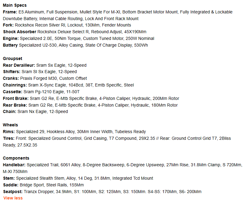

Good idea, but as a self-appointed Tero beta tester I have this input:
1. The motor would be perfectly adequate but range would be limited to less than 30 miles in hilly terrain with this battery. I get about 30 miles in my area with a 710wh battery without being concerned about making it up the hills to get home (using Eco as much as possible and Off down grades/hills). This battery has 25% less capacity. So “you’re gong to need a bigger map” might apply to the Levo SL but not much else.
Engine: Specialized 2.0E, 50Nm Torque, Custom Tuned Motor, 250W Nominal
Battery Specialized U2-530, Alloy Casing, State Of Charge Display, 530Wh
2. With that cassette and a 29” rear wheel, a 44T chainring gives very nearly the same ratios as the current Tero. Since this is a mullet it could use a 46 or even 48T (havent checked in with bikecalc.com yet). But as designed (38T), this is still going to be a mid 20’s mph bike.
Groupset
Rear Derailleur:
Sram Sx Eagle, 12-Speed
Chainrings: Sram X-Sync Eagle, 104Bcd, 38T, Emtb Specific, Steel
Cassette: Sram Pg-1210 Eagle, 11-50T
3. Why a mullet? This bike isn’t going to appeal to the shredding downhill market anyway and a smaller rear wheel has more downsides than benefits for an XC (bigger map) bike.
Wheels
Rims:
Specialized 29, Hookless Alloy, 30Mm Inner Width, Tubeless Ready
Tires: Front: Specialized Ground Control, Grid Casing, T7 Compound, 29X2.35 // Rear: Ground Control Grid T7, 2Bliss Ready, 27.5X2.35
4. Rack for panniers but no horizontal mounting surface?
There have been plenty of times I felt rear suspension would be beneficial but as spec’d this bike isn’t going any further and only a little faster than a Levo, so I don’t see the benefit here. All that said, I’m sure it will sell.

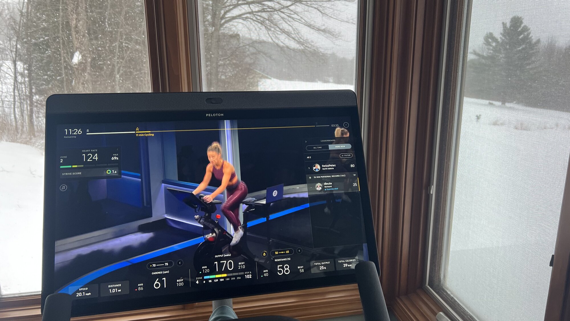

Ignorance is bliss. Here is a picture of my 15 minute hill climb hiit ride this morning. Where I did roughly the equivalent of 2-3 multiple large hills around my house in a 15 minute period. Just *getting ready* to ride in what you see outside my window would take longer than that. IT would take 30-45 minutes to accomplish this on a real bike. On top of that, the comfort of the peloton is far greater than any of the real bikes I have used thus far. So my 45 minute rides on it (which is equivalent to a typical outdoor ride for me) create no numbness and no other discomfort (besides fatigue). And *this* morning, 15 minutes is all I had for biking before I had to drop off a car for inspection (I was actually late with only that much time spent).
Do I prefer to go on a ride through a fall canopy of leaves falling in rays of sun on a dirt backroad during which I stop at a local distillery (on said dirt road) with my wife and have a maple cider? Yes, Yes I do. That ride is accessible to me maybe 2-3 times per year if I am lucky. No more.
Peloton is far more engaging and fun than *any* other indoor cardio activity I have tried (and I have owned them all, including your "trainer" option, ellipticals, treadmills, jump rope... etc. I have a soft place in my heart for jump rope and do it for warmup every morning). The peloton is most closely related to a home version of a spin class. Except, I get to pick music, ride style and goals from many thousands of classes available. And it costs less than any of the e-bikes I have tried or owned.
I did this ride this morning after I did a 4:30am weight lifting training session ( I do some kind of lifting every weekday). Peloton made it possible to do both.
So, for someone who *isn't* closed minded about indoor bicycles, it is a real and engaging option. And, if the difference is doing peloton, or not doing biking, guess which one I pick every single time?
So, really, stop giving a great tool a bad name because you have never experienced it. Is it for everyone? no. Can it be valuable to lots of people, yes. I am one of those people. So far, it has far more value than any of the bikes I have tried.
