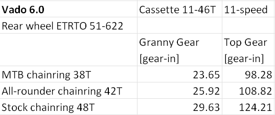

Tero X is very close to the proper MTB gearing ratio: It is 21 gear-inches (or 0.76 gear ratio) in the granny gear based on the rear wheel size. A full blown mountain bike has the granny gear from 20 gear-inches down. Of course, it affects the road speed. Nothing stops the user to install a bigger or a smaller chainring though (within some limits).

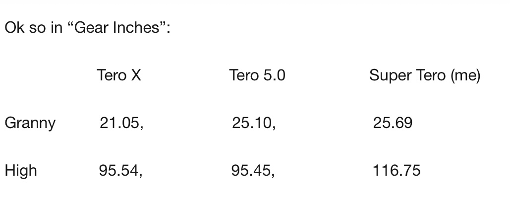

Ok so in “Gear Inches”:
Tero X Tero 5.0 Super Tero (me)
Granny 21.05 25.10 25.69
High 95.54 95.45 116.75
So the X will climb best, the X and 5.0 have the same top speed, and Super Tero will climb like a Tero but leave both in the dust on gravel and road. Works for me.
Screen shot of my chart since EBR doesn’t seem to save the spaces:
