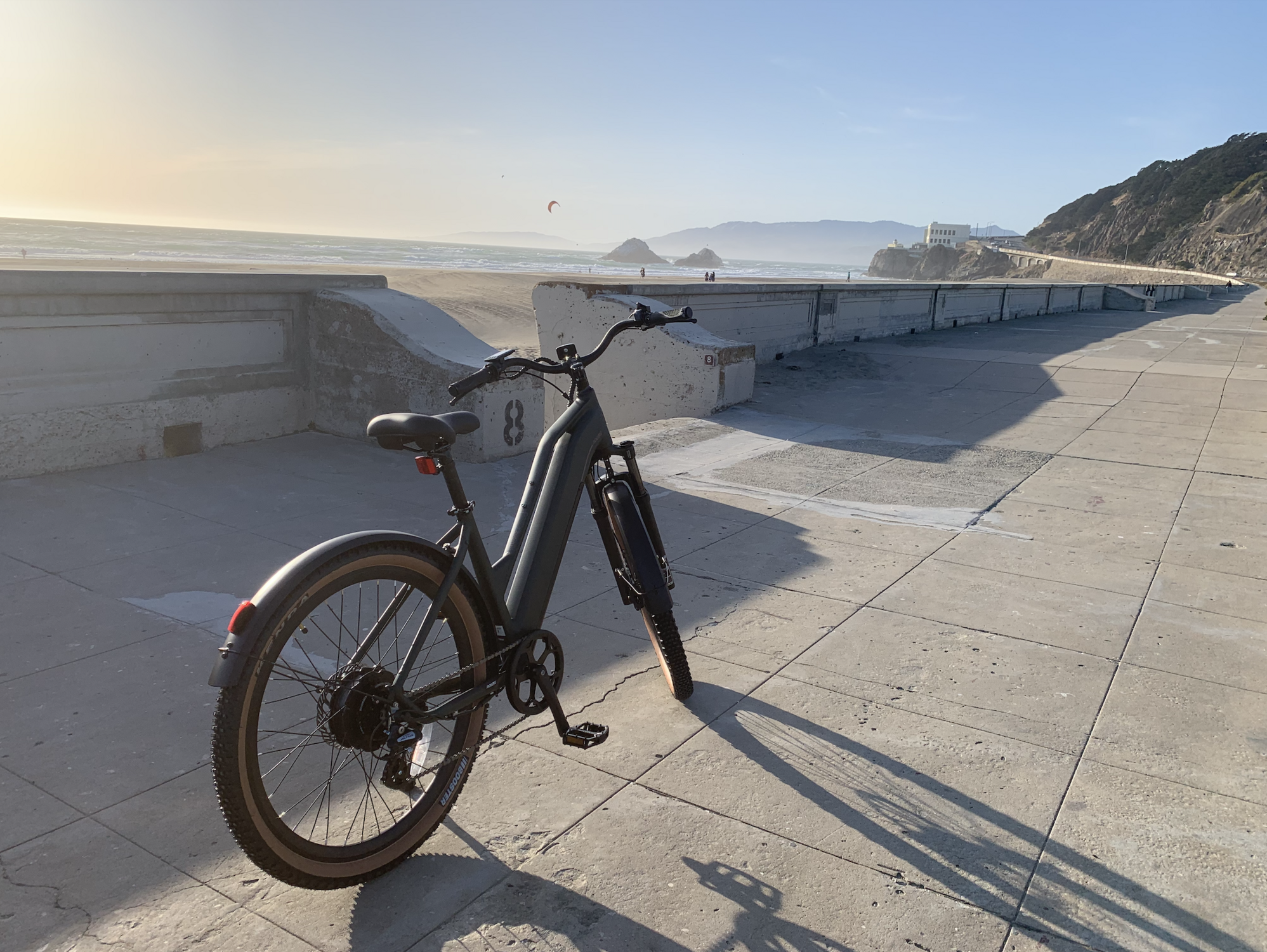

It's been a process.... mostly due to issues on Ride1Up's end (missing part etc.). Then a final one stemming from my own dunderheadedness... But it should finally be done today. I'm going to do a review thread about the Turris at some point.so... did you ever get your bike together?

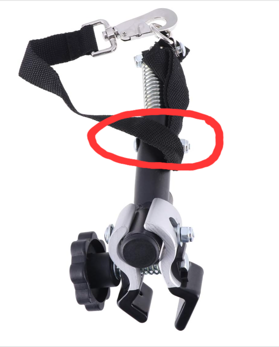

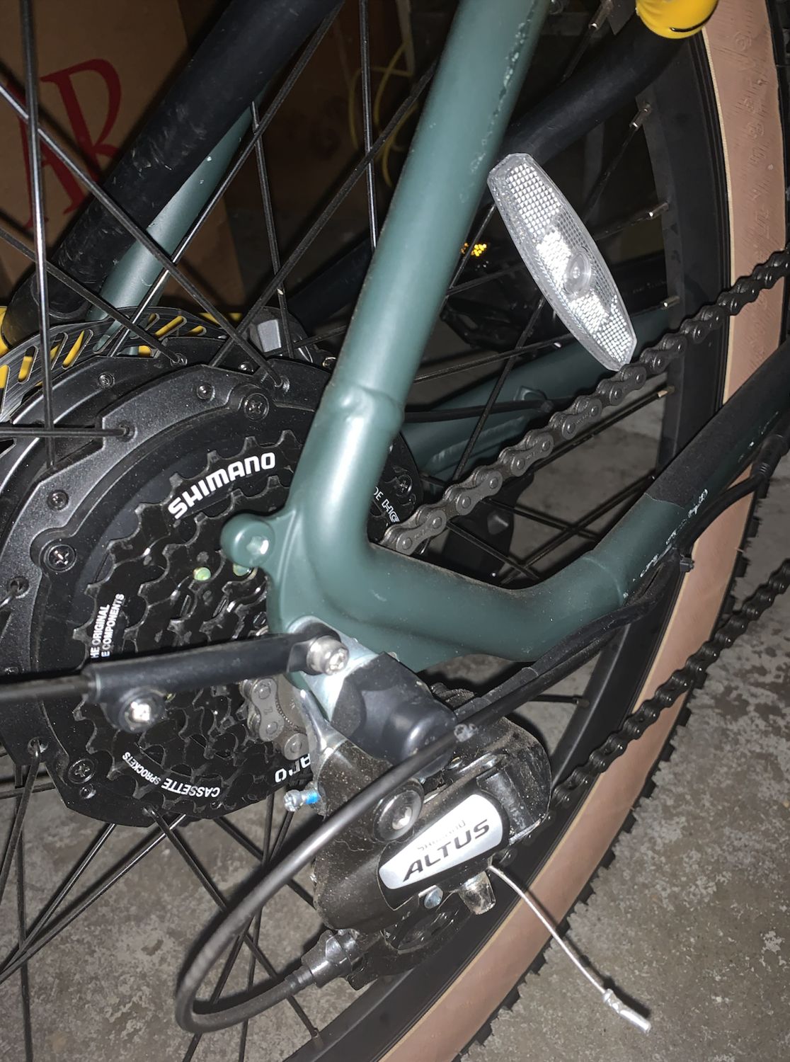

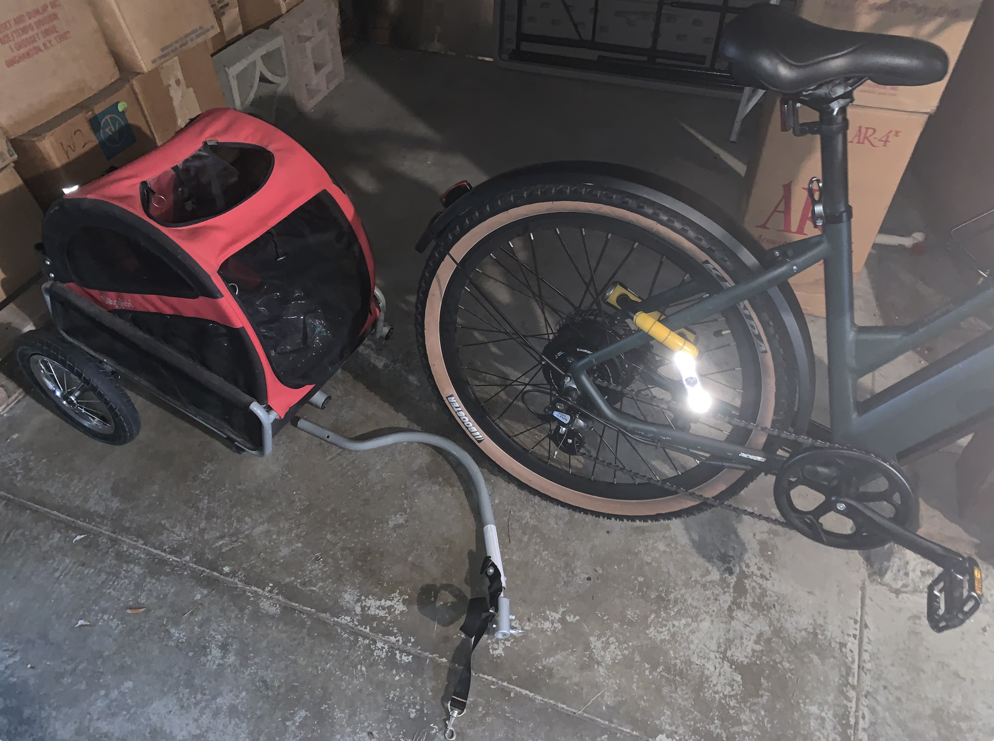

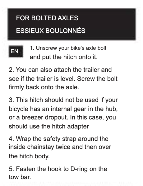

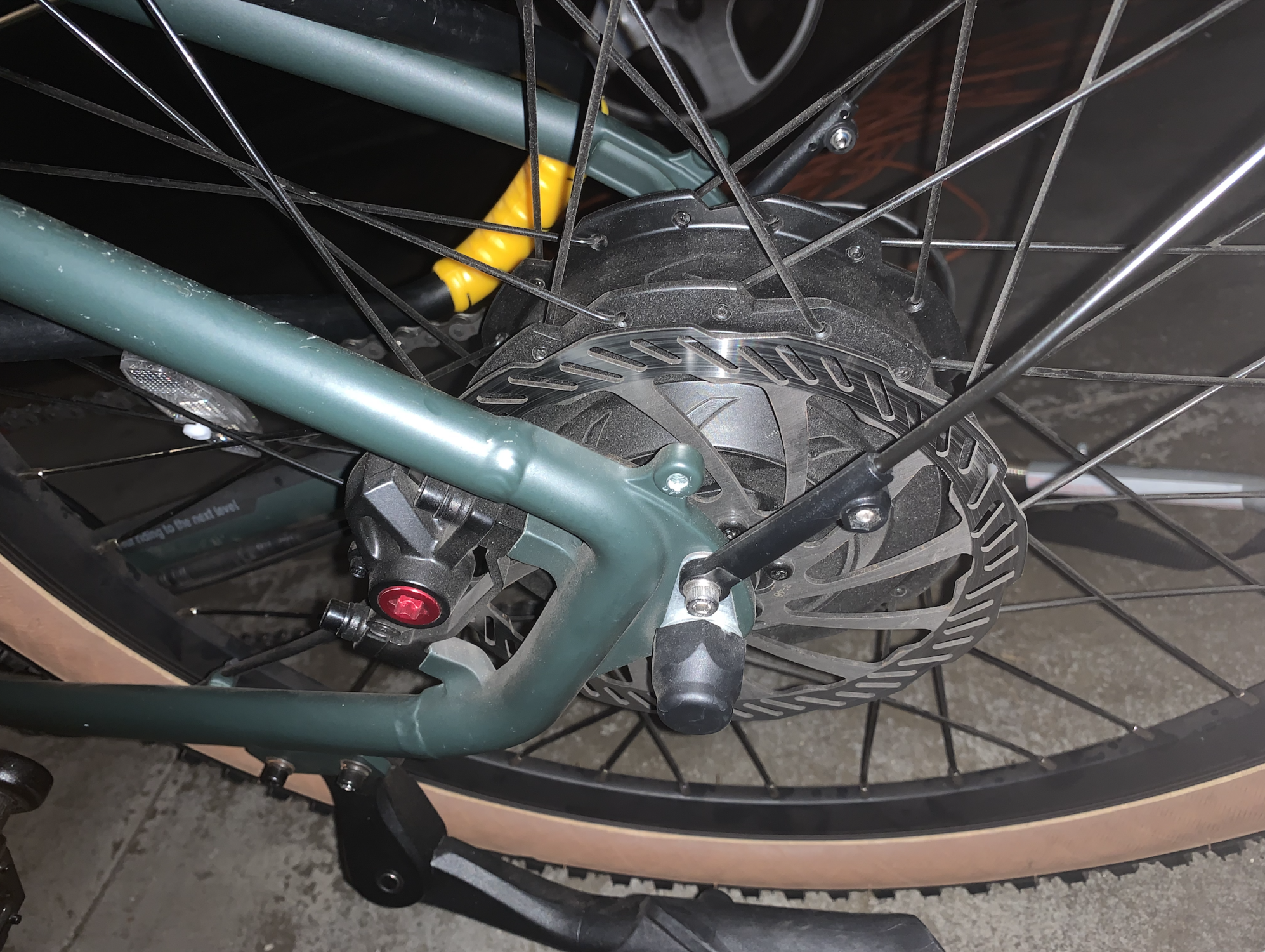

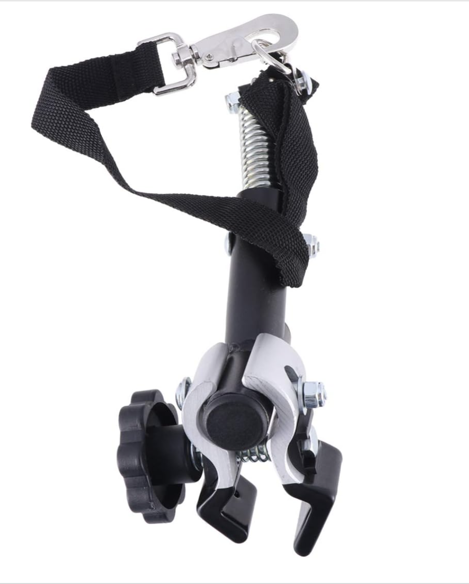

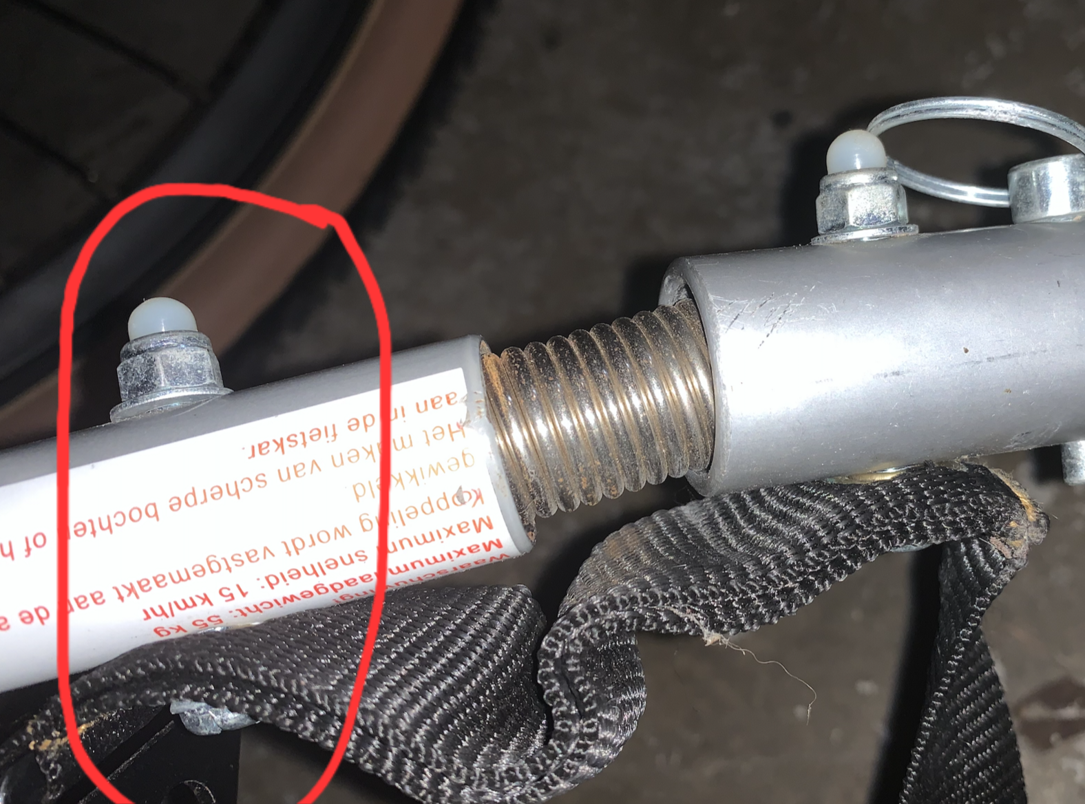

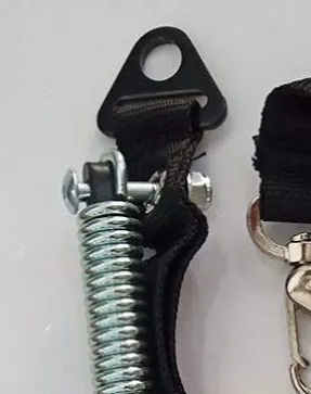

So, I think I still need this adapter to attach it to the frame instead of the axle?

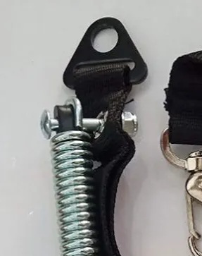

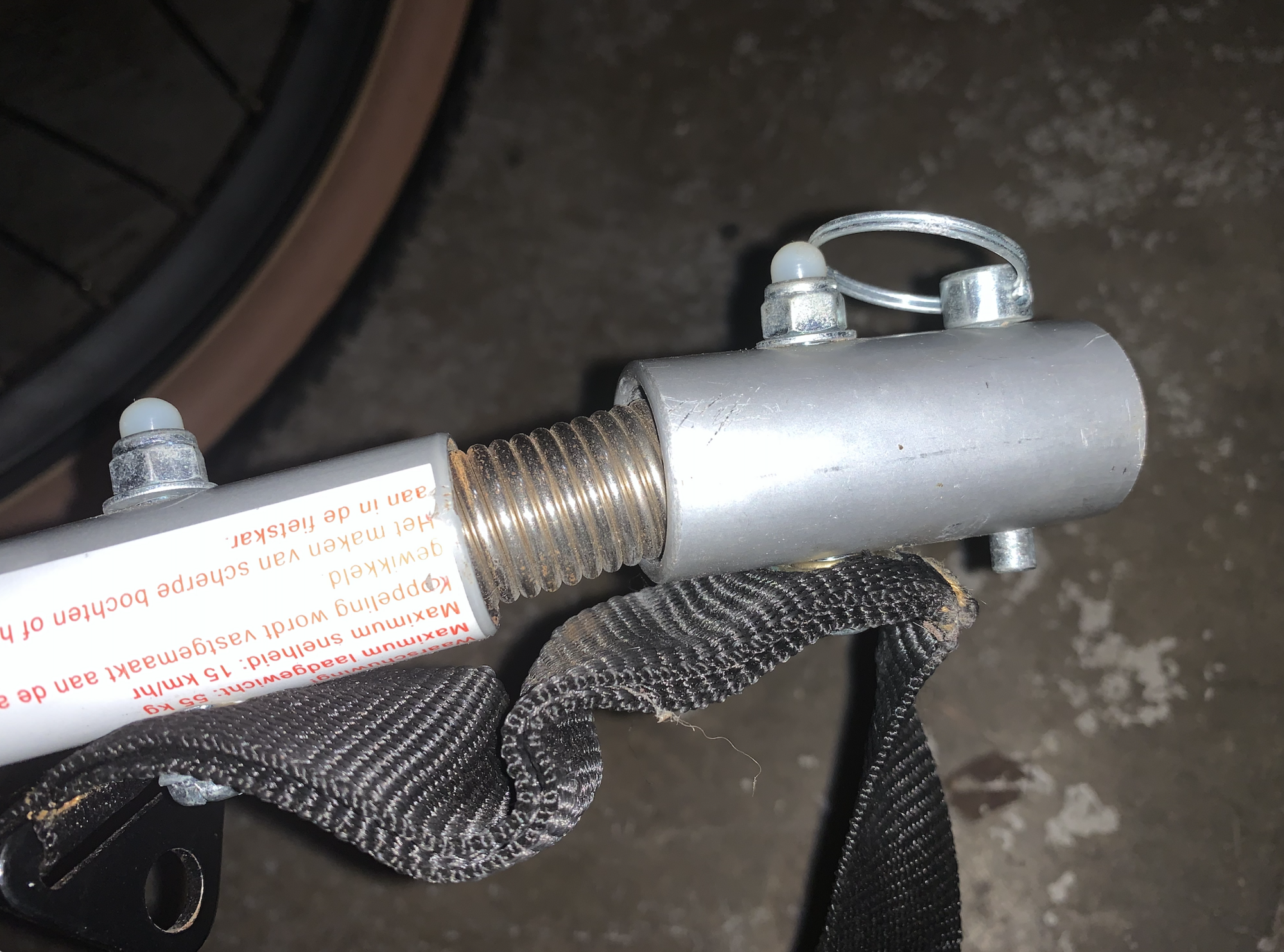

Cool, thanks. I'm wondering if the spring was for an adapter the previous owner used, actually. She said she had an ebike and said she needed an adapter to connect the trailer, but couldn't find it.That looks right to me.

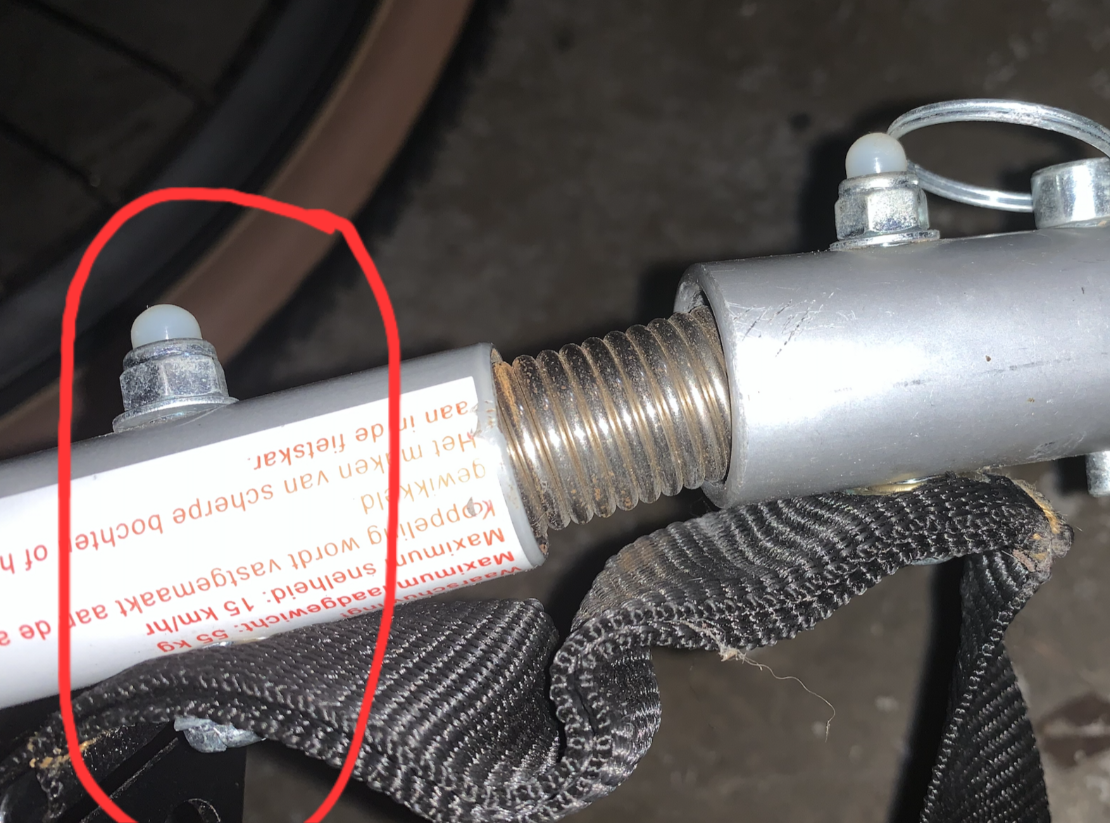

I'm pretty sure that you can just remove this bolt from your trailer and remove the spring from the attachment,..
Then you slide the spring of your new adapter into the sleeve and thread the bolt back in.
Hopefully everything will line up and the spring is the right diameter and length to fit into your trailer spring sleeve.
The original spring on the trailer is a different kind of spring, but the new spring might fit?

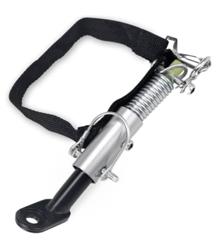

Actually,. looking at it again, it looks like you should be able to reuse your original spring?
If you remove this bolt from your new attachment, you should be able to insert and bolt in the original spring from the trailer?
I'm pretty sure that one way or another you should be able to get the clamp on adapter connected to your trailer.

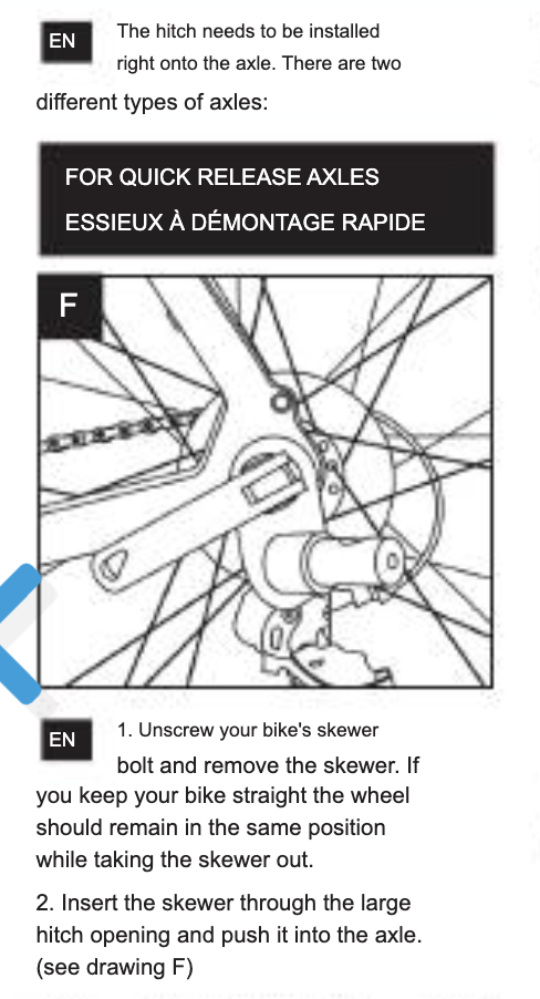

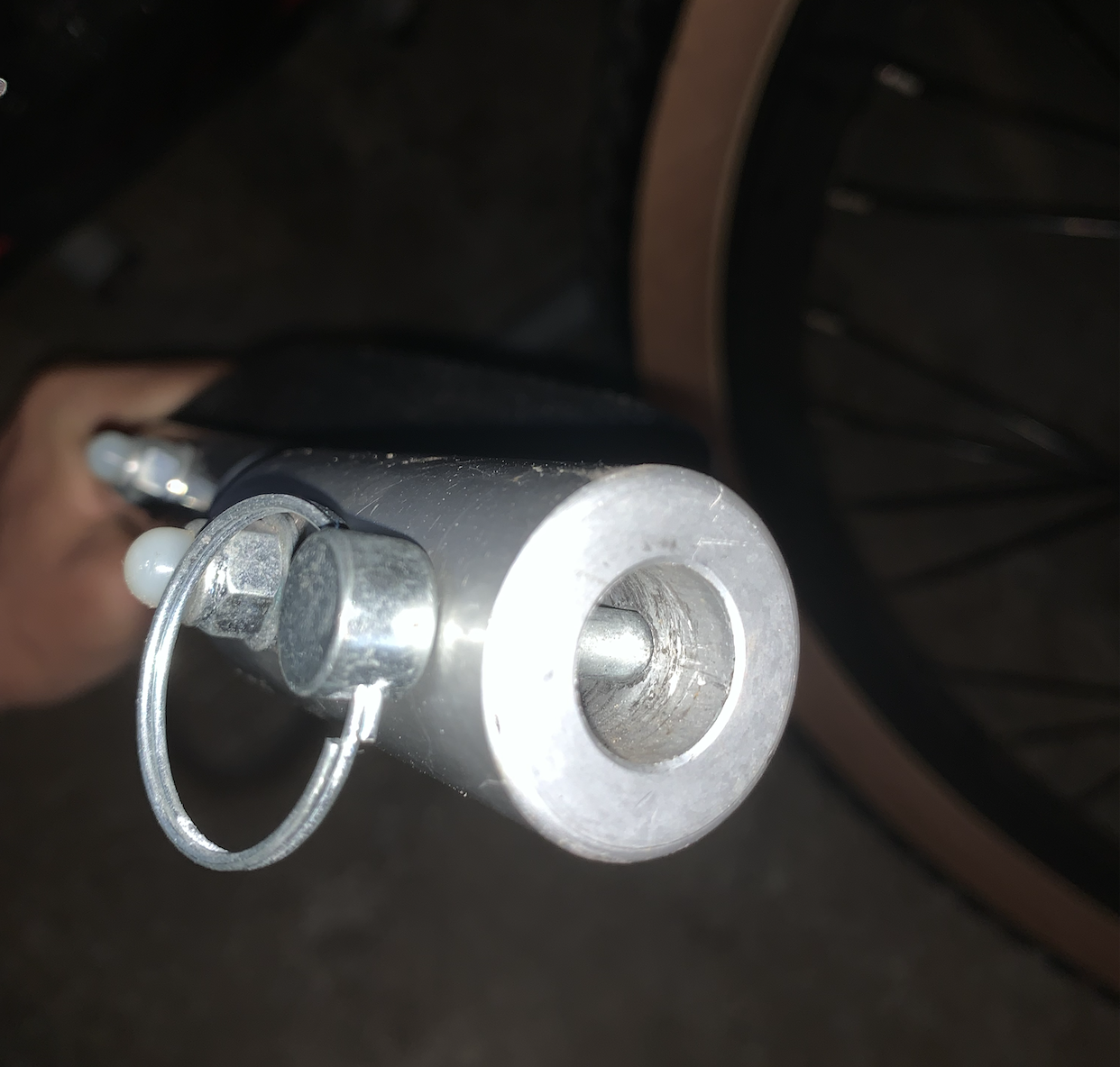

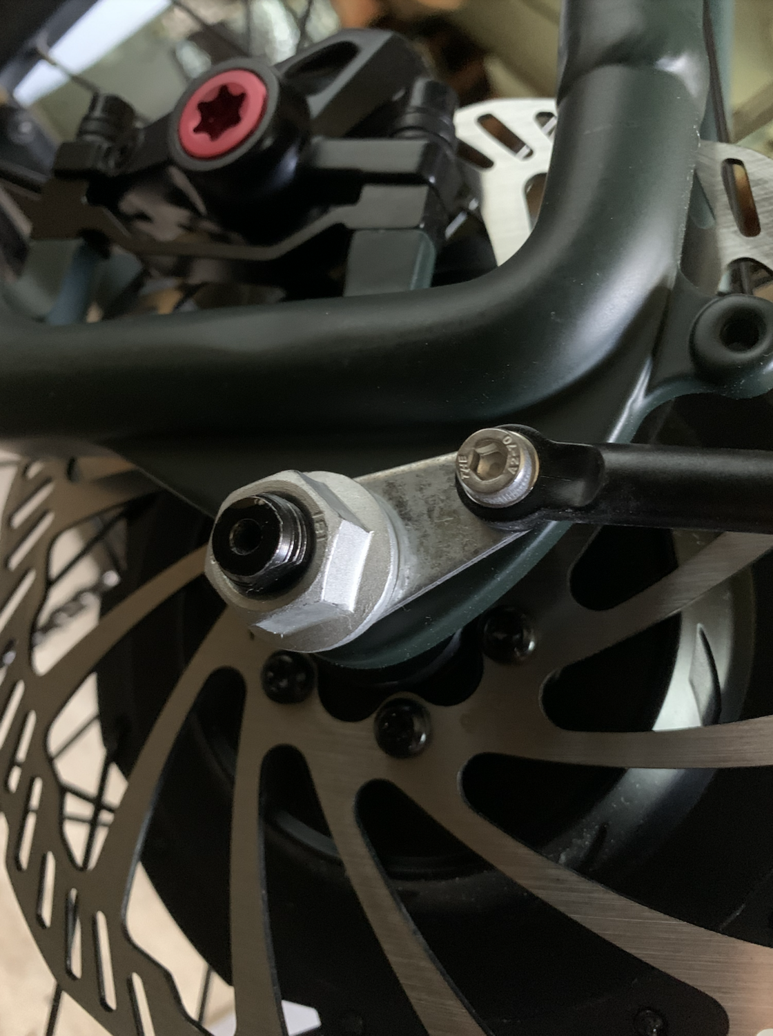

Does your trailer feel pretty stable with the axle mount? I'm wondering if frame mount is better. They're way more expensive for some reason.My adapter is mounted to the axle, so it has a quick release pin to remove the trailer and leave the adapter bolted under the axle nut.
It looks like the frame clamp adapter is completely removed from the bike frame and doesn't need a quick release pin.
