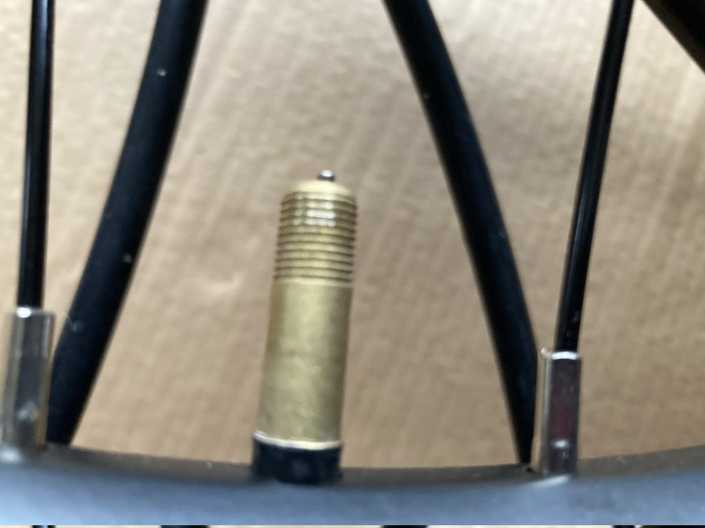

It arrived very quickly with no apparent shipping damage. Assembly was straight forword, but slow. The only problem was that both tires would not hold air despite there being no leak in the tubes. The only odd thing was what I called a sewing pin with the head, not point, sticking out of the valve (I forgot that tubes have one of those, but it should be inside the valve, not sticking out.
I tried phoning Ride1up tech support, but was hung up on. I then emailed and the reply said the problem was probably loose valve cores. They sent a link describing how to tighten them. Unfortunately, the link was about removing them.
I then gobbled "tighten bike tube vale core" and learned something new, that there exists a valve core tool, a kind of screw driver which tightens and loosens valve cores. I found a Slime branded one on ebay for $2.70 with free shipping; and it arrived within a couple of days.
I used the tool to tightened the valve; and there has been no more leaking. So now I've got about 100 miles to show for it. I can only describe the ride as smooth. The only changes I'm considering are:

I guess I should report on Plan B. I canceled the Lectric Express with no hassle, and went with the Ride1up Turris.

Good that you are riding. On my XP Lite after a few miles the rear tire kept needing to be pumped up every morning. It had a "loose" valve which needed to be screwed in to be properly sealed. Stuff happens. The tubes on the Lectric had the slime sealant pre-installed before shipping. I'm guessing the person who installed the sealant didn't properly tighten the valve enough and after a few miles it started to leak.
