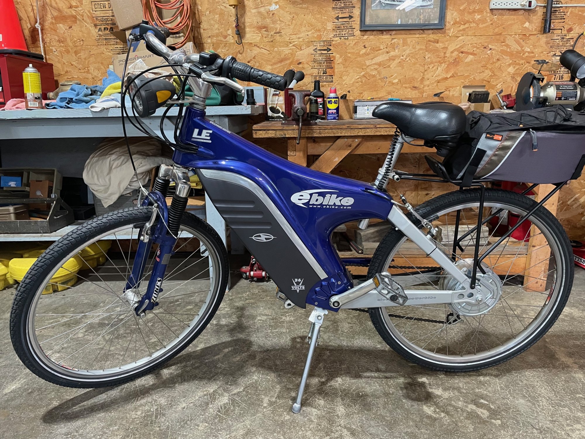

36 volt EV Global......I just upgraded to lithium, at low power all is good but if I switch to high power after a few seconds the bike shuts down then a minute or so later it will turn back on, the battery I bought is in the link below. Anyone have an idea of what may be causing this to happen.

Looks like you have an older ebike that used lead acid batteries, and you bought a 36V 10AH battery in a green shrinkwrap from amazon? It shuts off under high current, buit works on lower power.
The amazon ad's smallest battery is 36V12Ah with a max current of 15A. It can probably do a bit more more than 15A, even for a $120 battery, Looking at your bike, it seems like this should be enough to cruise around up to 16-18 mph, if the battery is healthy.
What were the older batteries? Were they 24V or 36V? I'm asking to rule out the possibility the controller in your bike is speed limited, and shutting down.

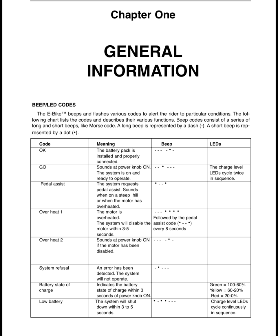

Does the bike beep before it shuts down? That bike speaks Morse code.
There should be a sticker on the motor with the wattage rating. That’s definitely a 36v bike. The 24v versions came in black and red. I have a 24v black version.

Quick Google comes up with 500w motor.

No settings a user can change. Just the “Eco/Norm” switch. The seller is long gone. This bike is from late 90’s. OP probably already saw, but here is the manual.
Kind of sounds like voltage sag that is disabling the bike. Though, a sound should be played to indicate low voltage warning. Perhaps voltage sags so fast that LED codes aren’t displayed.
