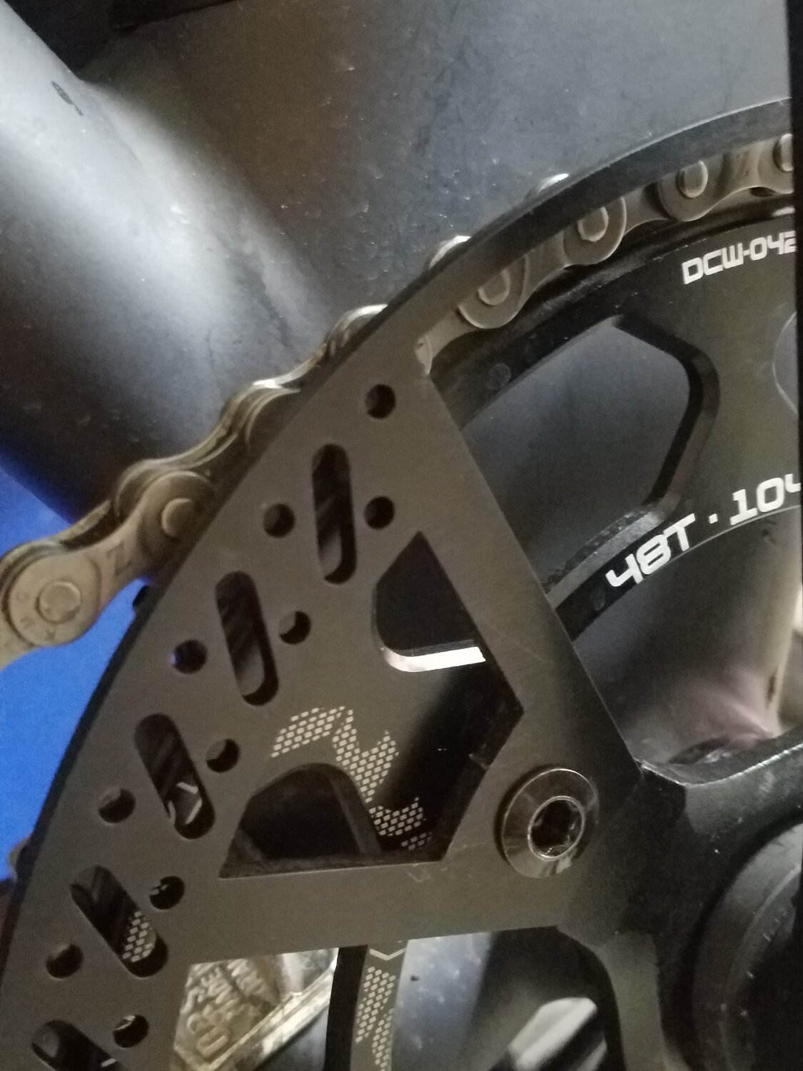

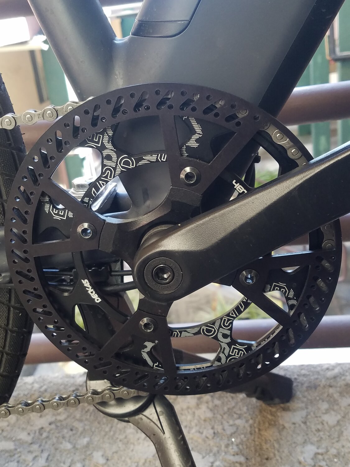

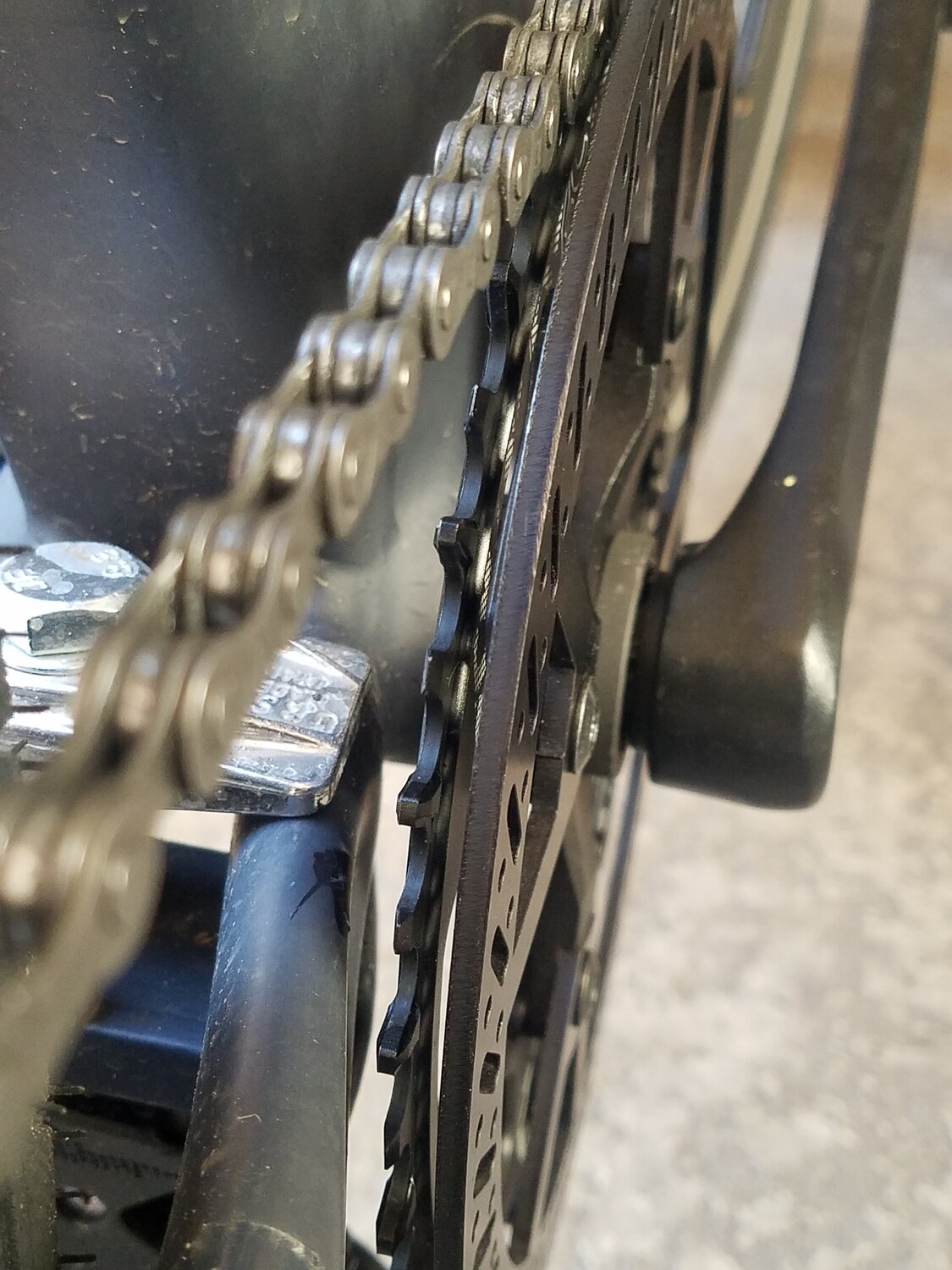

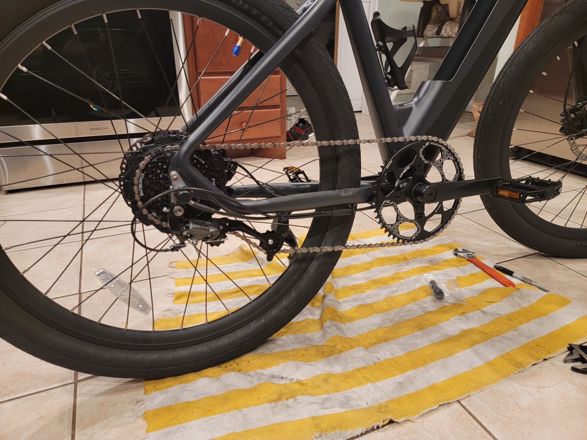

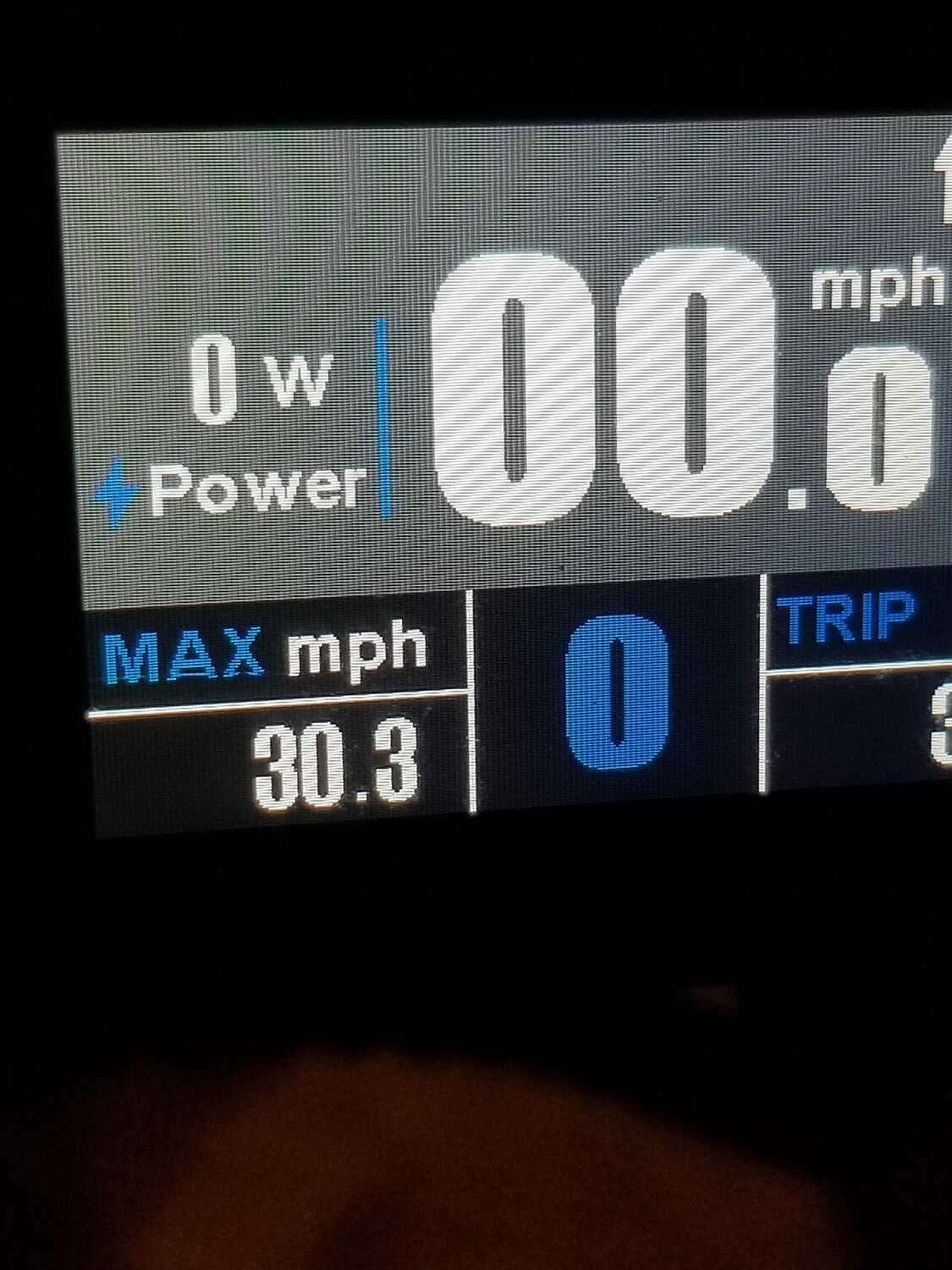

I changed the ring to a Decker 48T. Bike hits 30.5mph pretty easily.
Modification? The settings go to 31mph.
I've posted the whole thing in Ltd problems forums here. A 50T won't fit.
Yes, it makes a difference.
Over 8% less pedaling speed required.

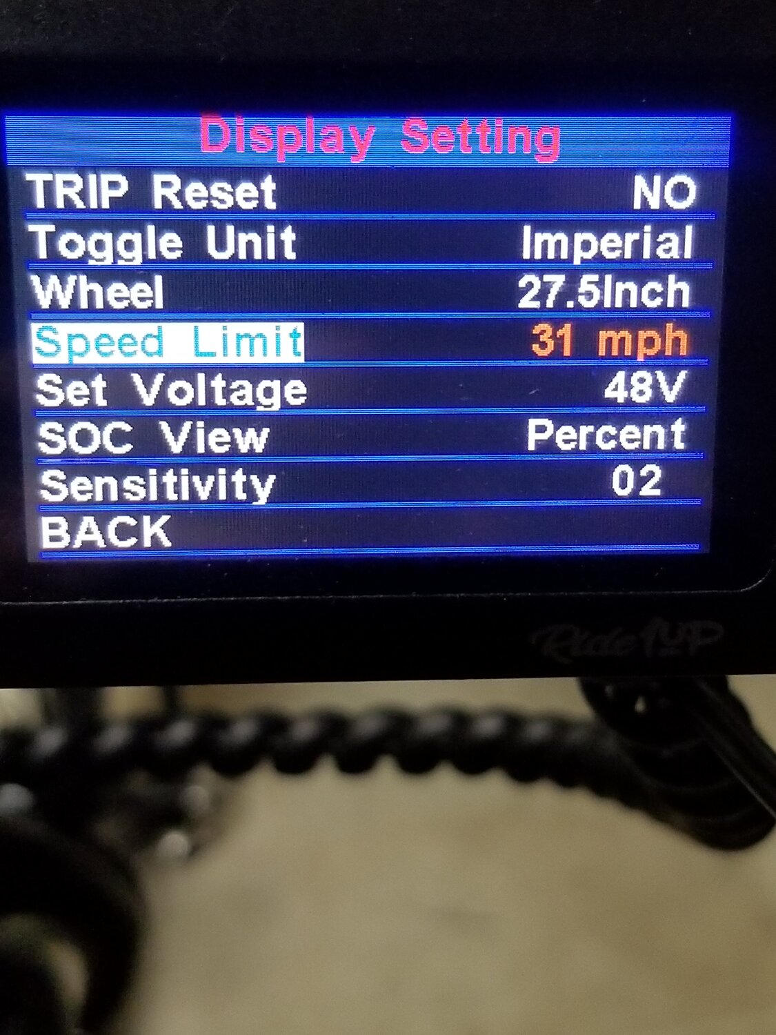

These incorrect answers are disturbing.
My Ltd's display setting goes to 31mph (See Photo).
I go over 30mph, without throttle using PAS from my TS on a daily basis (on Level 2).

You change your pedal assist speed by increasing your ring gear size. There are cassettes with smaller cogs that will do it as well.

I did check my maximum speed setting on the display screen which is 31 mph. I assume this means maximum PAS speed, beyond which your legs are on their own. I seem to recall that maximum thumb throttle speed is 21 mph, not sure since I have seldom used that. I will check this out when I next ride since before, the maximum pedal assist speed was 28 mph.

We're you able to use your stock chain guard when you moved up to the 48 tooth Deckas chain ring? If not, where did you find one to fit the larger diameter ring? Your picture shows a guard that looks different than what's on my limited.

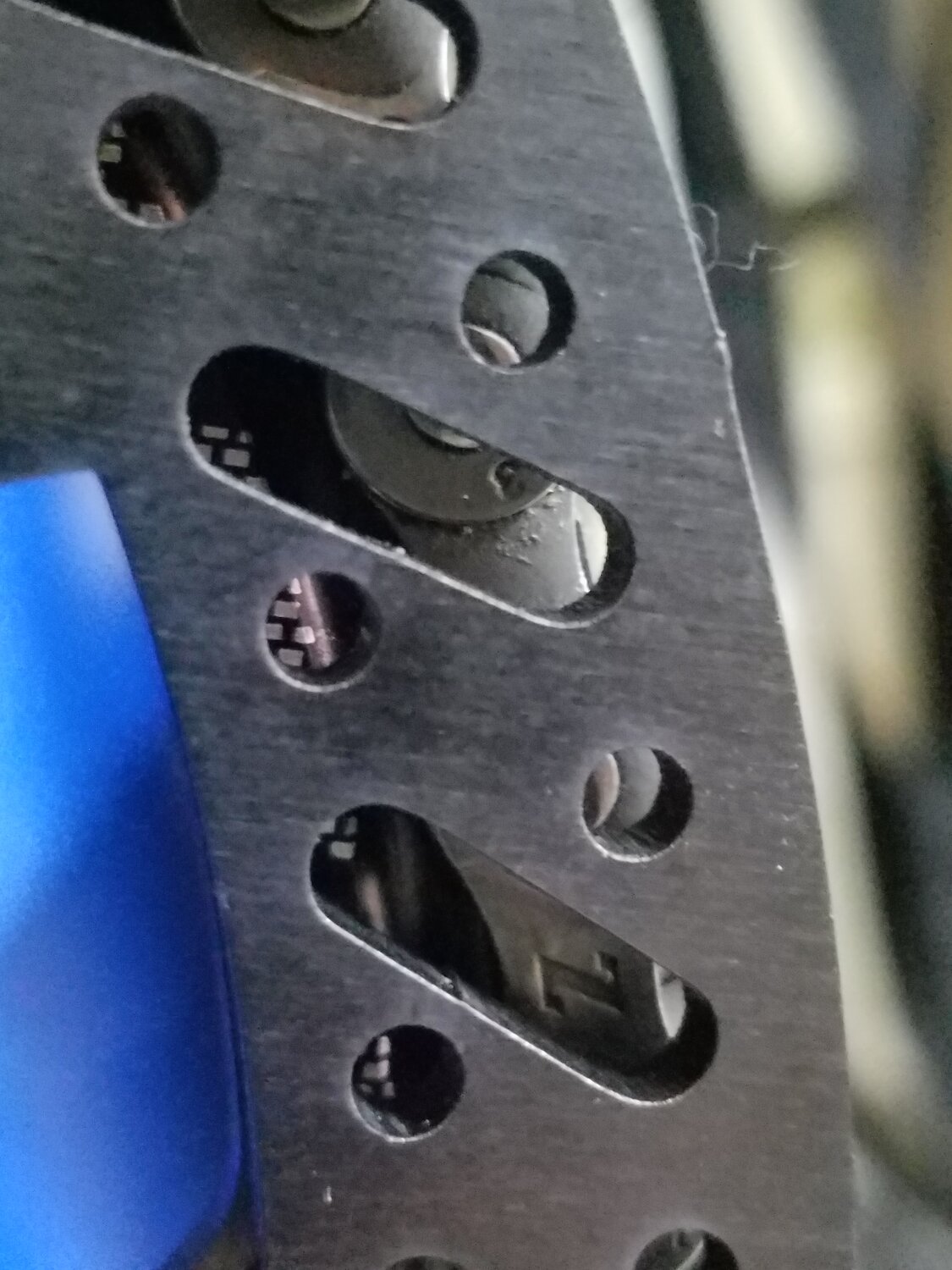

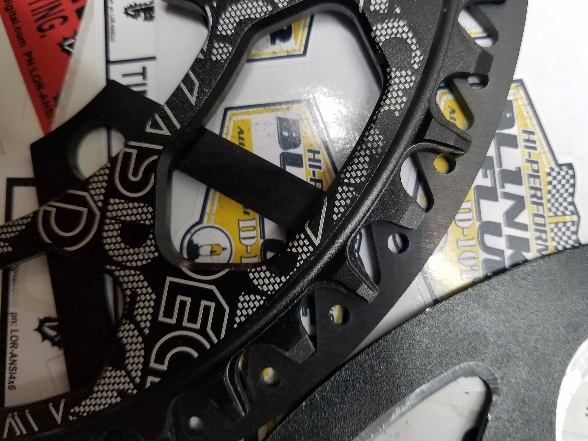

The stock bash-ring was damaged by the chain. A new one was 10 - $15. They come in ten colors and different cut outs, but they were all the same quality, not to my taste.
That Deckas Hi Low ring has proven to be durable and quality. I was surprised. They are so inexpensive.
No the stock bash-ring won't fit.
That BR was custom, USA made of laser-cut billet - unfortunately, I can't find the company now. They made custom rig-gear stuff for BMX. I had to trace them from a British Ebay post.
You're quite observant. That bash-ring was for a 46T, not 48T.
View attachment 105756 There's the stock and the billet BR compared in size View attachment 105757 the old set, View attachment 105758 comparing the new BR/ ring-gear View attachment 105759 the actual clearance when completed, View attachment 105760 how close the bash-guard fit really is. View attachment 105761 You can see here, a 48T is as large as you can go without an offset (note the scant chain/ chain-stay clearance).

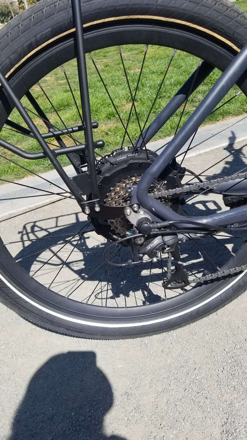

R1U 700 48V Geared Hub Shengyi Motor 60Nm. Nominal rating of 500w) = 10.6A
R1U Ltd 48V Geared Hub MXUS Motor. Nominal rating of 750w. = 15.6A
R1U - and MXUS - provided documents - on this forum - showing this is a "special order 1000Watt Cassette Motor", unavailable to the public.
MXUS advertises this Motor (sans-cassette) as 1000/ 1500watts. MXUS told me it "is too powerful for a cassette".
Again, I've published the entire cut-and-paste conversation.
As 'legal' Hubs go, this one fit's in with Bafang's departure from the market - in a sense.
Both run the 48V22A Lishui, 22A (1056Watts) Controller and 48V14ah Samsung 18650's
On my 700, which uses the same KD218 display as the LMTD, the setting "speed limit" is only relevant to throttle assist limit. I mentioned this earlier in the thread. The PAS max is always 28. The speed limit setting came defaulted to 20 mph on my 700, and my throttle would assist to a max 20 mph, and PAS assist to 28 mph. When I changed the speed limit to 28 mph, throttle would then continue providing assist up to 28 mph, with no affect on PAS assist which was always assisting to 28 mph. I don't have a LMTD to compare, but you can test that easily yourself. One thing that is definitely different is that the 700's speed limit setting maximum is 28, so 31 on the LMTD is certainly a little higher.
Nice looking oysters
Sorry for not reporting sooner. I'm stuck on stupid on my next build. I found a 46t guard will cover a 48t gear - no problems w/ pants 20210130_131221.jpg 20210130_130042.jpg20210130_125816.jpg20210130_131307.jpg
A larger gear will not only interfere w chainguard, but more shifting would be required (See: Chainstay clearence, last photo).
That means big trouble w/ offsets and readjusting the derailleur to (maybe ) work right - pretty much forget it. 48t is the MAX.
I should make clear: After 31ish mph, yes the drag from the motor's plummeting effifency curve retards any input of any kind, but, getting there and pedaling in the 23 - 26 mph range is greatly enhanced with a 48t Ring.
People will say "Ohh, but I like the exercise" and I agree. I get plenty covering ground faster - than on a boring bike - and constant shifting is not exercise.
Better efficiency does not assume less exercise. Being in the adrenaline factor zone @ 240mph in a Bugatti, now that's exercise!
Works great. An inexpensive upgrade - if you use an economy guard. The Decker 48T - 104 Narrow Wide ring shows no significant wear after a couple thousand more miles.

I replaced the front sprocket with a 52t, but the new shimano chain seems a little short in the largest rear cog.
I also upgraded the front sprocket on mine, but only went up to a 48T. I think its much better, but I think I read the max is 50. I think you may have the sprocket on the outside of the cranks vs the inside if that makes sense. I did the same on mine and the chain seems to fall off much easier in the lower gears. I need to change this if this is true?
But yea I think your chain is way to short now for that 52T. Why did you choose 52?
