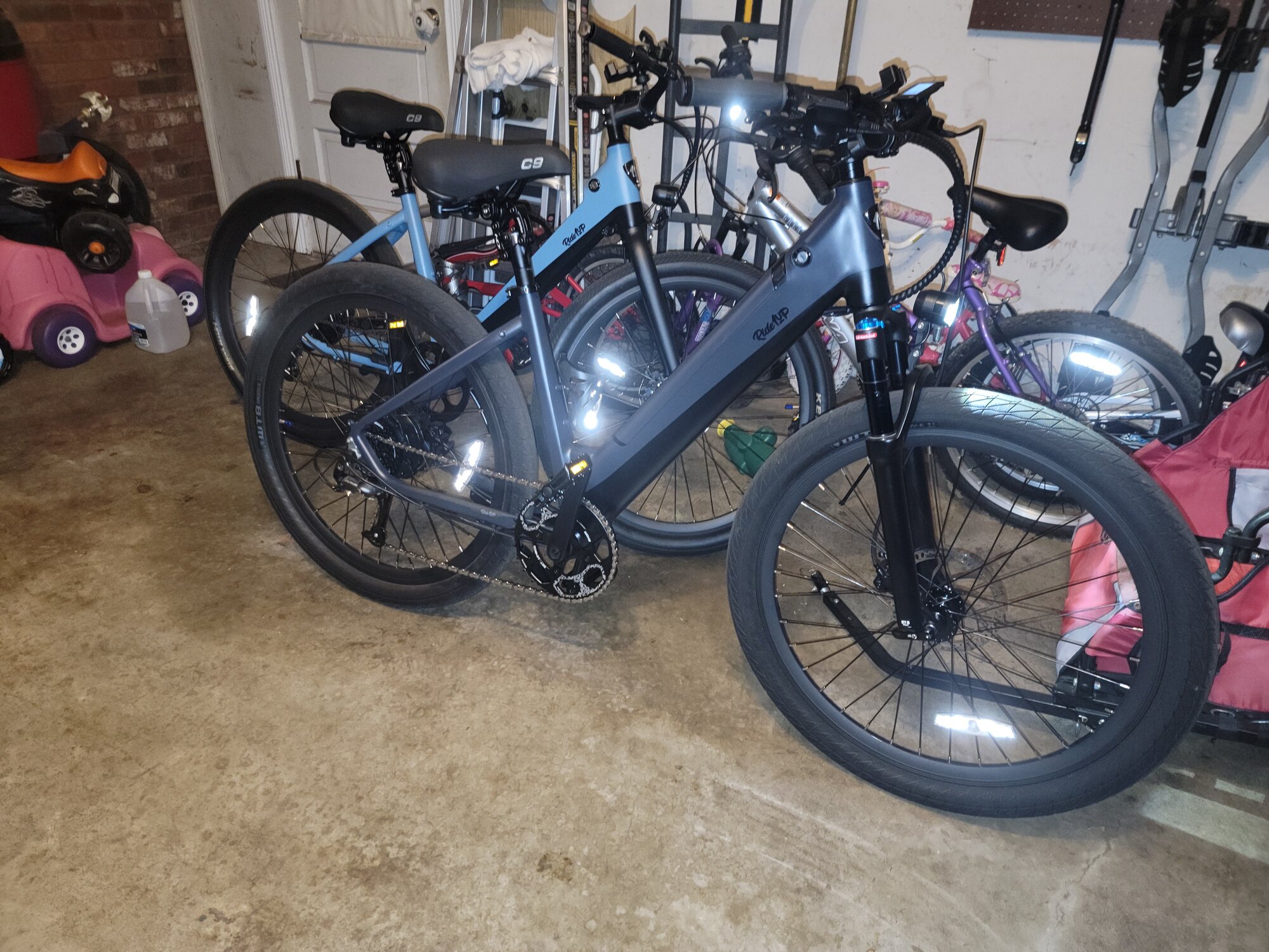

View attachment 138724I replaced the front sprocket with a 52t, but the new shimano chain seems a little short in the largest rear cog
I also upgraded the front sprocket on mine, but only went up to a 48T. I think its much better, but I think I read the max is 50. I think you may have the sprocket on the outside of the cranks vs the inside if that makes sense. I did the same on mine and the chain seems to fall off much easier in the lower gears. I need to change this if this is true?
But yea I think your chain is way to short now for that 52T. Why did you choose 52?
52T feels really good. It gives a perfect gear range in my opinion. You are correct- I put the sprocket on the outside instead of the inside for a few reasons. First, there are no 52t size guards available to go on the outside, so it looks bad on the inside. Second, I was worried about the teeth hitting the wiring that is tucked there. Third, on the inside, the smallest cogs would be really out of alignment with the front sprocket. I went with the Shimano CN-HG71 116L chain. I'm considering purchasing a second one and two more links and adding on 4 to 6 more.

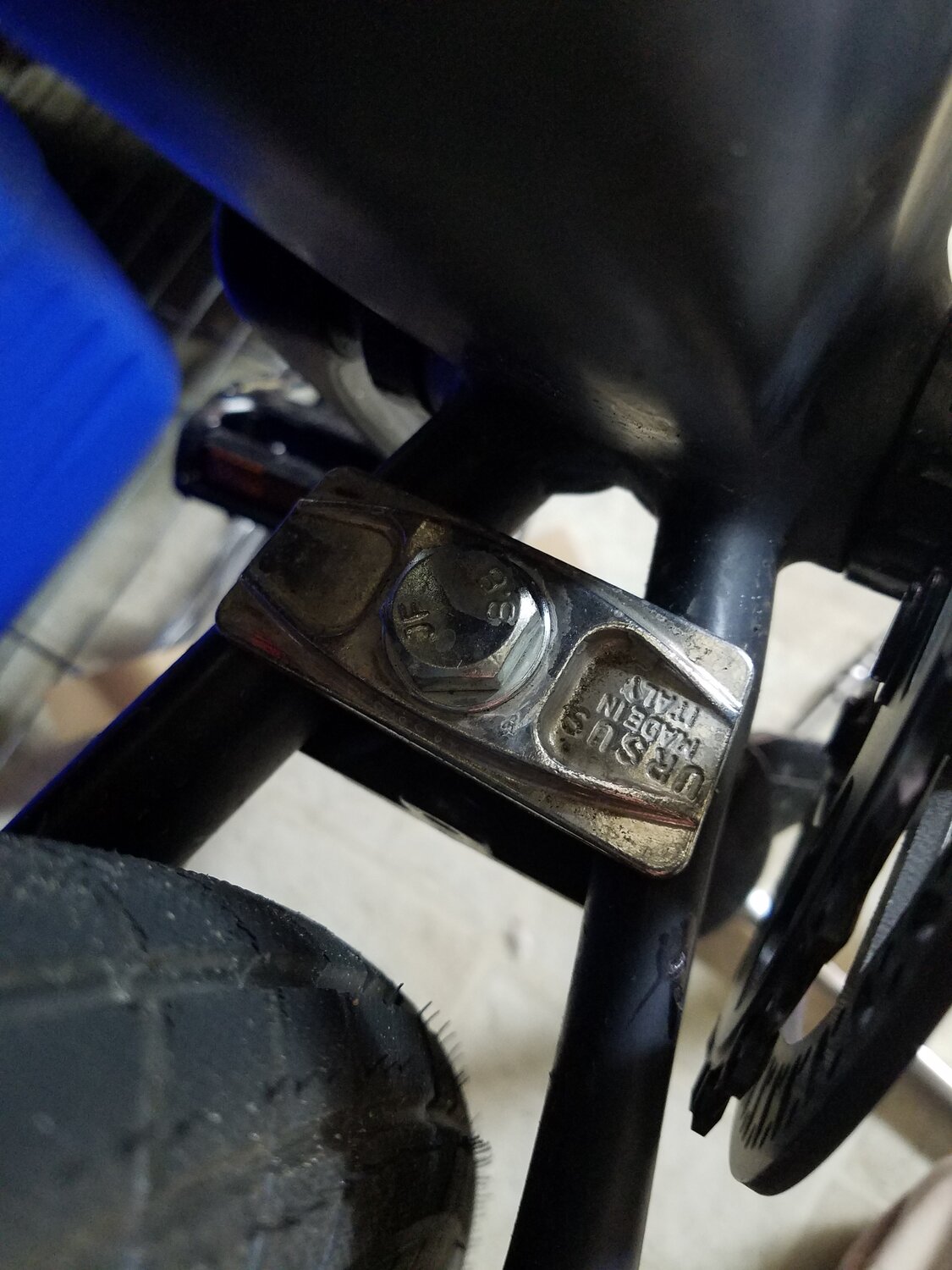

Yes. Definitely mounted incorrectly.

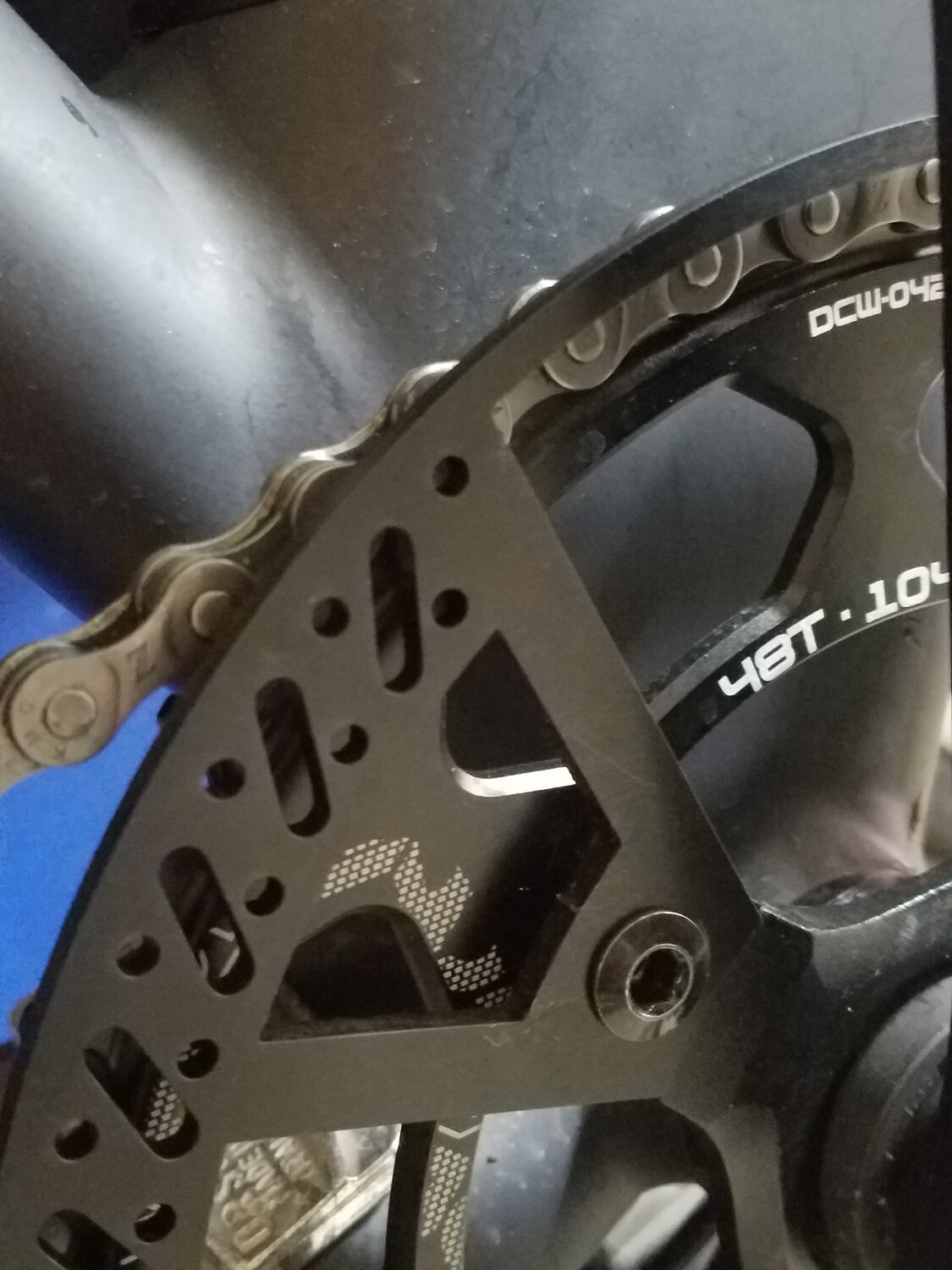

Here's my 46t to 48t conversion. I had doubts a 50t would fit. Perhaps the frame has changed, but a 52t was out for me.
And indeed, the chain-line should be on the center cog, or you'll have problems. Also, it's fine if it works, but of little benefit.

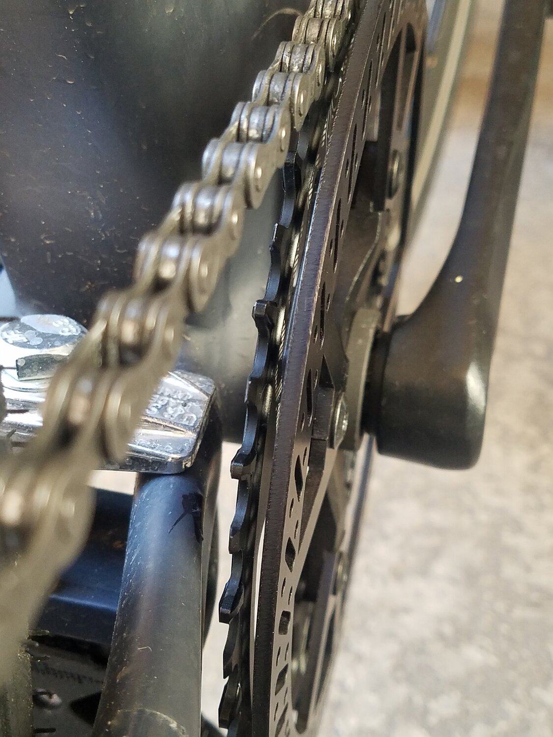

As I remember, a 9sp is narrower chain. Your issue will be the chainline (and the lack of any protector to keep your pants out of that ring/ chain interface). Dropping your chain at all, you're out of whack and will mar your frame.
5mm additional offset is a lot to be small-cog biased, and even if it'll work will cause excessive wear to your cog and chain b'cuz you're two gears past the end of range and two gears shy of the upper range.

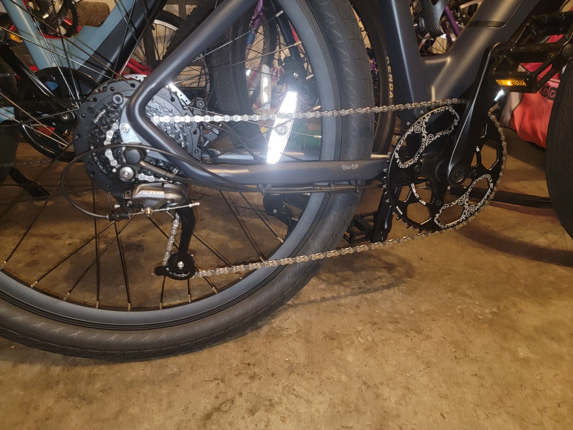

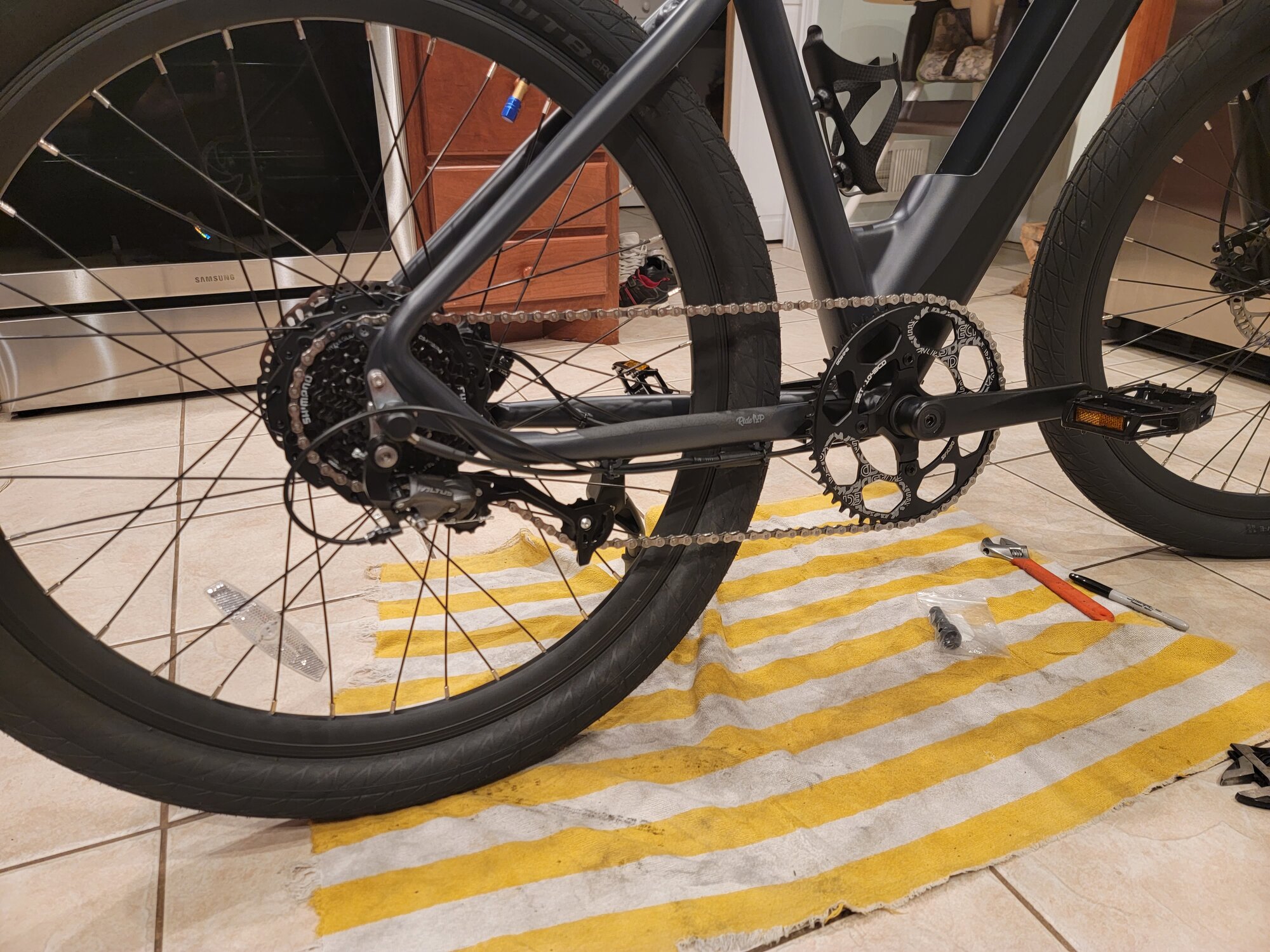

The problem is the stock chain is 116 links and I need 119. I thought it might make the chain a little rough if I add 3 quick links in a row. I was thinking the better way to do it might be to buy 2 chains and take three off the second one and add it to the first one?
How many speed is your bike? 8?
You can get something like this and cut it down to either 120 or 118 links.
120 links sounds perfect. I kind of like the idea of having the Shimano hyperglide chain since it's a hybridglide cassette in the back. Yes, 8 speed and 52t front. Maybe it's my imagination, but it feels smoother to me than the stock chain did. Since I already bought one shimano chain, can I just buy another and remove four links from it and add them to the one I have?
The chainring will have no factor on the accuracy of the speed. A workaround to get assist faster than 28 mph would be to change the wheel size or speed sensor setting in the display settings so that it reads a lower mph on the LCD than the actual speed, so the bike doesn't know it hits 28 mph and should continue to assist beyond that. I have a Ride1Up with the same display as the LMTD and tested to confirm that it affects that speed reading significantly, although I haven't tried to use assist at a higher speed as a result. I set mine back.
Thanks for the update! Interesting to hear your latest moves. Yea I just bought my LMT'D and so far pretty happy with it, esp. for the cost. Will keep tinkering with it, but pretty set now with the 48T up front. Prob wont mess with controller as I would prob be better off looking into another bike at that point. I don't recall much over 1000 watts but its still like new so will monitor it more as I move along.

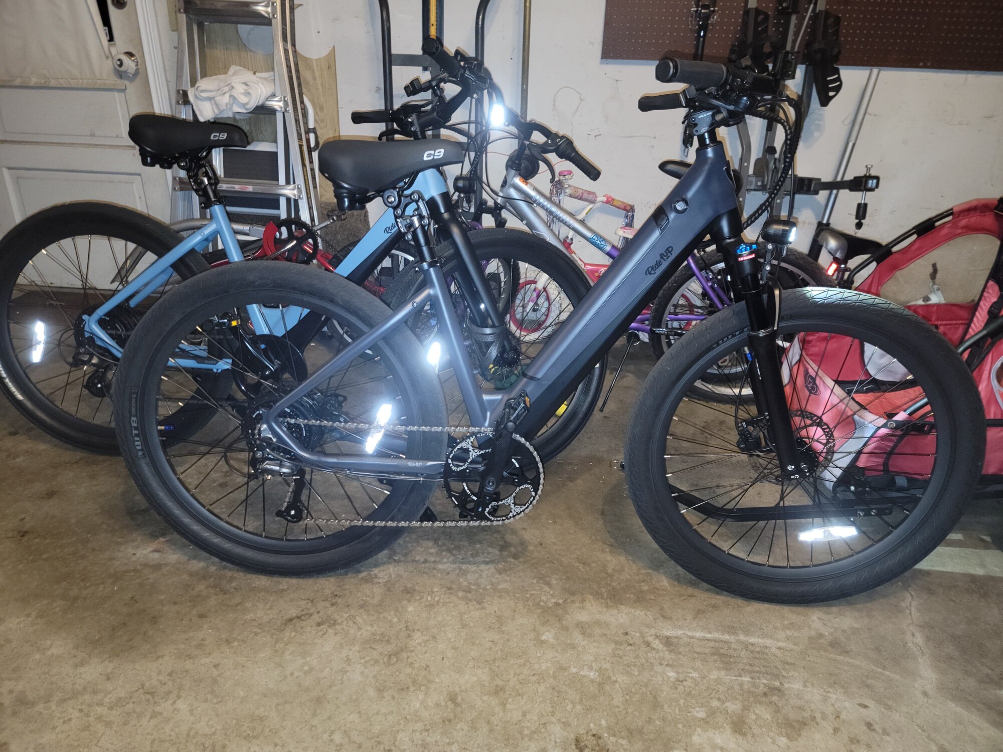

Here's my new child.
Just getting it finished up - if such a place exists.
Update: I purchased a second shimano chain and lengthened it to 120 links from the factory 116. It now shifts perfectly smooth with the 52 tooth front sprocket and it feels amazing! Have no problem hitting top speed now without ghost pedaling. Super happy with this mod!
If it works well, you're on to something. My chain lasted 4000miles. I only replaced because of the miles. Not at all worn out I could see.
