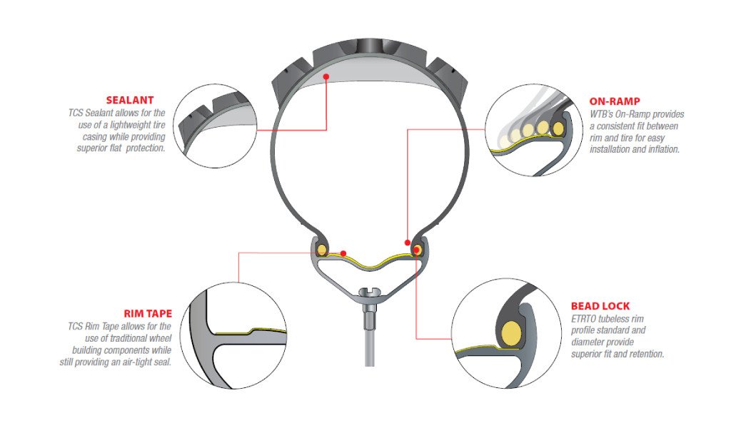

I know that Schwalbe gets a lot of positive reviews on the forums but there are other brands that have been at it just as long and have equally good tires and tubeless systems. Choice is good but can also be confusing.
I like the WTB TCS system because it mates the tire to their rim which most companies don't do. They have the sizes and tread patterns for the tires that I require and have had excellent results using it.
https://www.wtb.com/pages/tcs

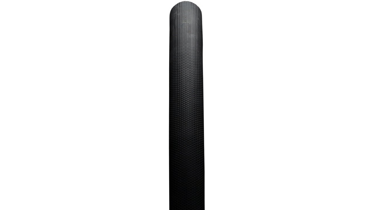

Here seems to be the best available bet!
I will probably order these Schwalbe tires soon.

Schwalbe terms 700c tires wider than 42mm, as 29 inch, I will guess because the OD of the tire has grown about that big.
Yes, they come in other sizes than the stated 29. Check the link for available sizes?
Will order the tires from Germany because that linked supplier seems to be the cheapest source.
The new tires will not be much wider than the CCS stock Kendas, but they will on the order of a half inch wider than the current Michelin Protek 38c tires and hold a lot more air. Will the new tires:
Specifications:
Application: Gravel
Product Line: Evolution Line (competition)
Type: folding tyre
Tubeless System: Tubeless Easy
Technical Information:
Rubber Compound: OneStar
Tread: HS 472
Carcass: 67 tpi
Sidewalls: SnakeSkin
Puncture Protection: V-Guard
pedal better, ride better, grip better, brake better, go over sand better than stock? What would make them faster and smoother running: nixing the V-guard and Snakeskin and Tubeless Easy features and option instead a version of the tire that uses Schwalbe 127 tpi fabric, not at all puncture resistant. But I am going to make it tubeless with sealant and don't have much on the roads here to gash a delicate sidewall. However, unfortunately, the 2 inch wide G-One stire is available in the relatively armored and thus a bit less supple, specification.
Should be a treat, nontheless. Ordering soon from Germany...
