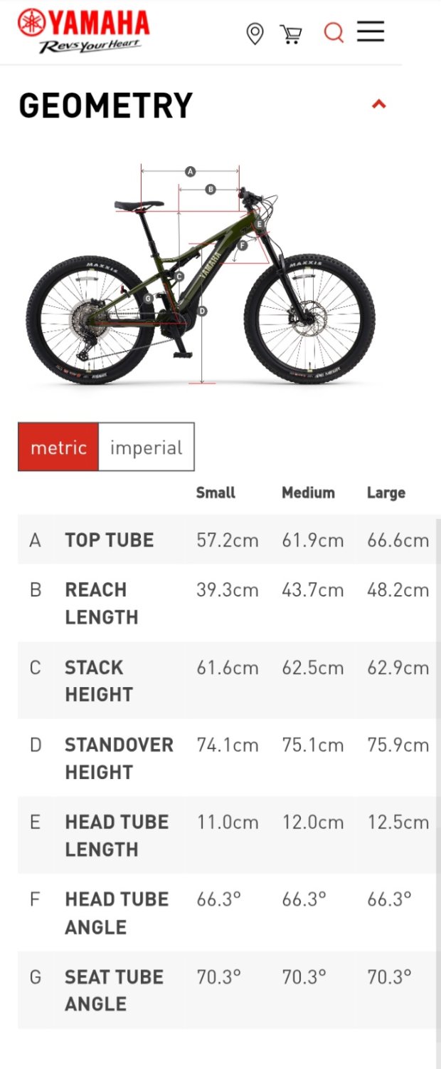

I'd get a Yamaha but I'd want this one and it'd be 7-10 thousand dollars with tax in Canada??
I dunno?
I thought that they were on sale ??
I dunno?
Stock at a local Yamaha dealer is getting very thin but they have a YDX Moro for $1919 USD ($2745 CAD). If you live close enough to a US dealer with stock maybe it'd be worth the drive?
