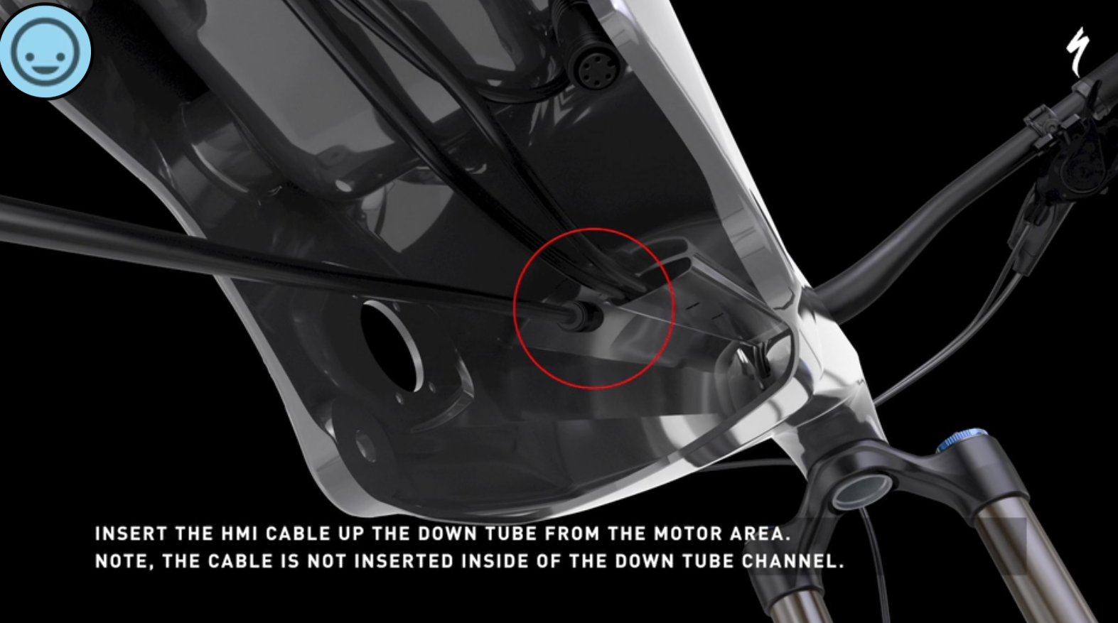

had to dig in the mail for this video. Halfway in they show the cable routing of the main cable harness which runs the comms in the system of DU, HMI, Battery and Speed sensor.
The HMI in these systems perform different tasks, mainly to let the system communicate with the user, via the "display" function, BT connection with the app, via USB to the PC connection software (basically a bridge function between the CAN system and the software on the pc) and in most cases also the buttons to activate the system. Also with this HMI the external power cords are attached on the remote port, If you would look at other vendors on the market, these systems work the shame, Mahle X35/X20, Hayena, Avinox, etc work the same. Bosch and Shimano have a different port layout from the DU to the HMI, but functionality is almost the same.
