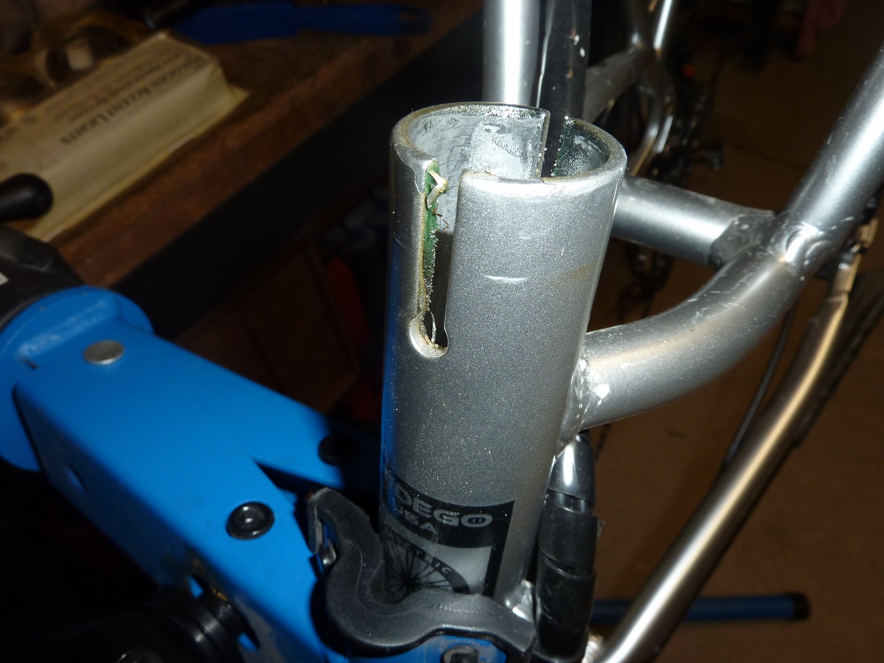

I remove the seat and suspension seat post to keep moisture & dirt from the springs and bushings. It's also no fun riding on a wet seat. I then cap the seat tube to keep water & debris from entering:

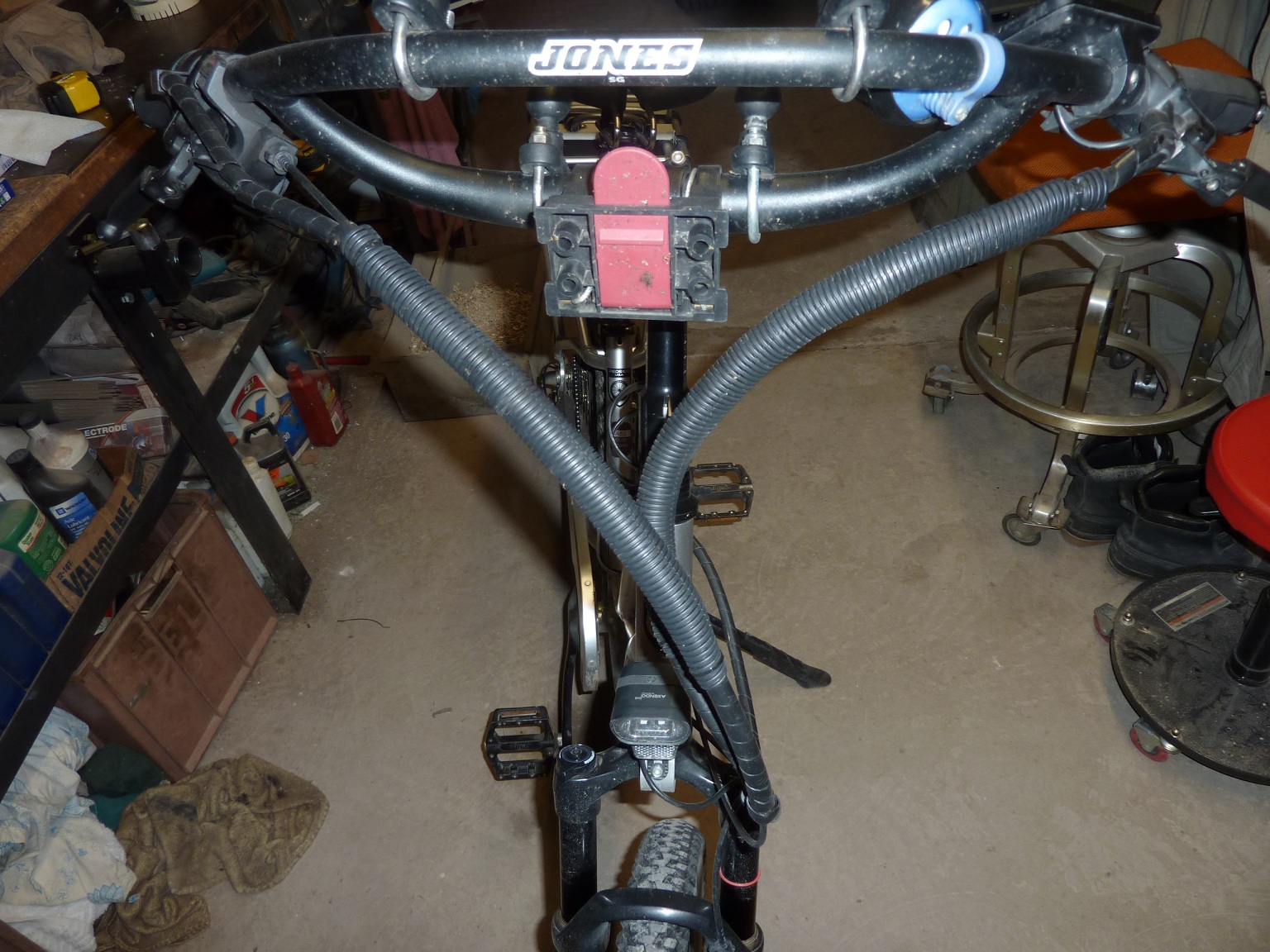

In the past, I've had trouble with moisture entering the throttle and display wiring harness connectors. To prevent this, I put pieces of split vinyl tubing over the control cables, wiring harness & connectors:

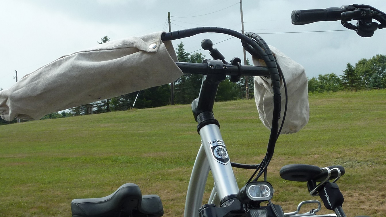

I've also had trouble with dirt, bugs & moisture fouling the control cables. I started covering the handlebar ends with heavy canvas sleeves to prevent this on my conventional bikes many years ago and continue the process with my ebikes:
