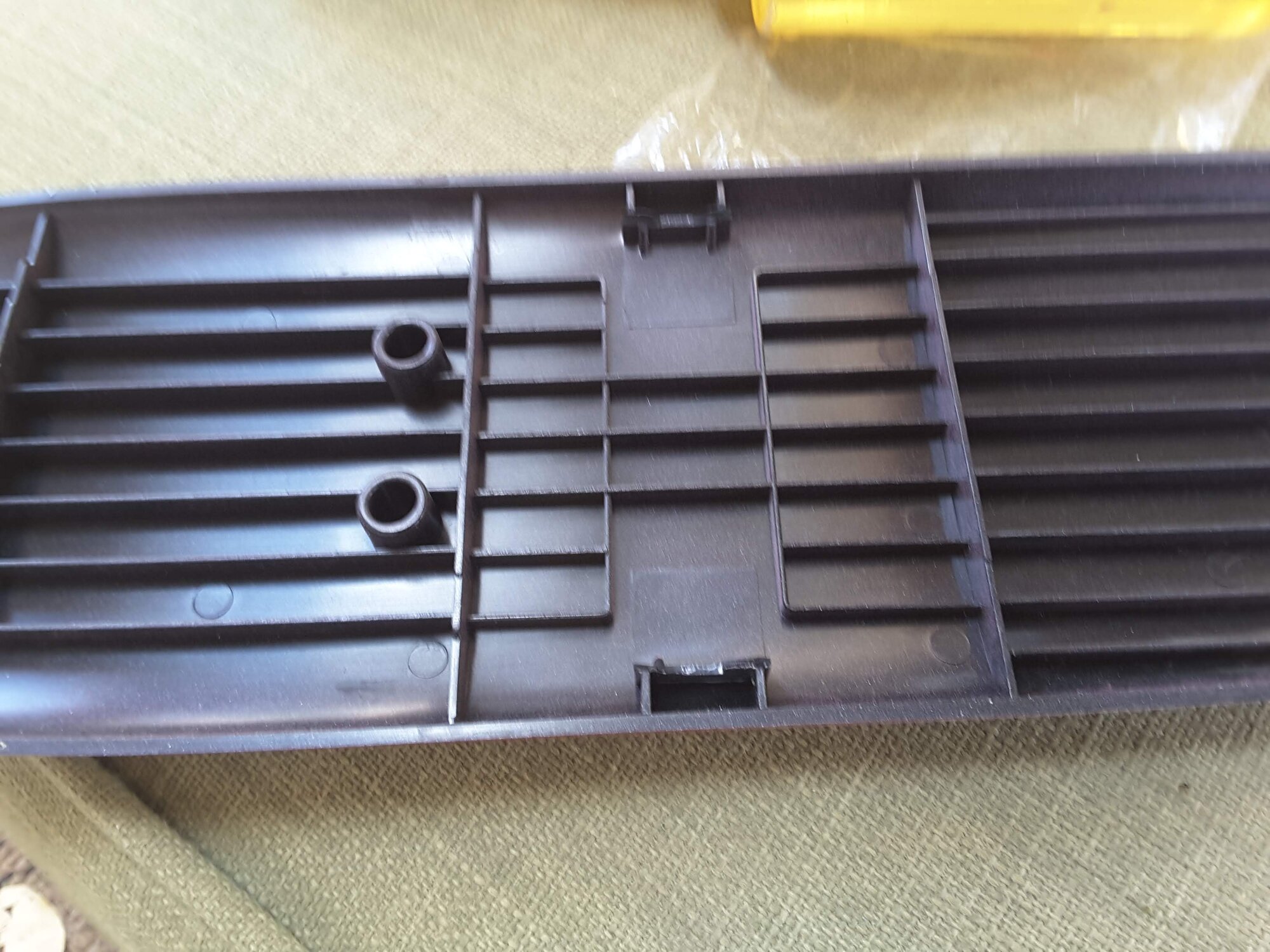

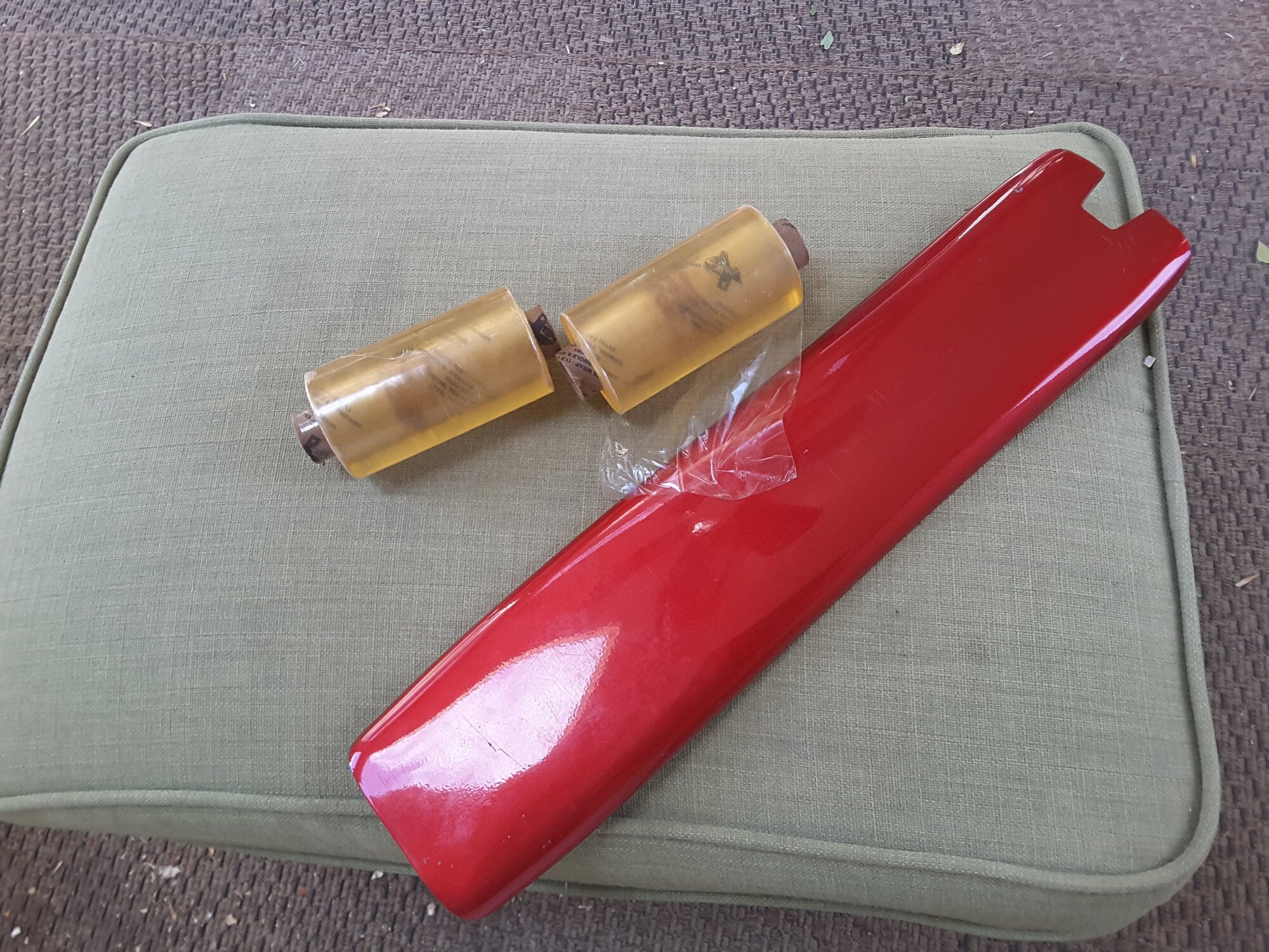

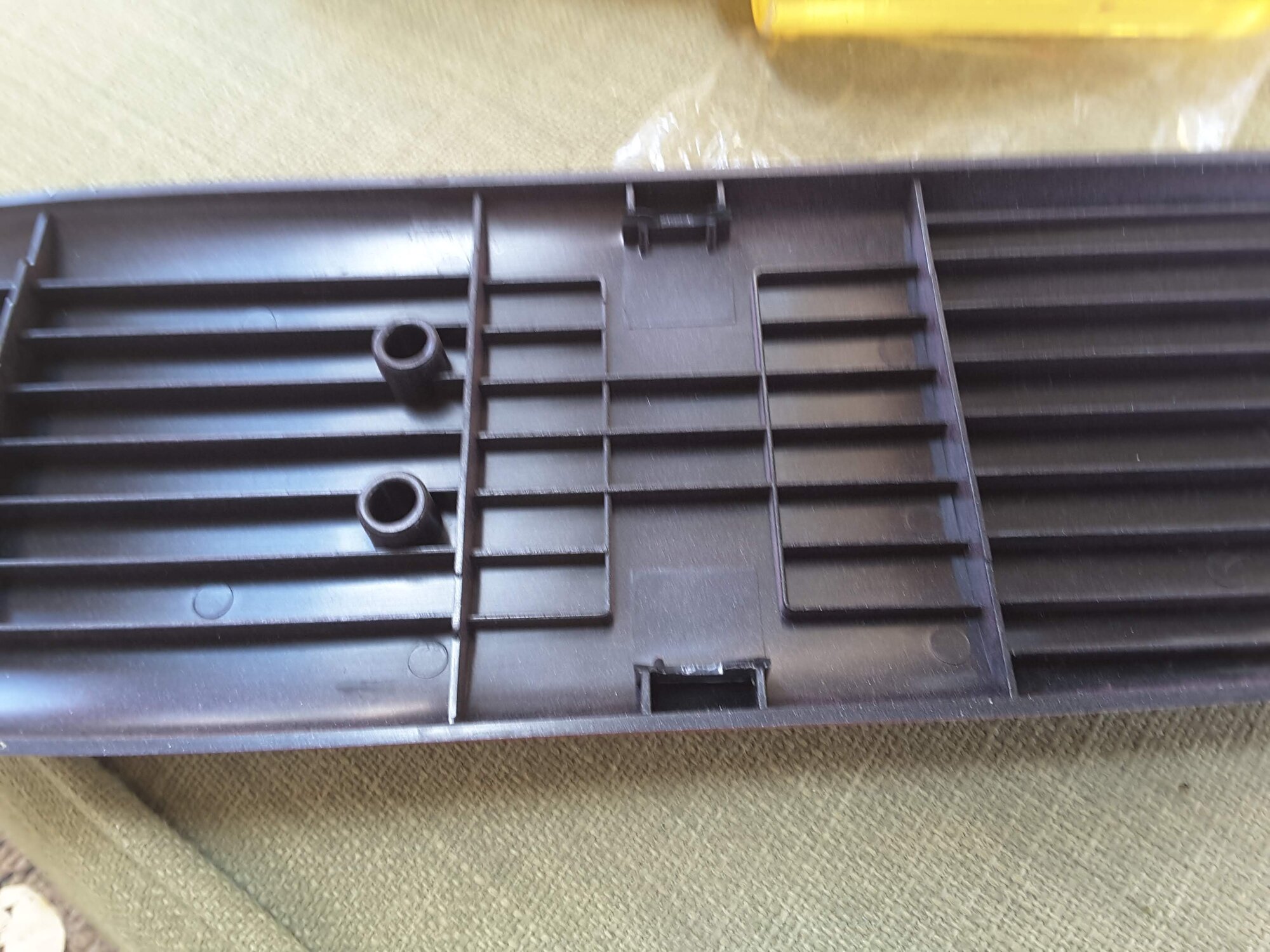

Since I last posted I changed bikes and methods. My new bike, had a damaged battery cover (broken mounting tabs) which was replaced on warranty. I use that with some industrial cling film (5" wide rolls) that I use to wrap key components/areas. I have some wrap left over from 30 years ago... it's previous use in the last 10 years was as shower protection for post leg surgery .
View attachment 69936 View attachment 69937

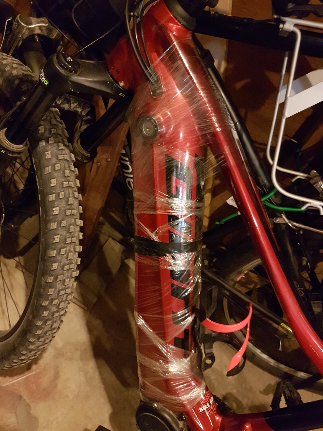

Battery comes out and extra battery cover goes on. It's then wrapped, including the key lock for the battery area. I just use electrical tape to secure the final wrap.

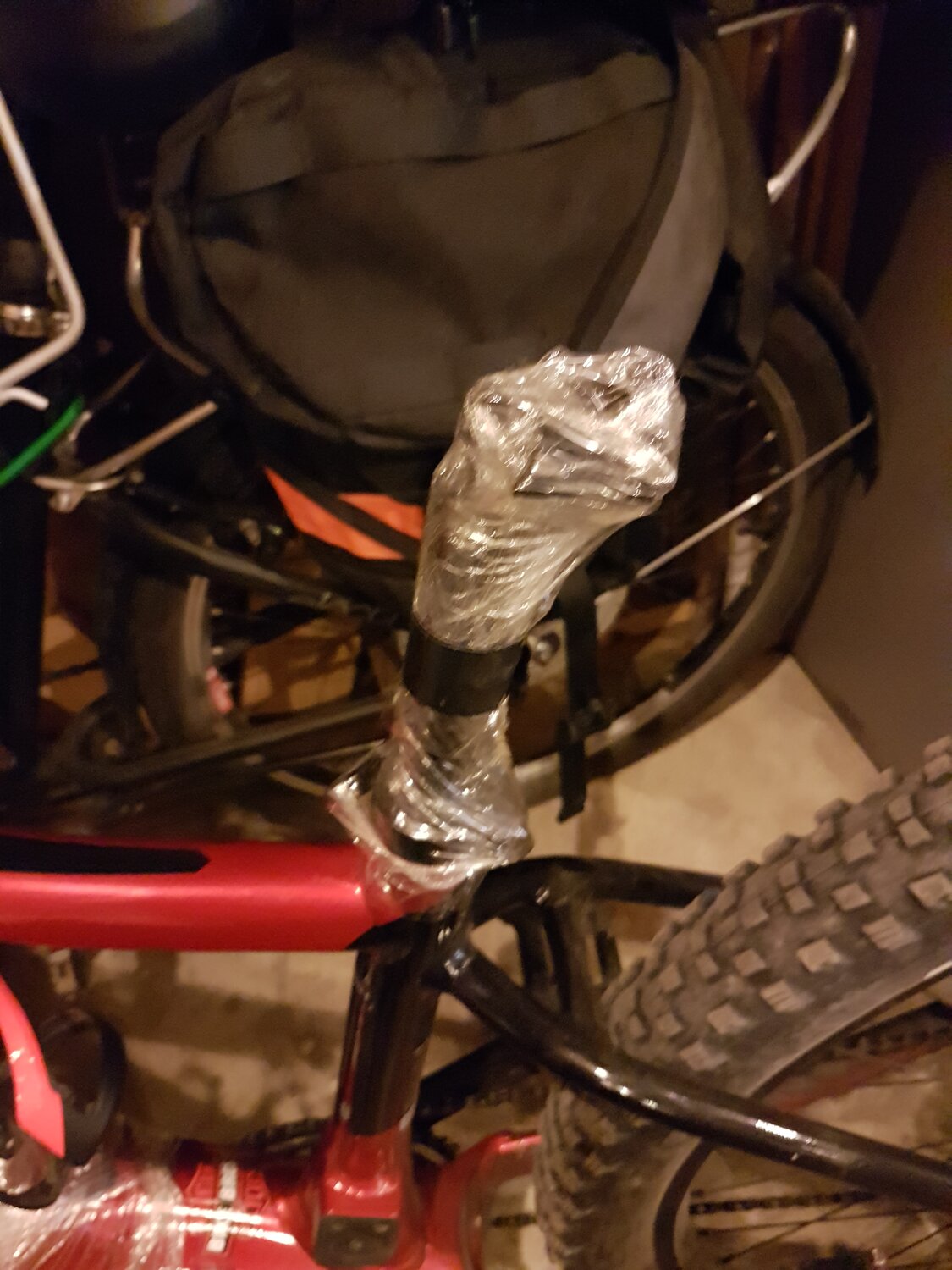

My suspension seatpost is removed, and the original one goes back in and is wrapped to stop water and dust ingress.
