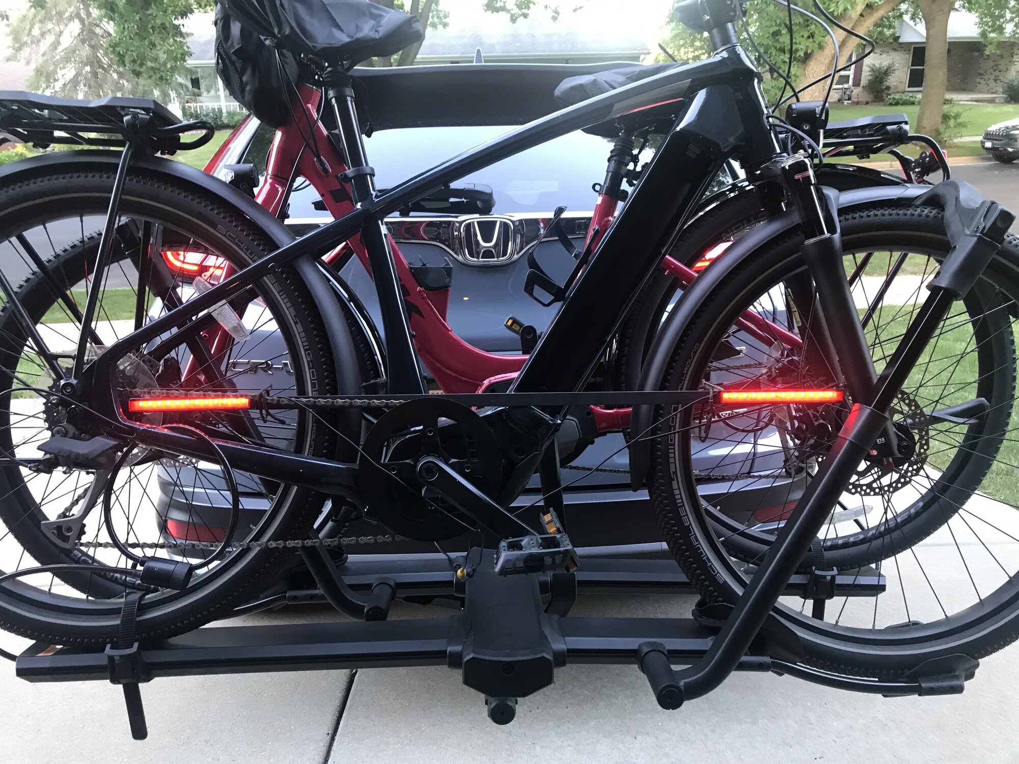

Keep in mind that your vehicle’s brake lights will not be visible. I made a light bar that I strap to the outside bike and plug into the vehicle’s lights. I use this whenever I transport my bikes. And, every state requires your rear license plate to be visible and lighted. That is another bracket I made but don’t always use.
Good point about the lights. Also in many states now they're cracking down on invisible license plates. Consider getting a license plate holder for your bike rack and make sure it has lights cuz that's a part of legality too. Thule makes a great license plate holder with a two socket license plate lights

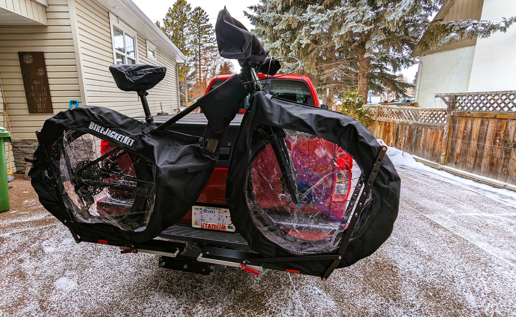

I use a two-part cover mainly to protect my fatbike during transport when road crud can do a nasty job with messing up the bike’s exterior as well as its drivetrain components. The rear and front pieces simply zip off and can be easily rinsed off afterwards. The company also sells seat and handlebar covers but I purchased ones through Amazon which work quite well. The bike jackets, which are available in two sizes, fit snuggly enough so as not to incur much wind turbulence and the clear windows over the wheels allow the brake lights to be visible. These are not cheap covers but I figured that it’s worth protecting the investment on the back of the vehicle where most of the damaging elements get thrown up. The covers also have built in HD inner liners to protect them if your bike is shod with studded tires.
