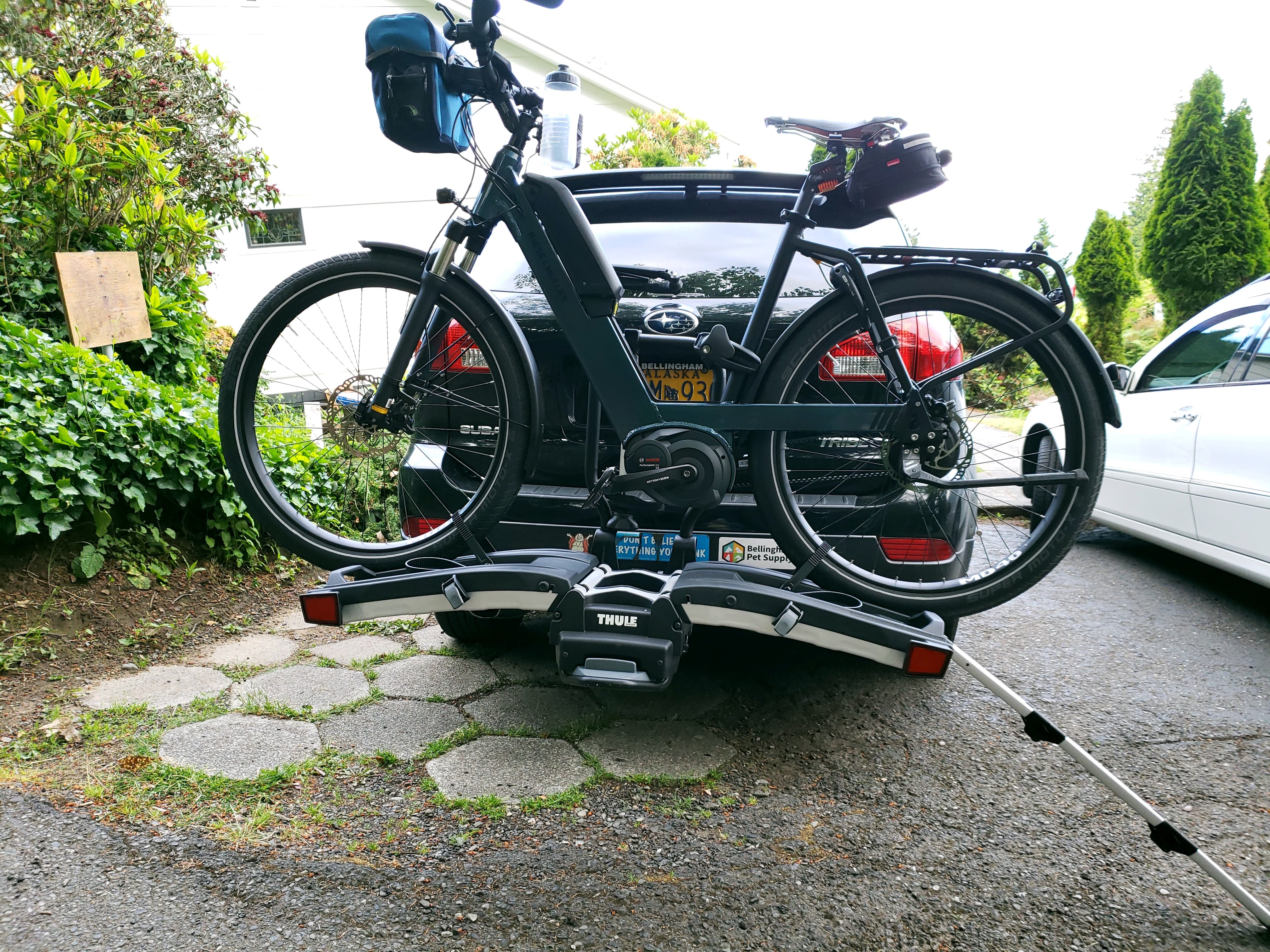

This rack has a total capacity of 132 pounds or 60 kilograms, sufficient for most if not all ebikes. Rather than hooking onto the tire in front of the fork, it clamps onto the frame which makes if far more secure on any bike with fenders. In addition the locking mechanism disables the tightening knobs rather than using an easily cut cable. It also has a folding ramp that you can deploy to roll the bike up onto the rack rather than having to lift it. The ramp stows in a compartment in the middle of the rack.

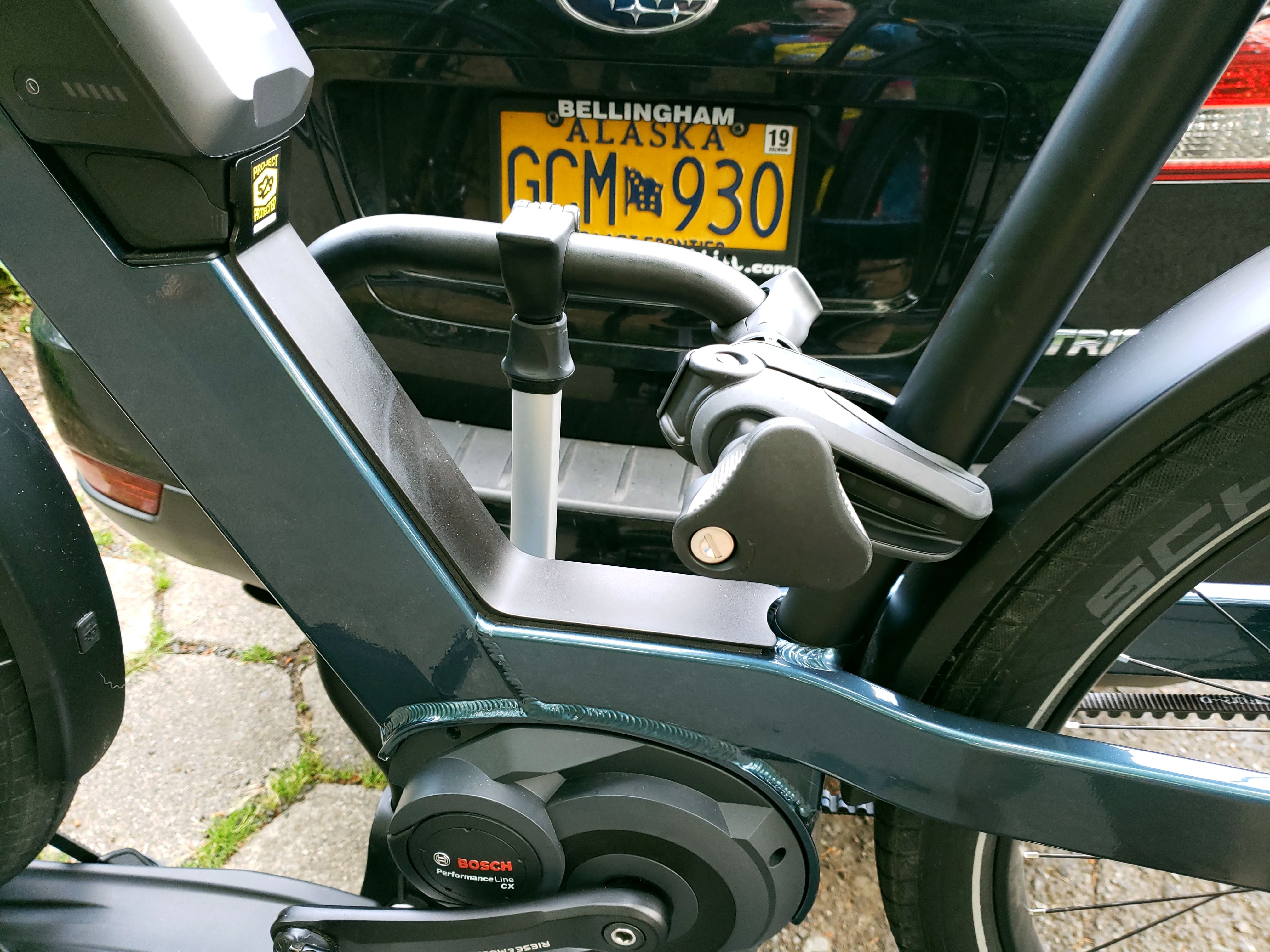

Here is a close up of the clamp on the seat tube showing the key slot on the knob. Once locked the knob just spins freely.
I watched a video showing off this rack and it does look very good. Very well thought out and I liked how easy it is to install the rack into a hitch receiver, and how easy it is to tilt the rack back, out of the way of the hatch.
However, it seems to me the bike locking system is easily defeated. The frame clamp arms are easily removed from the carrier. Here is the video queued to the point where the removal of the frame arms is demonstrated:
Is there something I am missing here @Alaskan ?
Drew ...
The collar (black in my photo) that allows the clamping arms to be detached from the rack can only be slid up the silver extension arm without a bike attached.
At the very beginning of your video, note how the jaws are squeezed closed (impossible with a bike clamped in them) when the demonstrator first removes the attachment bar. It takes just a few seconds in the video:
  • 4:00 - clamp attaching arm to rack locked by collar; jaws open
  • 4:01 - clamp opens when collar pulled up silver arm; jaws close (impossible with bike attached)
  • 4:02 - clamp left open but collar springs back allowing jaws to open again.
My photo is the equivalent of 4:01 in the video - the black collar has been pulled away from the bike rack to release the clamp (shown slightly open); as soon as the entire clamping arm is removed from the rack the collar will spring back (exposing about twice the amount of silver extension arm) and the big jaws below the tightening knob will open wide. (Photo taken with tightening knob fully unwound.)
... David

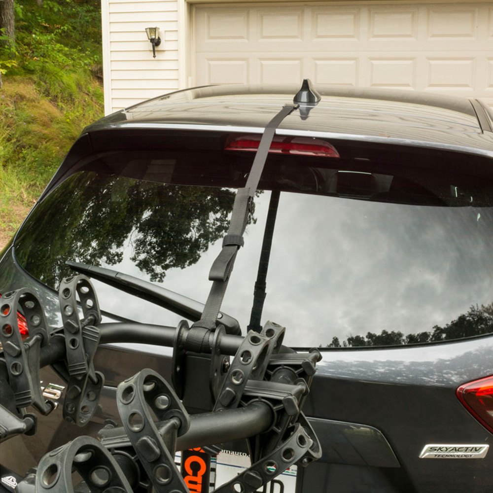

Based a recent ride with friend @Alaskan, I was intrigued by the Easyfold XT2. I got one last week, and I'm surprised and delighted. For a couple years I've been using a Küat NV, it's well made, heavy and strong but I've moved that to my RV and plan to use the new Thule Easyfold XT2 on my every day driving vehicle along with the Curt support strap @Alaskan references above.
