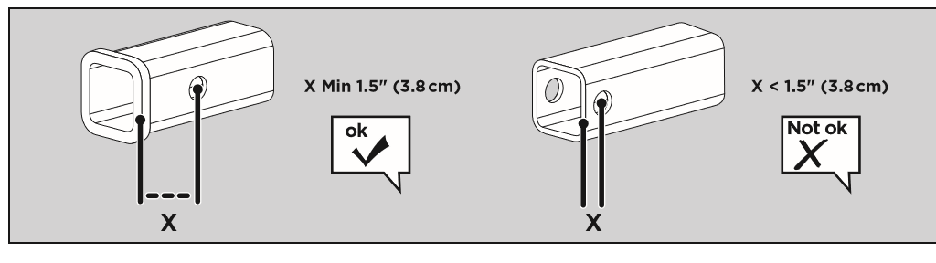

From the Easyfold user manual - the one on the right resembles mine:
I posted that quite sometime ago and spent a couple of seasons without a safe/functional bike transportation option. My Subaru dealer installed the 1.25" hitch shown on the right in the Thule diagram above. Per Thule, it is not to be used with their EasyFold or several of their sturdier racks. I had purchased the EasyFold prior to having the hitch installed. I could not get my Subaru dealer or Subaru (opened a ticket with them) to recognize any deficiency in the part they were selling particularly when they partner with Thule and sell Thule products out of their showroom. Subaru actually said it was a Thule problem. I still used the EasyFold for short local journeys carrying one bike only and using a stabilizer strap. I looked at all options of adding extenders etc but nothing seemed to solve the problem above which relates to the location of the hitchpin hole.
