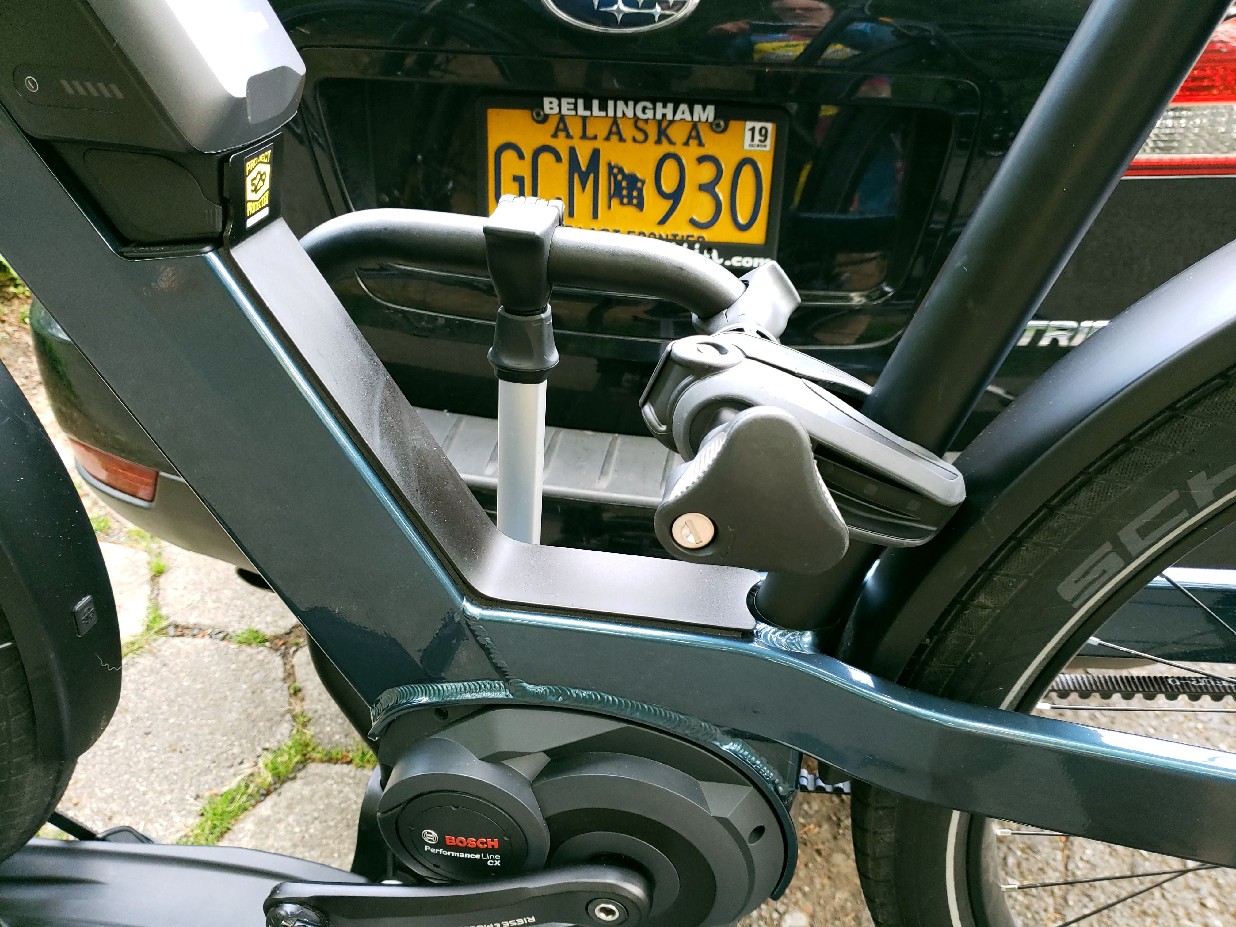

In addition the locking mechanism disables the tightening knobs rather than using an easily cut cable.
Here is a close up of the clamp on the seat tube showing the key slot on the knob. Once locked the knob just spins freely.

The locking mechanism is one of my criteria and while I know that nothing can deter a determined thief, could this locking mechanism be easily defeated simply by breaking the plastic clamp that attaches to the hitch U tube? I like this rack a lot but when it comes to locking, "a chain is only as strong as its weakest link" so I would think all metal locking is the only way to go. Also, in what may or may not be related to this, a reviewer on the Thule website reports that their bikes were stolen by someone simply jamming a knife in the lock to defeat it, (plastic?), so be aware. Any insights on potential easy plastic break points of the clamp/locking system or am I misunderstanding how this works?

The exterior of the clamp is plastic and rubber. Given the force with which it grips the frame, I am certain the framework, hinge, etc. Is metal. Give me a cordless skill saw and I'll defeat any rack's security.
Thanks Alaskan. Totally agree on the skill saw but it is the screwdriver or hammer that I think most of us are concerned about.
