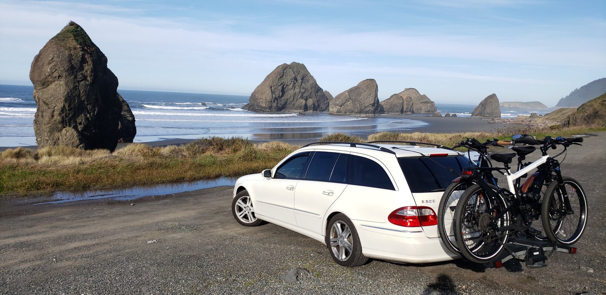

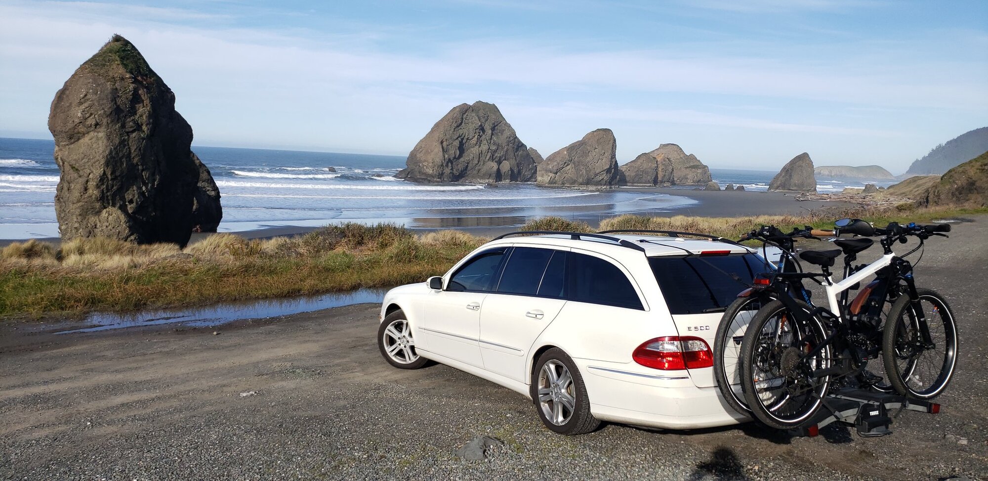

I’ve had my Thule (not the easy fold) now for 2 years
If I had to I would buy again as these are really solid, easy to use and a very reliable carrier
The fold down feature of the carrier allows access to the cargo area, even with the bikes on
Solid, Convenient, durable, easy to use. Two years of regular use including two 3,000 mile trips to California and back from Bellingham, WA.
