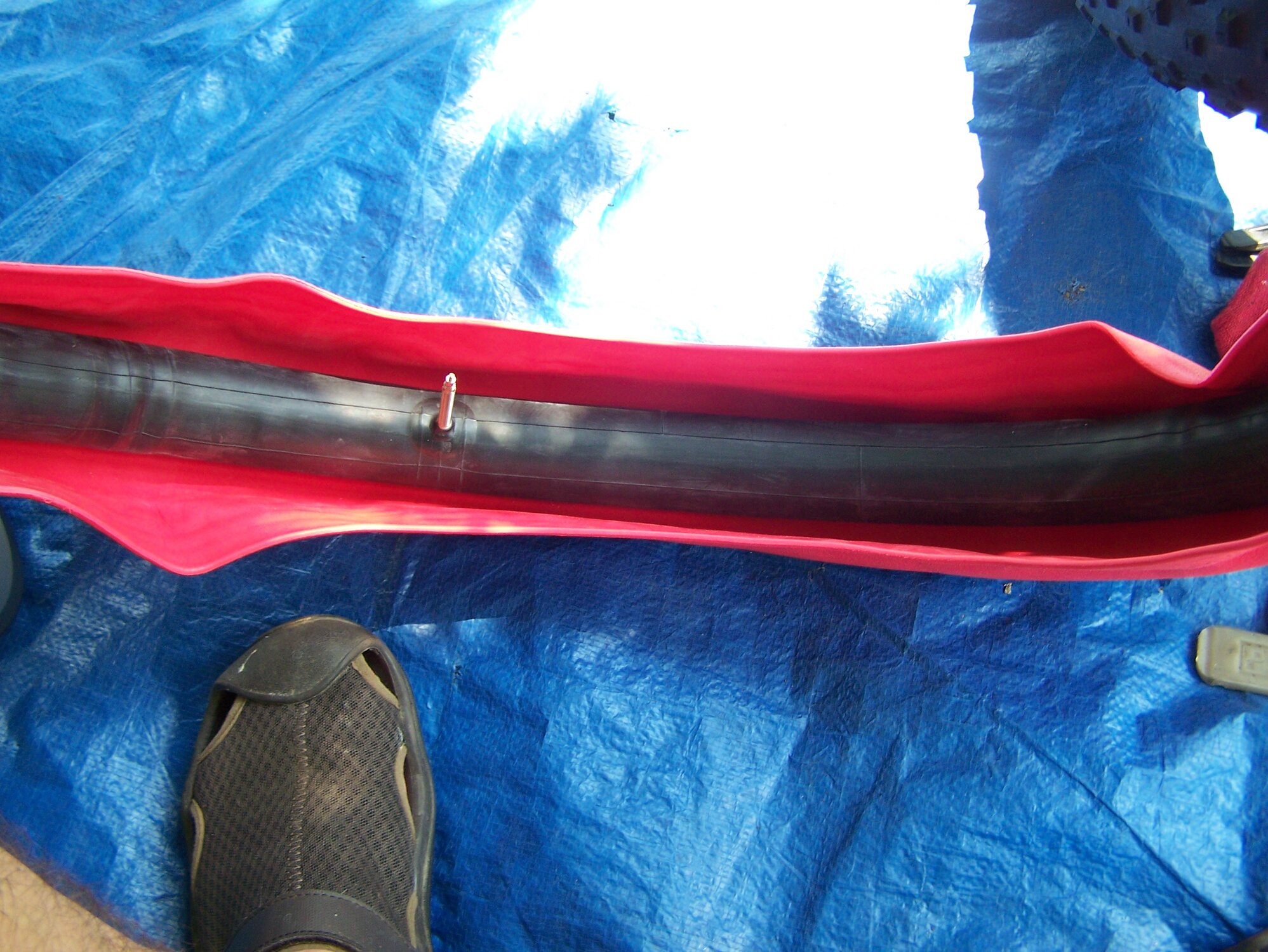

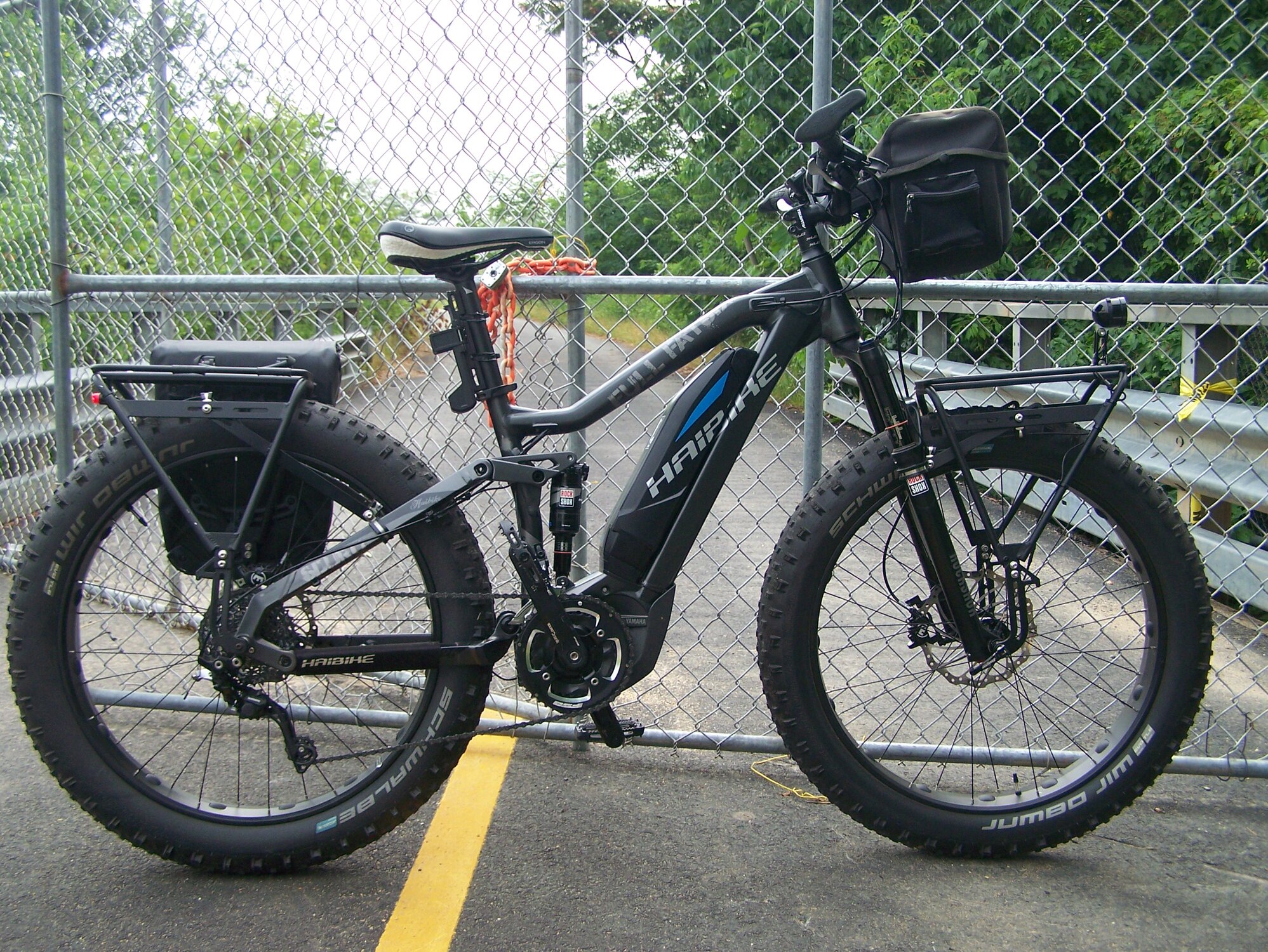

Here are a few pics of mine, installed summer 2020. Haibike Full FatSix, 26 x 4.0 tires. Checking out many online bike supply shops and I find severe shortages of just about anything and everything these days thanks to the covid virus disrupting the bike supply chain. But of course, it would be great for the Tannus America folks to chime in to let interested ebikers know when to expect new stock to arrive......
never it seems, i dont think even one of our members has the tannus fat tire armor even though we have high interest/cant get them
View attachment 73555View attachment 73556View attachment 73557
Sweet! How are you liking them? How’s the ride? I’ve been wanting to get some myself but they are never in stock.
I did catch a rear flat in October, a 1/4 inch thorn. I run my tires on hardpack and asphalt roads at 20-25 psi in order to get the best battery mileage potential out of the charge, so I'm still susceptible to flats. The thorn barely made it through the T/A, but it did. Repairing the flat was no greater deal then any other flat I've gotten in the past (and for the riding I do, I get my greater fair share of flats) I've tried everything, from tubeless to Mr Tuffy tire liners and now the T/A's and I guess with just the one flat in several thousand miles of riding, I'm happy with them.
Be advised, their literature for the Fat Tire T/A's recommends a 3.0 inch tube. When I recieved them, I got tubes sized 2.4-2.8 inch. I wrote back to T/A about this and they promptly replied back that these smaller tubes worked for them with no issue. Mind you, I do not often run at 5 psi or lower in sand or snow these days simply cause I'm not in those areas that require that kind of tire pressure. But I have questions about rim strikes at such a low pressure with that small a tube inside that tire liner and rim...just something to think about. The other thing to consider is that these questions are raised to a higher level if your rim is 100mm (mine is the smaller 80mm) and you are running a 4.8 inch tire.
3.0 tubes in a presta valve simply are just not out there, either due to Covid or just not manufactured. And no, you will NOT fit your old fat bike tube into that liner and tire casing....I tried! And don't try to ride on the flattened tire. I did with that flat, but only for a small amount of feet when I got the idea that I'm gonna bend my rim if I go any further. They are not Run Flat's on our heavy fat bikes.....

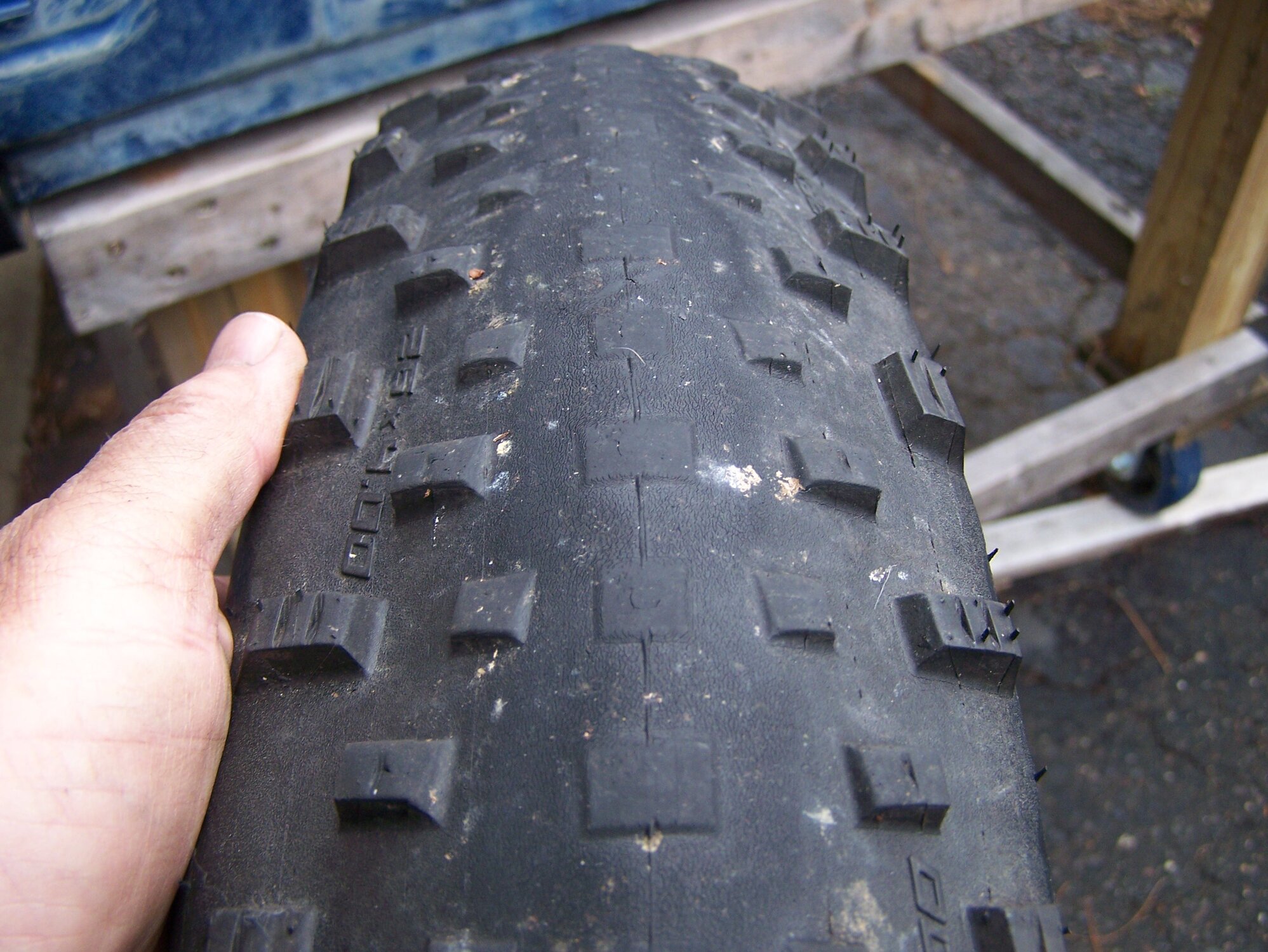

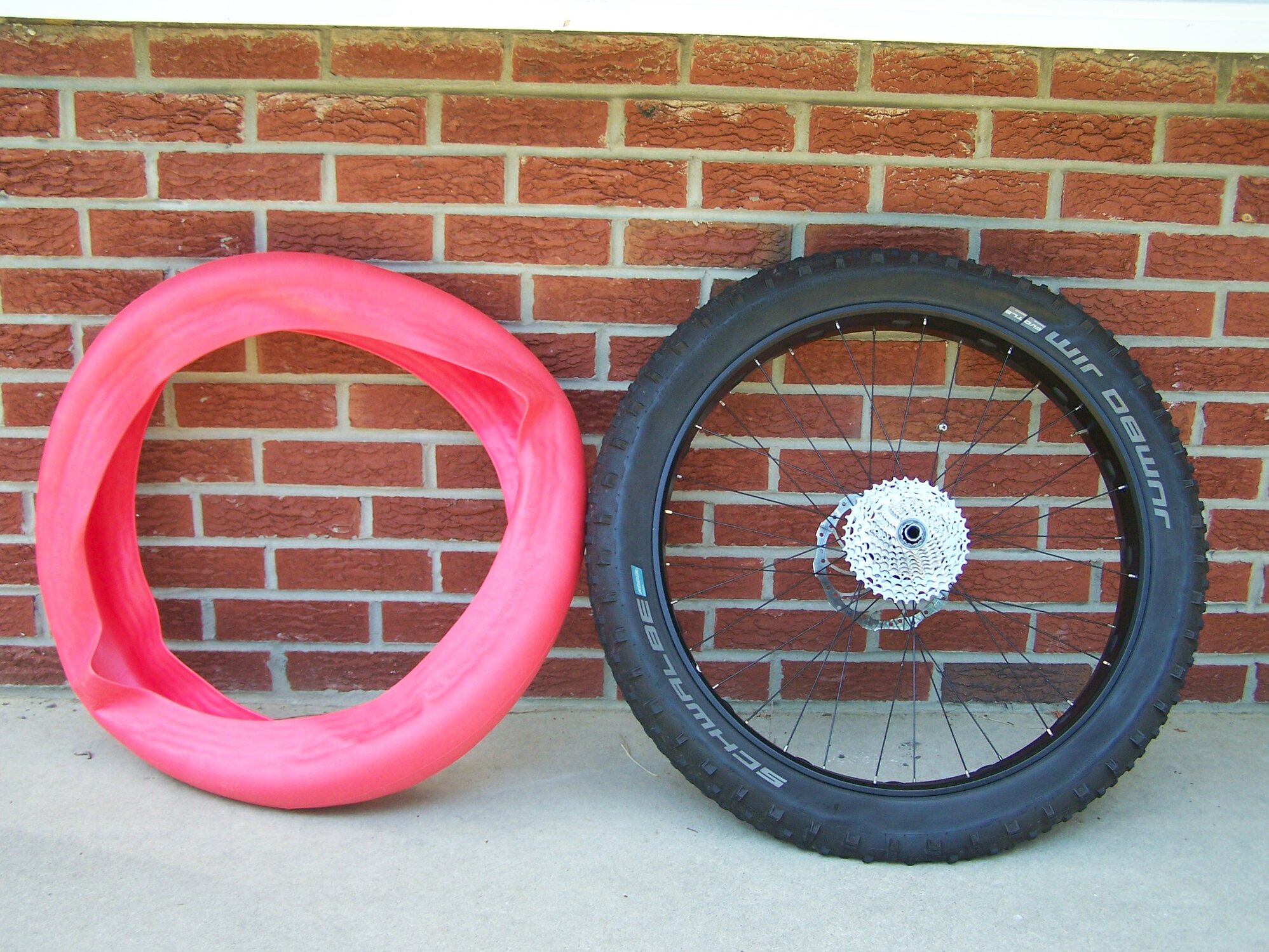

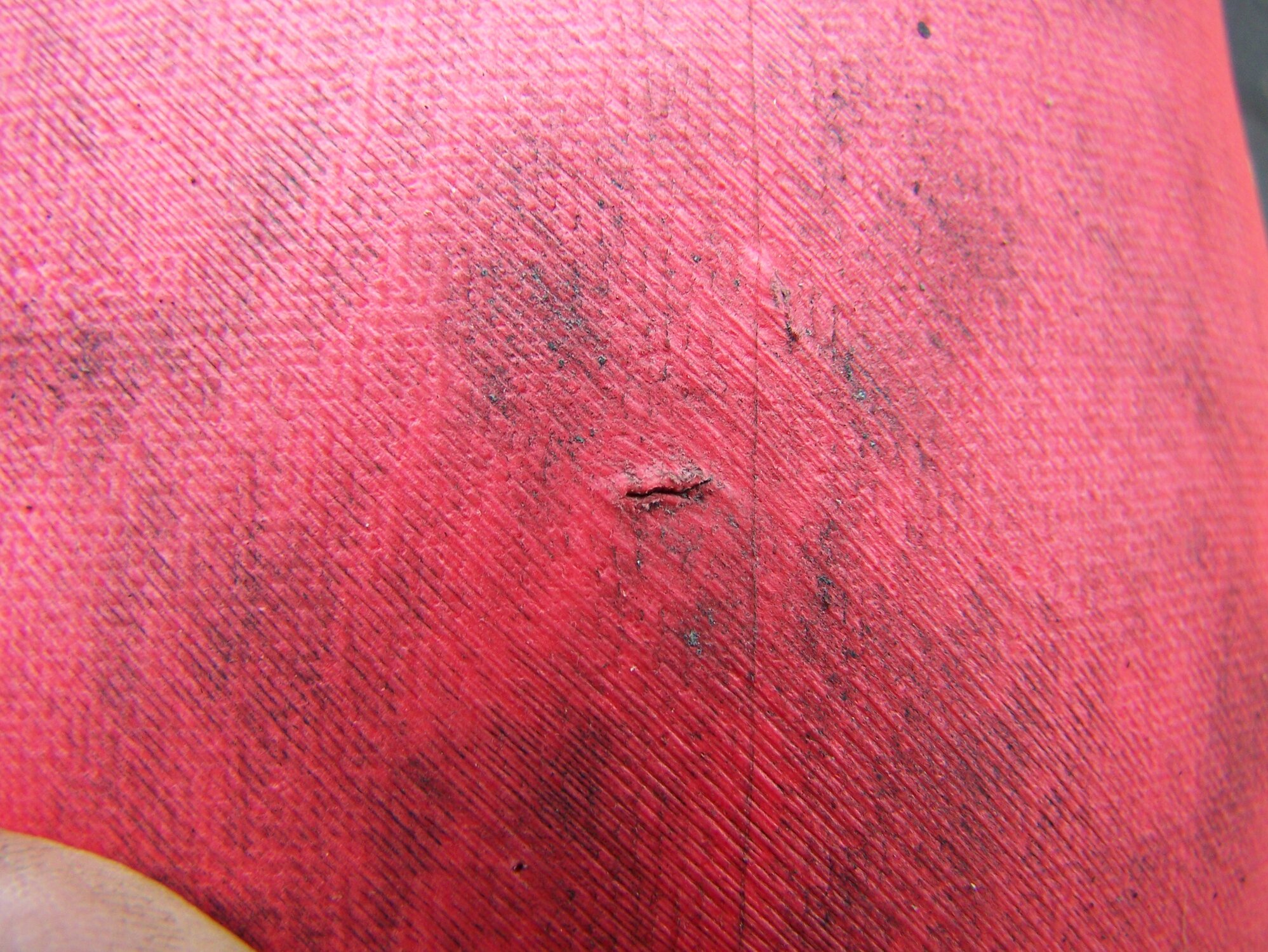

My post #7 here, back in December 2020 found me with a small thorn, flattening the rear tire on a road trip. This morning, going out for a 26 mile run, the rear tire was flat and the culprit was obvious; a quarter inch, arrow-shaped stone sliver that pierced the rear tire, liner and pricked the tube. No big deal, best to encounter this issues on the homefront than on the trail. Plus, it was a good time to replace the severely worn rear Schwalbe Jumbo Jim; itself replaced back in the fall of 2019. Estimated miles on the tire: 4 to 5 thousand. This summer, with the US premium fat bike tire shortage in full swing, I had to go to Euro bike parts suppliers to pick up 2 new JJ's. The front tire could use a change out as well as I see some small cracking in the sidewall casing, but the tread is good and I figure to ride this one out until late spring, 2022 or so. I was curious to see how the Tannus Armour held up for all these miles under 25 psi tire pressure, so here we go, some pics:
So this is what a Schwalbe Jumbo Jim rear fat bike tire is going to look like after some 4 or 5 thousand miles, running on predominantly asphalt road or trail surfaces at 25 psi. Pretty confidant to say I got my money's worth out of this tire and to push it further on some long distance rides away from home is just rolling the dice.

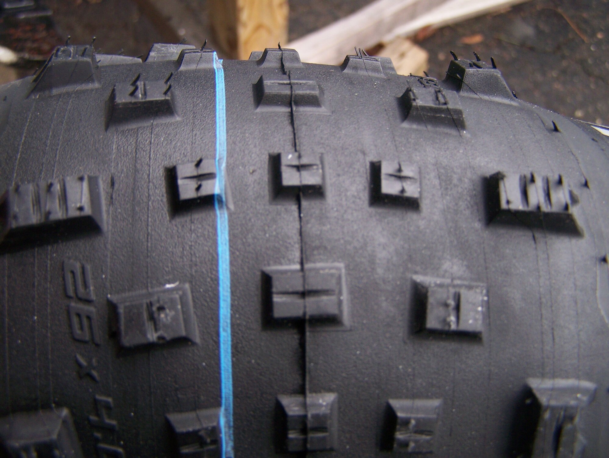

Brand new Jumbo Jim 4.0. Since Covid has disrupted the bike parts supply chain here in the US, I struck out trying to find a US seller for these tires, so I tried 2 different Euro suppliers for 2 new tires, (at separate times apart from each other this summer). I have to say, surprisingly, the price and shipping was not much different than what I paid Universal Cycles in nearby Lancaster, PA for the same tire. For this job, I will be using a new Bontrager tube, sized 2.4-2.8 inches, within the same T/A.

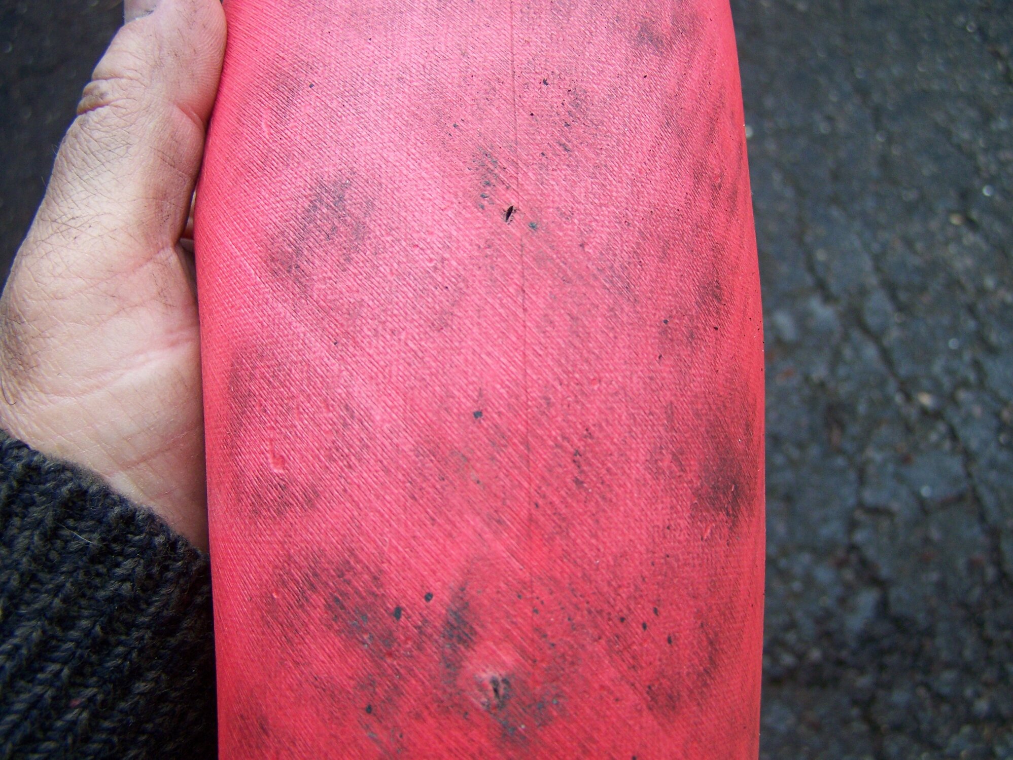

I was surprised to find several punctures on the T/A. In this shot, there are two, both near the centerline of the tire liner. Both about a good 1/8th inch. Nothing punctured thru on the other side as well as whatever punctured the liner, not found within the liner.
And here is another. So that is 3 in total here; not counting the actual puncture-thru into the tube as that picture was too blurry to post here. Total of 4 major punctures; one going all the way thru and into the tube. I will guess that one of these punctures I show here resulted in the fall, 2020 road-side flat.
Running my fingers inside the tire carcass found no thorns or objects stuck in the tire, so whatever caused these punctures in the T/A worked their way out of the tire during my riding.
I'm overall very pleased with the T/A's and now, with a new JJ 4.0 mounted, she'll provide another (hopefully) 5 thousand miles of service.
