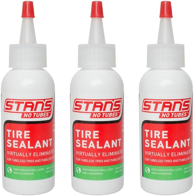

I've been using Stans Tire Sealant since 2016 with my fat tire ebikes with inner tubs. I proactively put two 2oz bottles in each fat tire (4 total) to help with goat heat stickers and cactus spikes. I don't notice or feel the extra sealant inside the tire as I ride (or I'm use to it). I keep a bottle in my rack bag. I sometimes run low inside the tires and have to add more because of Stans working patching holes as I go over months of riding.

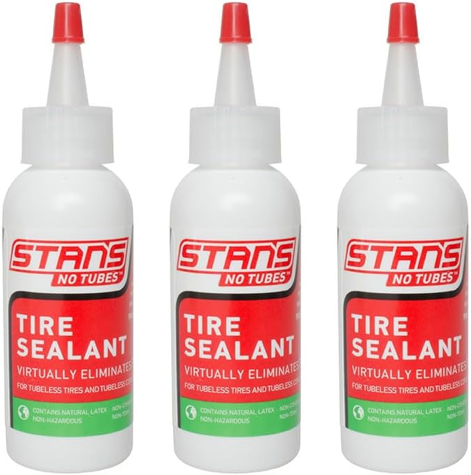

Tire and tube sealant by itself won't inflate a tire. You can easily tell because any product that will inflate a tire will have an attachment for a valve, and those bottles of sealant do not.
The best place to carry sealant is inside your tube, or inside your tire if you run tubeless.
One big downside of stuff like Fix-A-Flat is that with a bicycle tire, you might well never be able to inflate your tire with a normal pump after using it: the sealant can do a pretty good job of clogging the valve core. If your tubes have removable valve cores (not all do) you might be able to pull the valve cores, clean them, and be able to reinflate your tire. But no guarantees.
