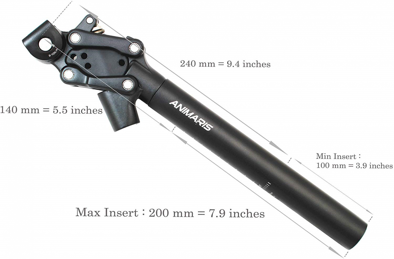

Alaskan, recently I had the opportunity to ride kinekt and let me say the built quality of Satori Animaris is on par with Kinekt.
I will write my detailed impressions later.
I'll look forward to reading your review. 'Twon't bother me a bit to be proven wrong.

Johnny Interested to read your write up, I actually have one of those satori sitting in some extra bike stuff that I haven’t even opened
Bought it to set up on a bike with a 31.6 post for friends to ride only to realize all the suspension seatpost make the bikes too tall for all my friends
I had to buy regular seat posts and extra seats for my short friends to ride
That is the only drawback to all these suspension seat posts and something to keep in mind for anybody on the shorter side reading this thread
The seat increase in height was one of my concerns but luckily I bought a slightly small frame because for sure I didn't want a heavy bike that is too tall.
The other problem that I notice many people have commented on, is the increased setback of the seat and even backward movement as its feature.
That is something I see as a "plus" due to the smallish frame size I chose. I want to have a little more setback and the necessary height clearance puts it right where I have the seatpost raised to now.
