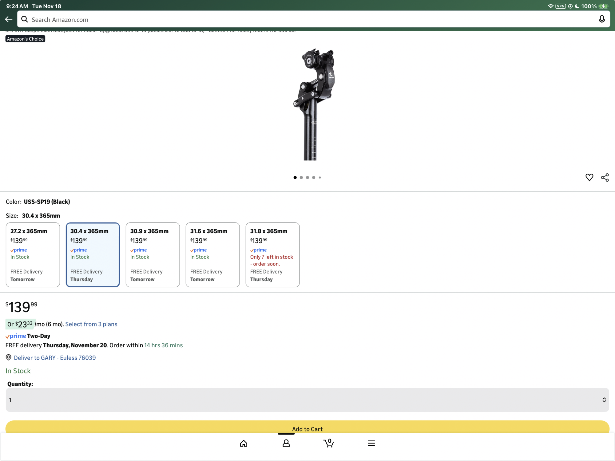

I do see some options for a 28.6mm but wonder if a 1/2mm or 1mm to 1.5mm difference is too much to properly fit the bike frame without a shim or sleeve of some sort?
Yeah, you need a shim.
It's worth the five bucks.

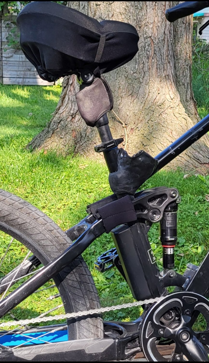

I recently replaced my 26" cruiser seat/saddle with something wider with a thicker cushion and recoil springs. I've seen some seat posts that are on some ebikes with some sort of recoil mechanism integrated into the post. Anyone using one of these seat post and do they actually work?

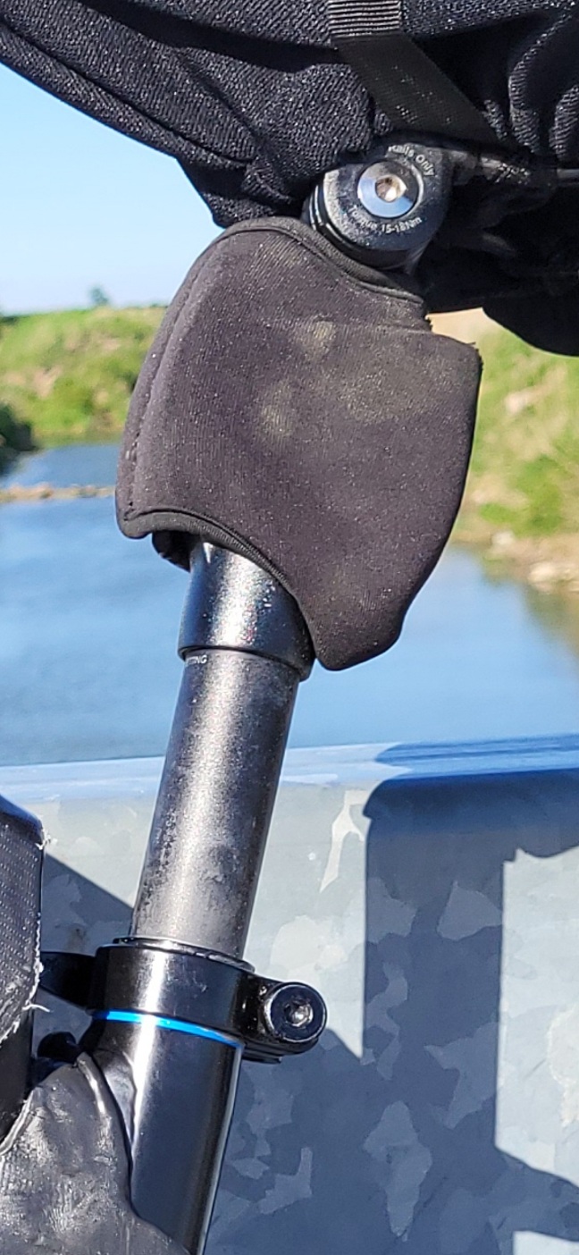

I've got a gell seat cushion on top of a Selle Royal Spring Seat, mounted on an NCX Suspension Seatpot, mounted on a full suspension ebike with downhill forks and 6 inches of travel.
I set my front and rear suspension to Extra smushy.
My ride is so comfy that I have to be careful not to nod off behind the wheel. 😁

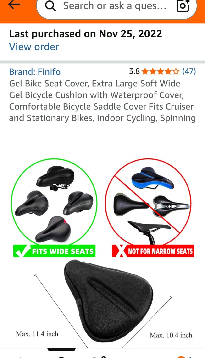

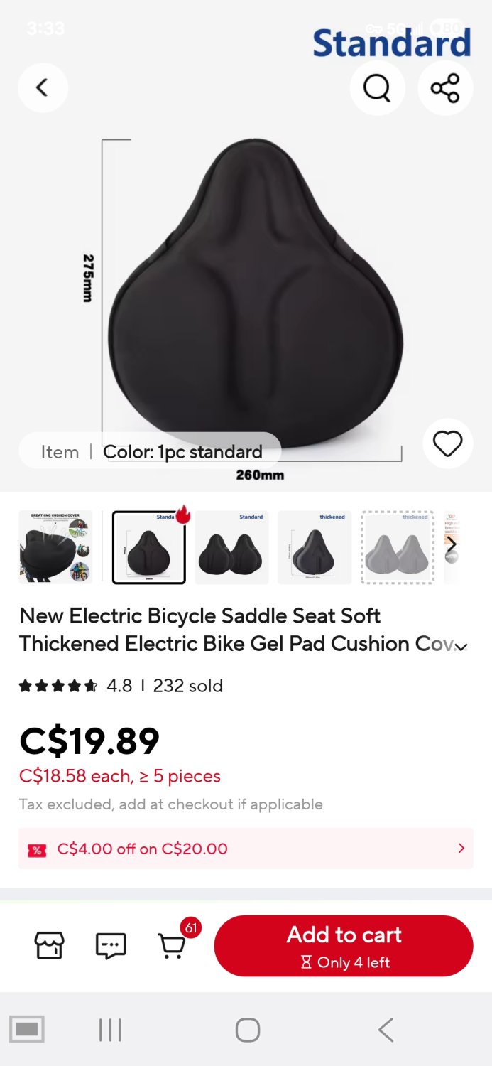

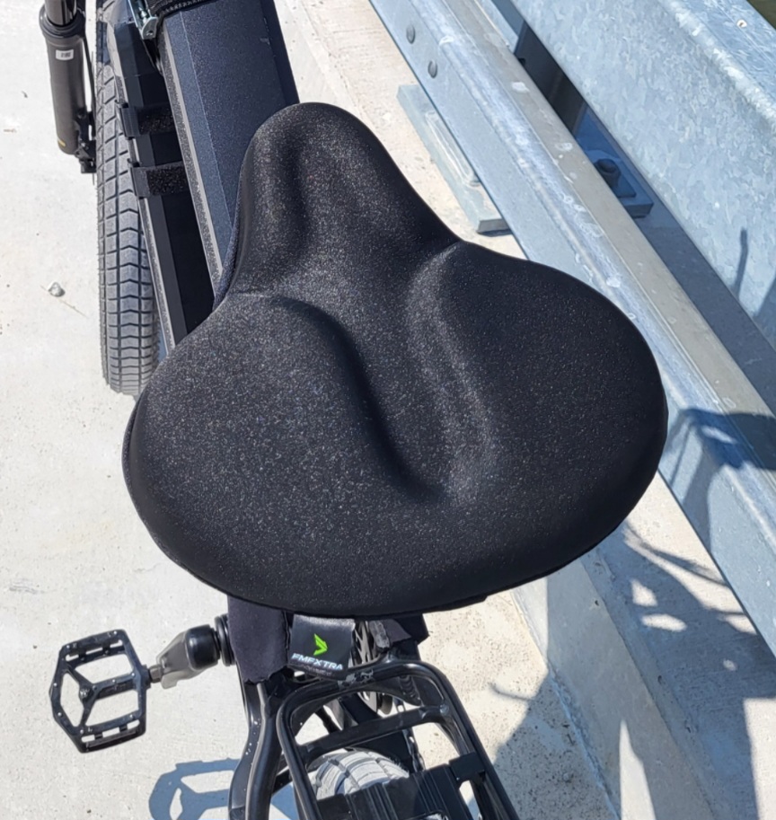

Where did you get the gel cushion?

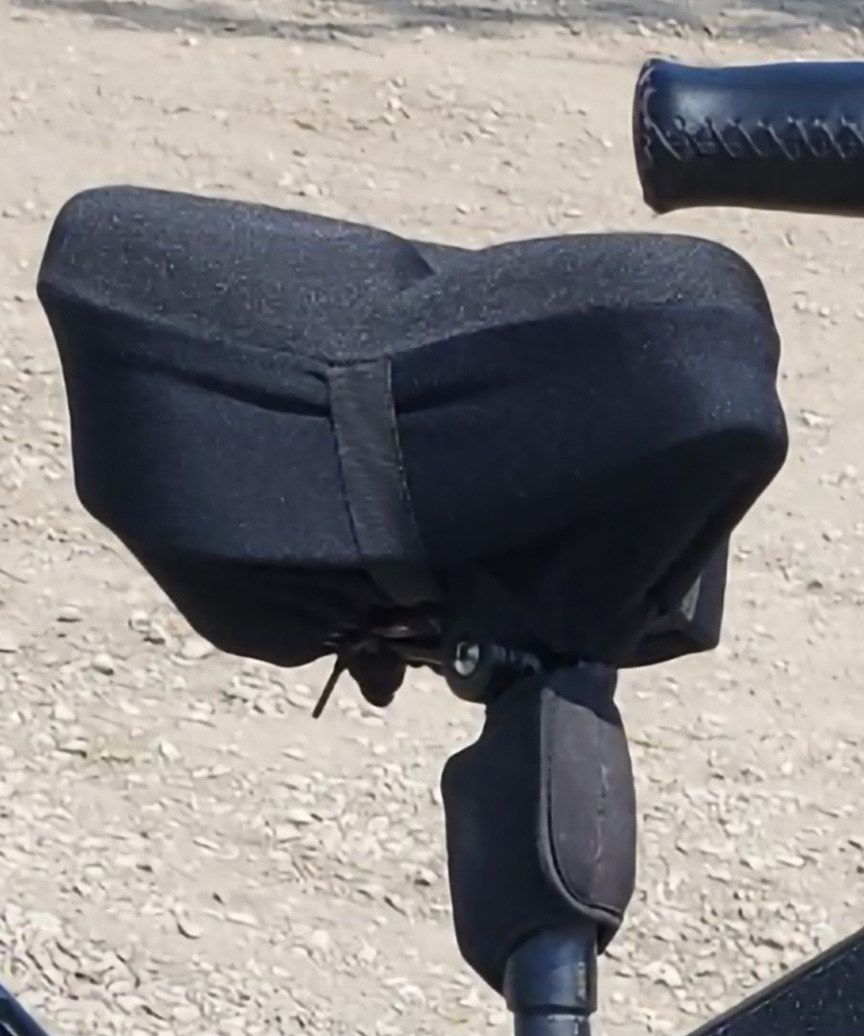

I got the first one on Amazon for ~$20 and the second one on Aliexpress.
The hardest part was finding one that would fit over my large seat.
Both seat covers were really tight to get on my oversized spring seat but they work well and don't slide around.
They have straps that tie around the seatpost and rails to hold the gel seat in place, as well as a pull string to sinch the cover tight around the bottom of the seat and seatpost clamp.

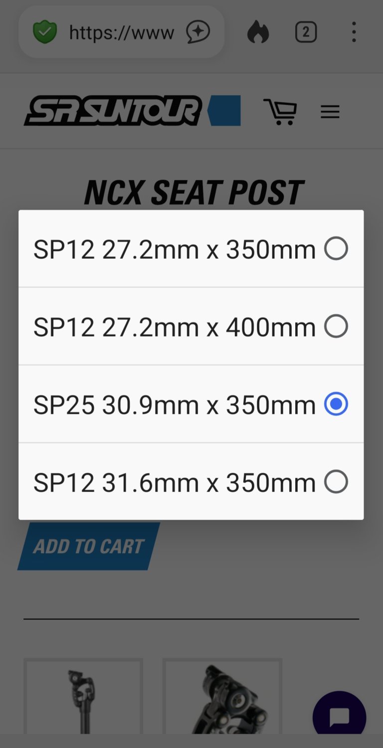

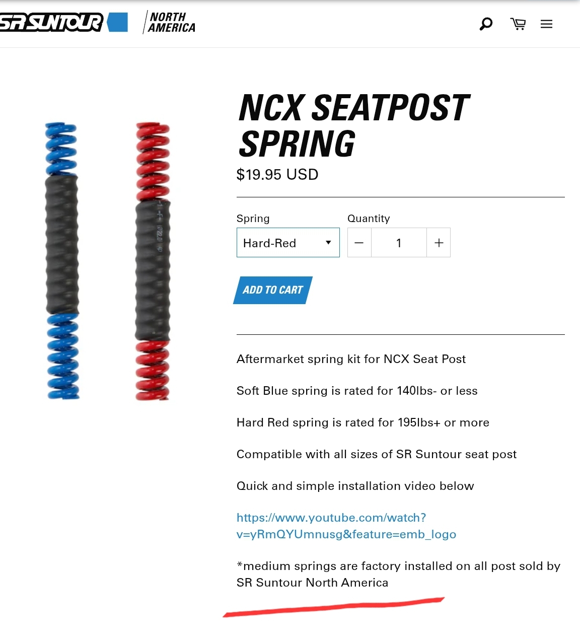

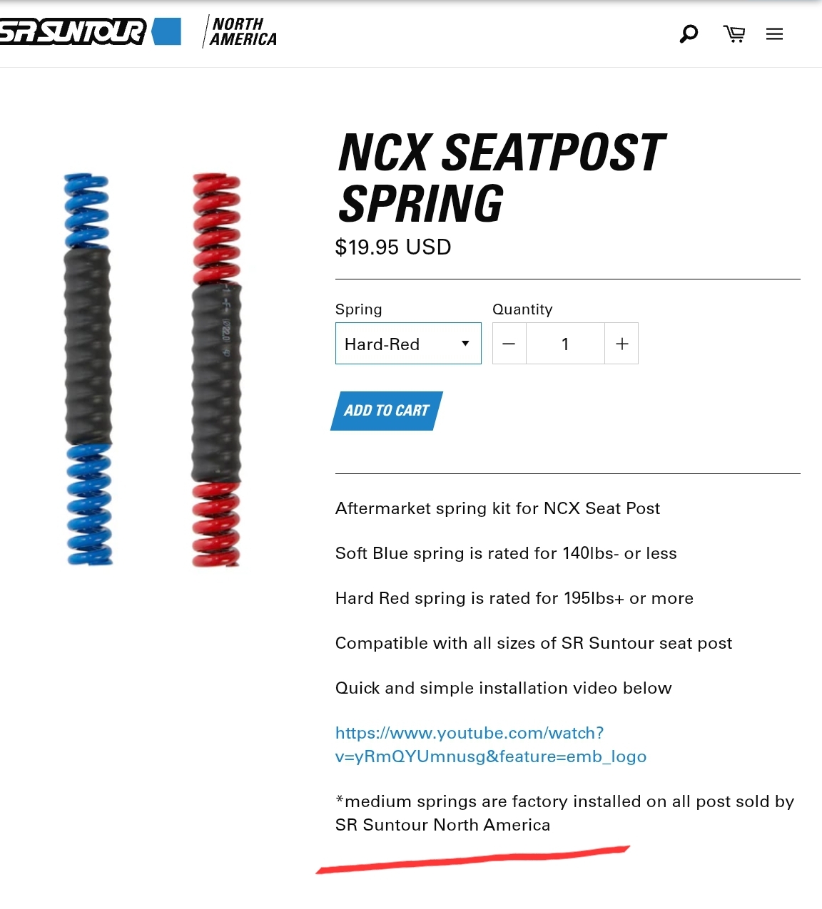

One thing to note about the NCX springs is that I found them to be over rated weight wise. I should have been perfect with the stock medium spring supplied when purchased weighing in @165lbs ...but after switching to the Blue soft spring I found it much better on smaller bumps and without ever bottoming out.
ymmv
Another thing to note about the NCX Suspension Seatpost is that there are two sizes of spring diameter.
The SP25 with a larger post diameter has a wider spring, and a replacement spring may use the smaller diameter original spring with a larger diameter black sleeve around the spring.
The sleeve keeps the spring in alignment, and provided the damping by adding stiction to the movement to prevent a pogo-stick bouncing movement.
So a SP12 spring will be sloppy in a SP25 post unless it has the proper sleeve on it, but a SP25 spring won't fit into a SP12 post.
(IIRC, you can buy a sleeve to add to a SP12 spring to convert it into a SP25 spring?)

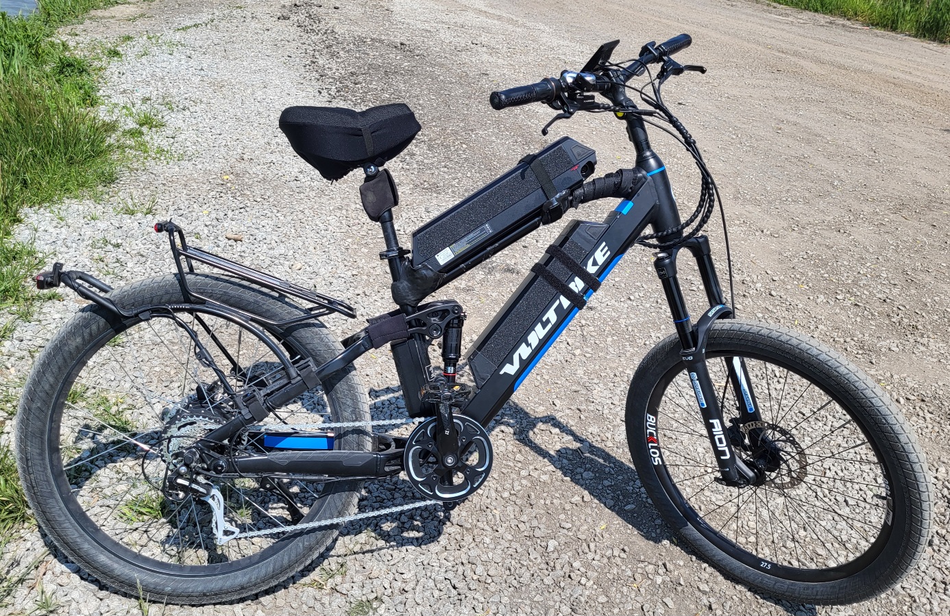

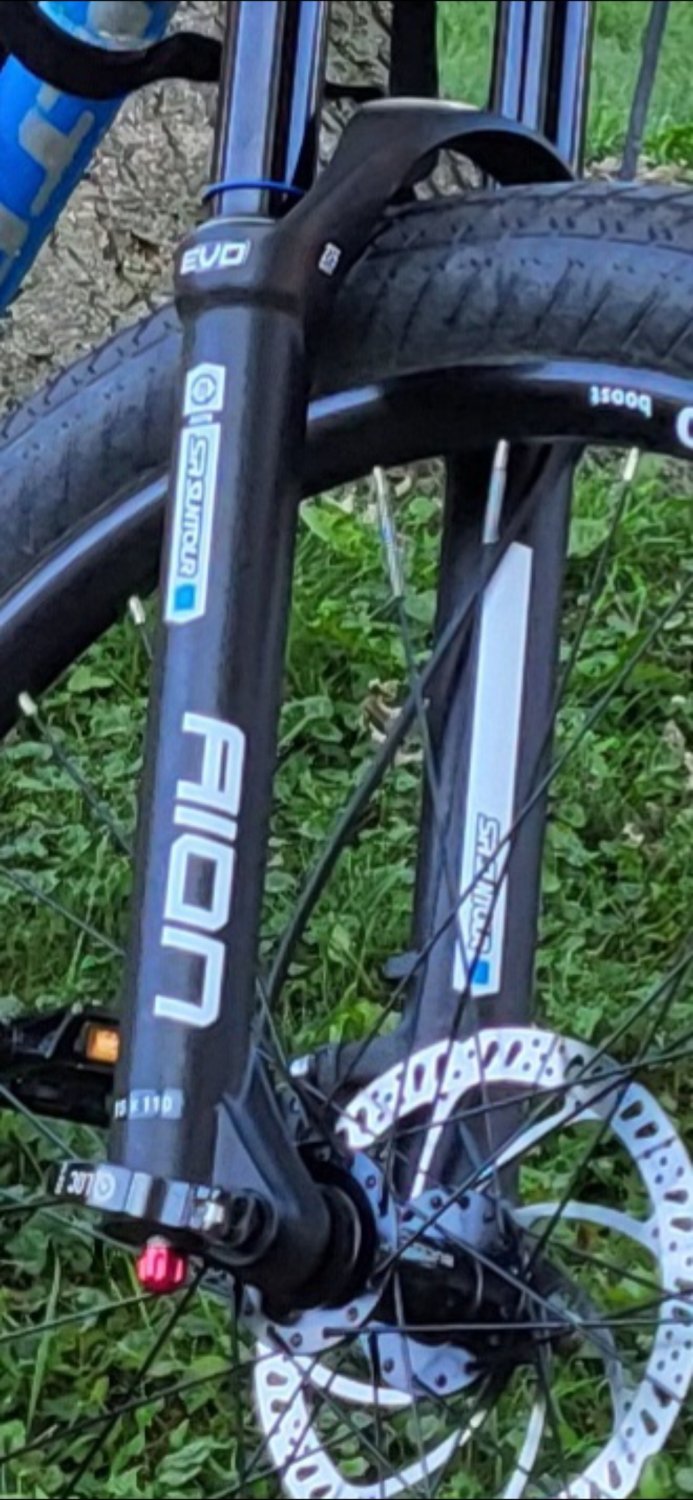

Buy quality forks, cheap versions are just heavy and prone to severe stiction.
I added Suntour downhill air forks with 160mm of travel and I've got a Rock Shox rear air suspension.
An NCX Suspension Seatpost with a spring seat, and a gell seat cover.
