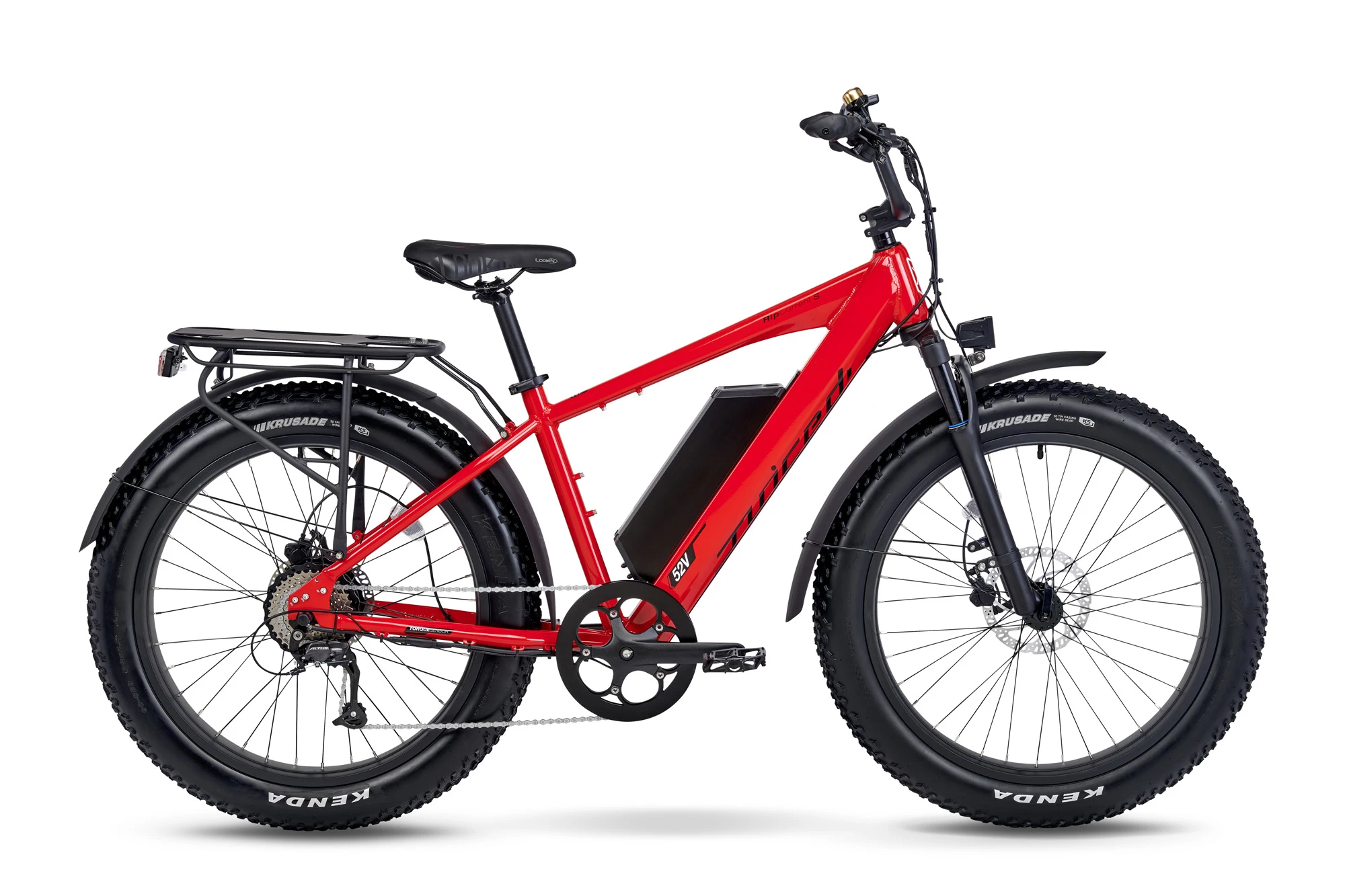

Juiced Rip Current S is also one you may want to check out.
