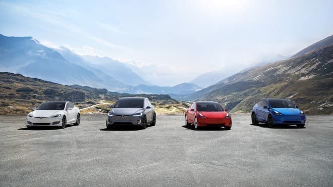

Iron phosphate batteries will increase range of Teslas.
Their new batteries would allow electric cars to travel for 400 miles or more before needing to be recharged and would be super durable, lasting as long as one million miles in its lifetime. The impact of this innovation on the EV market and the future of the EV industry would be hard to overstate. “That could spur EV sales the same way the first 100,000-mile warranties on gas cars once did,” writes CNN.
Example of long distance travel in a Tesla. Supercharging seems to make a profound difference.
