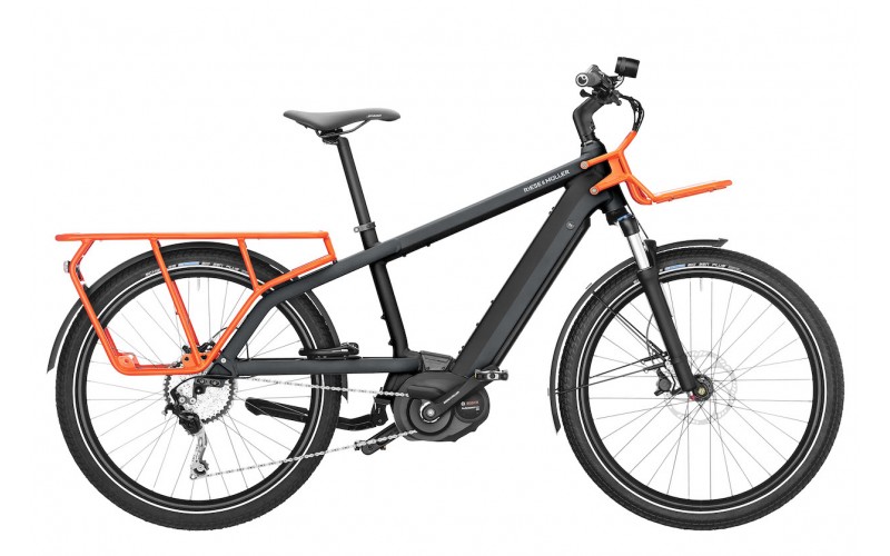

Check out this Riese & Muller Multicharger. Built to carry the weights and no cart needed. They make custom pannier bags for their oversized integegrated rear rack and there is a front rack too. The frame has a lower top tube for easier mounting. It has the Bosch motor, the most powerful in the line which, given your weight and all the gear you are carrying would be a real plus as well. They are near London Bridge and have a full range of ebikes that can be test ridden. There is no substitute for test riding a bike to determine its suitablitity.

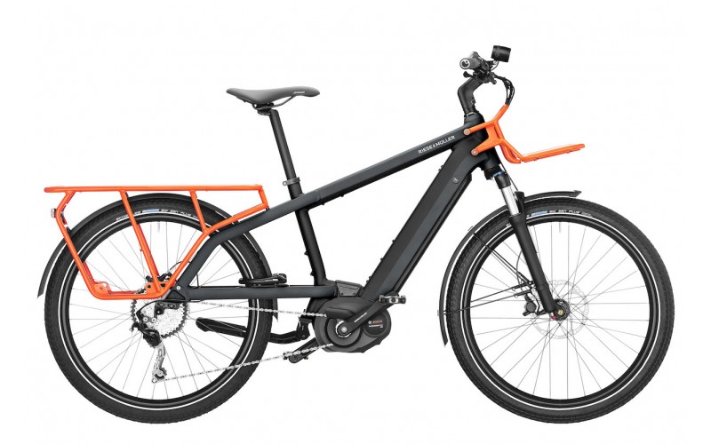

Thanks for that pointer!
This, at least, is a brand I've already heard of, though I understand that they define the term "premium", ha ha. I didn't know that they had a London shop, I'll definitely check them out (I'm sure you're right: a test ride would be invaluable).
One thing I'm learning from all these replies: my "upper" budget was wildly optimistic, LOL.
