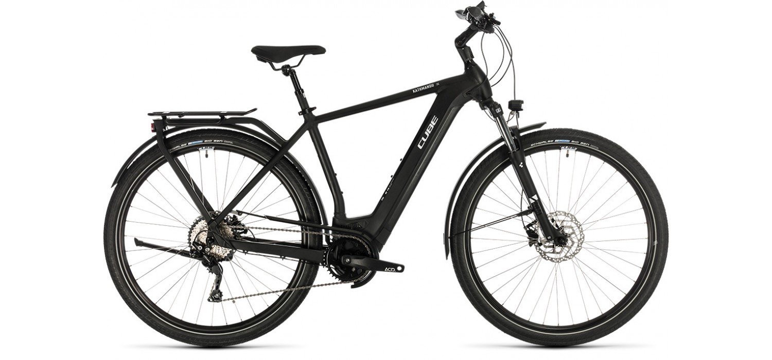

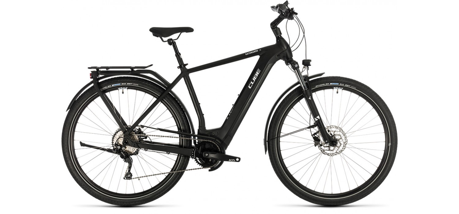

Cube Touring or Kathmandu have 140Kg max load, again not so great carrying capacity with a 120Kg rider

In perusing other bikes at Fully Charged, I noticed that they carry Cube. That is a solid, well made German bike, not quite as robustly built as Riese & MUller but still worth a look. Their Kathmandu model is well equipped ebike with Bosch drive system.
Oh, by the way, belt drive is great but I would not trust the Shimano Alphine geared hub with all the weight you are dealing with. The geared hub that would be best suited is a Rohloff but those add about 1,500 pounds to the cost of a bike.
The advantage of a classic derailleur and chain is that parts are readily available everywhere as are bike mechanics who can fix it for you quickly.
