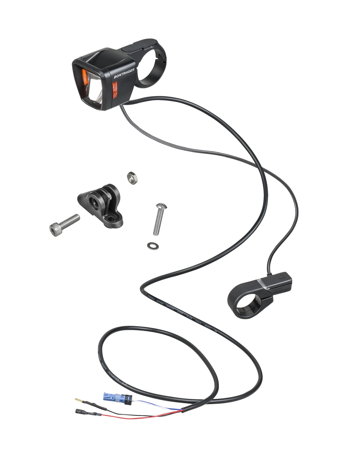

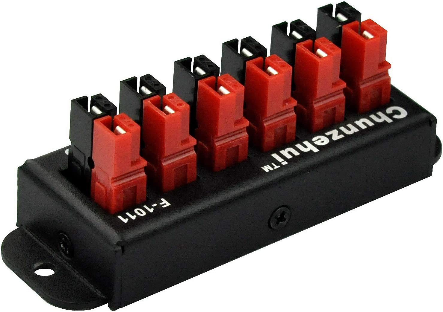

I use this Anderson distribution module between the battery & controller:

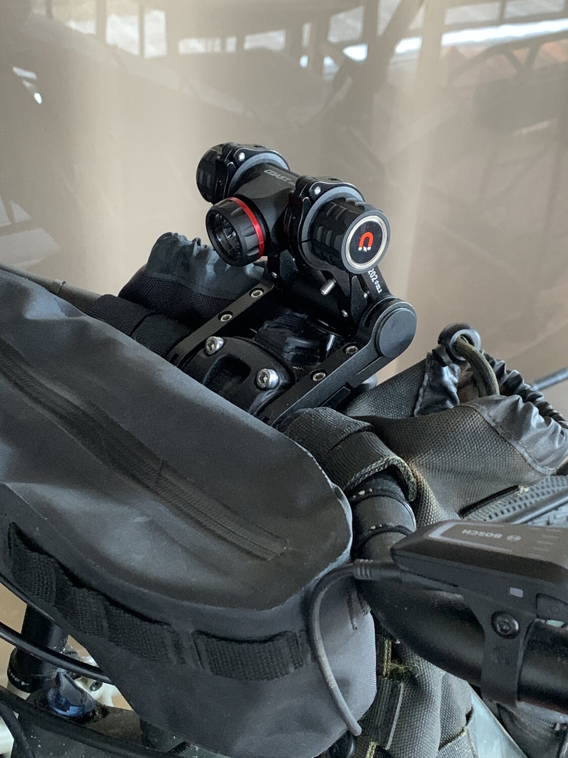

I use an handler bar extender to center mount a battery powered Niterider 3600lm Enduro light and have an option for a Niterider 2200lm helmet light. I only need to keep both lights on the lowest power level since there is enough street lighting and I have reflective gear on. I like the helmet light because driver's can see it better driving up a side street if my bike light is blocked by parked cars or landscaping. I can also turn my head towards the car on side street to alert them I have the right away.
The Niterider light does not come close to blinding on coming traffic compared to HID/LED headlights on modern cars (bike light pushed down to only illuminating about 10-15 feet ahead). I only use mid/max illumination if trail riding at night.

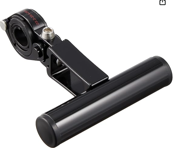

Handlebar extender:

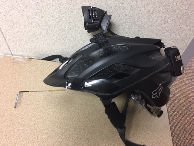

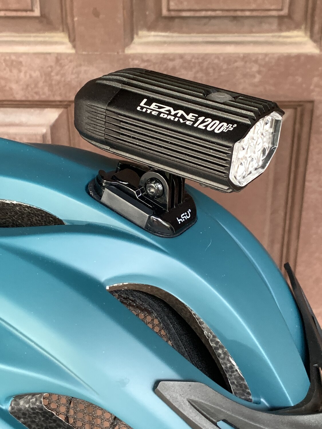

Fox helmet with Enduro Pro 2200lm with 6 cell battery in backpack or jacket pocket and Light/Motion Vis 180 rear light

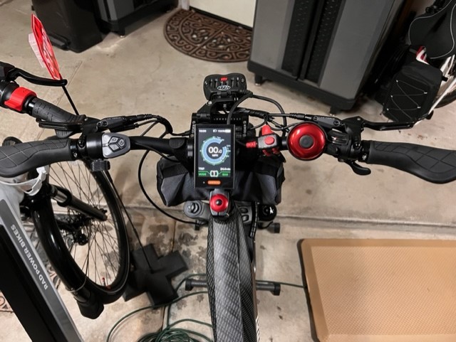

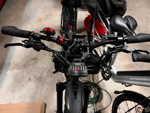

Himiway Cobra Pro with Niterider Pro Enduro 3600lm with 8-cell battery pack inside handlebar bag:

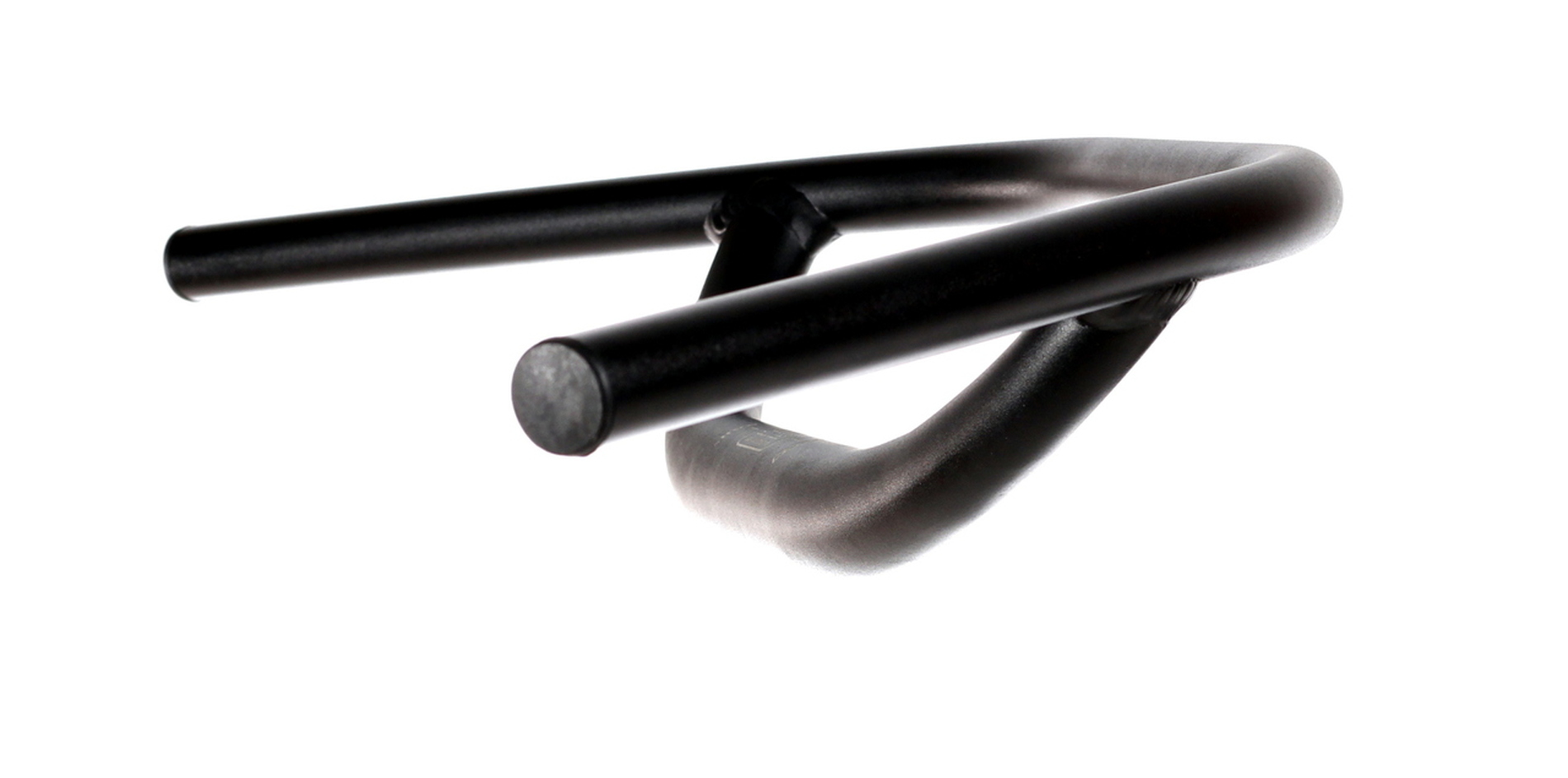

I never had much luck with bar extenders. I've tried a few, but none were sturdy enough for my needs. There may well be quality products out there, but I have yet to find one. I eventually decided to spend the $$, and changed out my handlebar with a Jones H bar:
I chose one with a 2.5" rise for a more upright riding position, but there are many styles available. All are rock solid and hold my heavy accessories with no movement, even on rough trails.
As above, I have both versions of the Jones Bars, standard and the riser. Yes, they are great bars with a nice extension to clamp whatever accessories you have. But keep in mind that these bars will shorten your reach somewhat with the 45 degree grip angle. So you might be looking at swapping out your stem as well.
