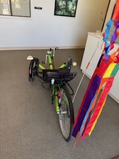

Here is my review of the kit:
I personally like the DM02 motors from ToSeven. I can supply discerning folks miles away with factory support in English from someone who knows the ins and outs, me. The motors are light, universal fit, and robust. Here is one on a trike. These are fully end user programable, challenge me on that. 90Nm. I can walk people through the entire install and programing. They kick azz over anything retail to the huddled masses like Specialized. How many degrees of angle do you want before kick-in 2, 3? What about perkey responsiveness vs. smoothness. That is all yours and more to dial in. The palmed sized silver thing between the pedals is the motor.
