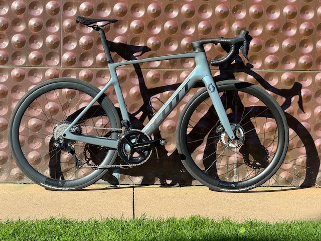

I mean, if the Scott Addict eRIDE is too heavy for you, you're probably best off just waiting for that class of bike to get lighter as tech progresses (which it will).

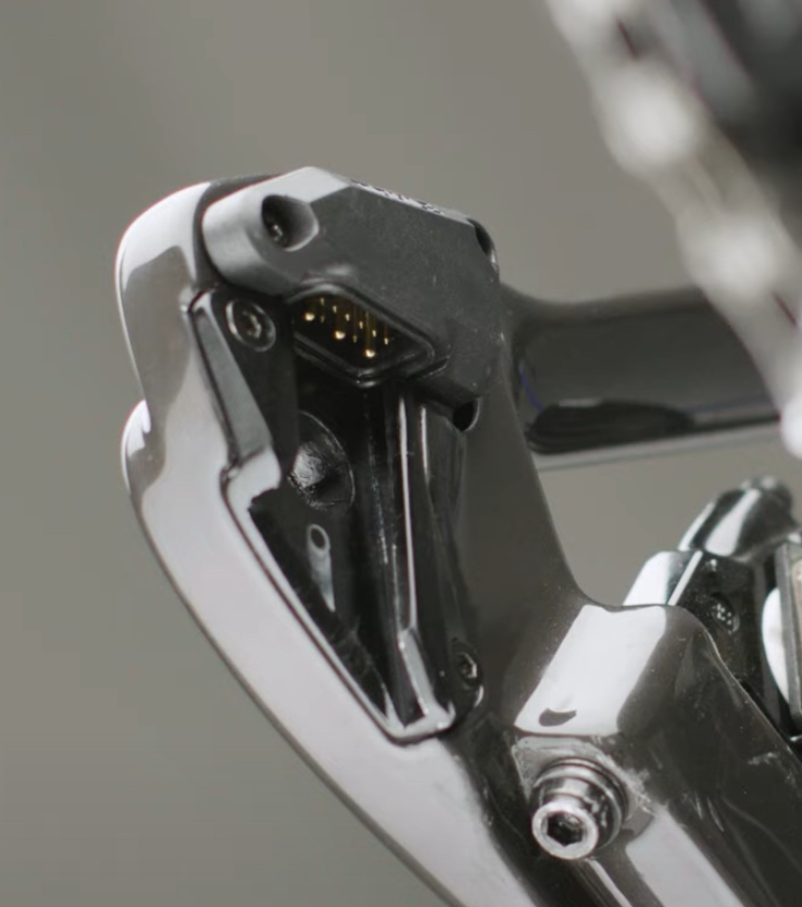

the x20 integrated connection dropout has a simple rectangular metal reinforcement which connects to a fairly large flat area of the frame, very unlike the small junction with only a circular through axle hole in a regular carbon road bike.
That's a really slick detail. Love how they eliminated a pain point for hub motors and turned it into a selling point.
