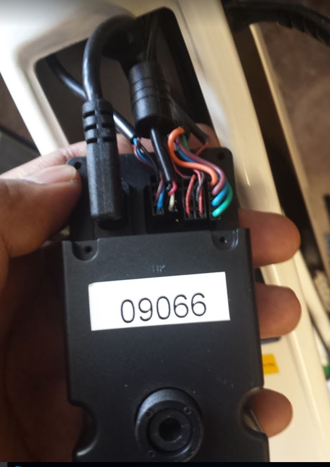

When changing the pins take a picture of your setup prior to removing any. The color codes in the instructions didn't match my bike exactly. Not all slots are used. Besides that use a good jewelers screw driver on your screws.
Thanks EriderM...did you by chance take a pic of the pins as inserted in your replacement Omni. Their diagram looks not too easy to read in terms of the matching of the pin structure; you must have got it right?
I had to replace my OMNI once back in June 2015.
It was fairly straight forward. Here is a pic.

Hi Ravi...I am apparently facing the "glitch" and my new OMNI unit should arrive tomorrow. I am a bit uneasy because I'm going to try and replace it myself and that will mean it is no longer under warranty. I'm 5 hours from the nearest dealer so a 10 hour trip plus gas,etc. has kind of driven me into the DIY phrase. The rep sent some instructions and has been more than very helpful in regard to the matter. My local bike shop would be willing to help me if need be and I have some folks that are pretty good with electrical stuff also, if needed. Hopefully, things will go well. If you have any other tips, please send them along...thanks

There is OMNI removal tool but I didn't receive it and I had to improvise. OMNI removal tool has 4 pins that sit in a groove and you rotate it to remove the remove the OMNI but if you use an object like toothpick as a proxy pin, you would be able to unlock teh OMNI. Once it's loose enough, you can use your hand to remove it completely.
Feel free to message or call me. The whole process shouldn't take more than 20-25mins if you do it yourself.

Interesting Ravi...I wrote the rep about the OMNI problem on a Saturday night, last, thinking that I would hear back from them on Monday or Tuesday. He responded right away and by Monday was ready to ship out a new unit to me. In the meantime, checking his correspondence on how to remove the unit and looking at my bike, I was pretty sure that a "special" tool would be needed to remove the button lock ring which was the way to remove the unit from the top tube, so I wrote this concern back to him. He responded by telling me that the tool did not come with the unit itself but that he would send me one with the unit which I could then send back to him with the failed unit (for which he also sent a return postage label!!). The guy was fabulous every step of the way thru several correspondences between us...and it made me happy that I am riding the Stromer. Given the limited number of dealers in the Northeast, it was very heartening to feel that they are trying their very best to support their product which is a superb machine in nearly every aspect. Thanks again for your help and I very much appreciate you help and advice, along with the opportunity to correspond with you directly if need be...
Smitty, I had the same experience. They sent the tool with the replacement. I could have used even something like a ballpoint pen to open it. The change is super easy. I am or too concerned about the job voiding any part of the warranty. I also recently installed the front shock kit. Bike is running and handling great!

Just finished up and got the portal signal down in the basement. It's a pretty easy job but I got a huge laugh out of my work! Turns out that I took the unit out, sat it down while I looked at the numbered wiring; turned around, picked up the old one and reinstalled it. Seemed to work o.k, but I knew that the new one had come with a thin clear sheet to prevent scratches on the face of it! Yikes, of course when I picked up the other unit, I realized immediately what had happened; so I got the joy of doing it twice with a smile on my idiotic face. The internals are as good as the externals on the bike. The cover on the bottom of the unit makes sure that everything stays in place and completely encloses the wiring pins...beautiful! I was glad that I had the removal tool; again, extremely well thought out and made it a snap to remove the button cover. Here's hoping that the bike keeps running as usual...great bike and I'm really happy with the Stromer folks and their helpfulness...thanks for the help along the way...

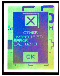

Hi Ravi, slightly off topic; have you ever heard from this error:
The error occurs in combination with the blue 983Wh battery and temperatures below 0ºC
How was the solution?
(Workaround is: Bring the battery into your flat and let it warm up)
I have been riding a Haibike for the past month. I have experienced battery shutoff once because the temp on that day was --22'C.
I'm sure this would happen to any bike with sophisticated BMS to prevent further damage.
