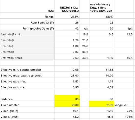

Why make a survey, this just needs to be calculated - see attachment
The table is theoretical...in reality some enviolo automatiqs have different performance. Hence the survey. Enviolo is CVT and high/low limits are subject to calibration. For me, belt tension had a huge impact on cadence because of apparent binding within or adjacent to hub that prevented enviolo from using the full 380%. All is good now. If cadence is higher than expected at max speed, check belt tension and adjust it down towards minimum spec. Suspect this is also causing issues with manual shifting IGH that are hard to turn.
So my table represents what it should look like if everything worked correctly and can be used as a reference point.
