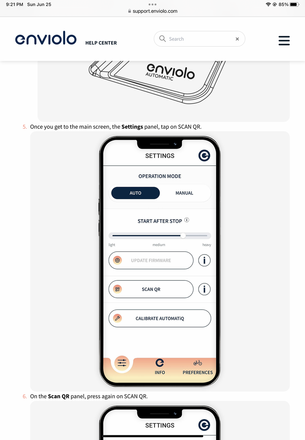

Ok, I called Specialized rider care. They told me that some Enviolo settings are overridden by Specialized, but cadence is not one of them. As @Tim C suggested, changing Start From Stop in the Enviolo app is not overridden. Hooray!
Hi, you can adjust the rpm via the Enviolo app, but every time the bike is started, the rpm is overwritten by the set value of the bike software, I have already been in contact with Specialized and they would investigate whether it is good is for the motor to adjust those values e.g. a lower rpm (50) etc

Just got back from the LBS. I test-rode a Vado 4.0 (chain) and a Vado 5.0 IGH.At first, I didn't like the IGH. When I first started pedaling, the cadence would be super fast/RPMs were high, but I wasn't moving much. It seemed like the system needed a few moments to react. The same thing would happen after decelerating and then accelerating again.I took it back to the shop, thinking, "this isn't for me." Got on the Vado 4.0 non-IGH—and was irritated that I had to change gears! I rode it around for a bit, and while it didn't have the delay issue, I found myself missing the IGH.So, I tried the IGH again. This time, I played around with the cadence settings a lot more. I found that the "high cadence from start" issue was better when I set the cadence to "slow", "slower", or "slowest", and/or if I started in Eco mode rather than Sport or Turbo.
