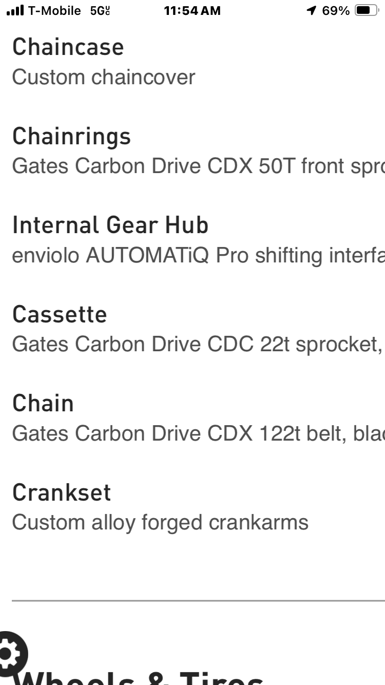

If you look at the specs on the web it will show 22T on the 5.0

The 22tooth will make a big difference
Excellent, thank you Seventysomething!
