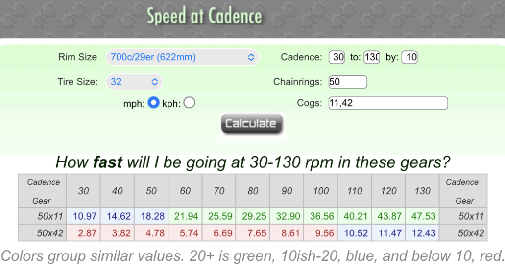

Can you use this site https://www.bikecalc.com/speed_at_cadence
with the front and rear gear teeth, and then multiply by the eviolo % range above and below 100% ?
For example: my single speed has 64x20 gearing, and my speed in mph x 4 = ~ my cadence. Now I have a Wahoo gps and cadence sensor, but before that used that estimate. 20mph = 80rpm, 30mph = 120rpm
If as mentioned, the IGH is like an 11-42 cassette range, and the front is 50, from bikecalc…
