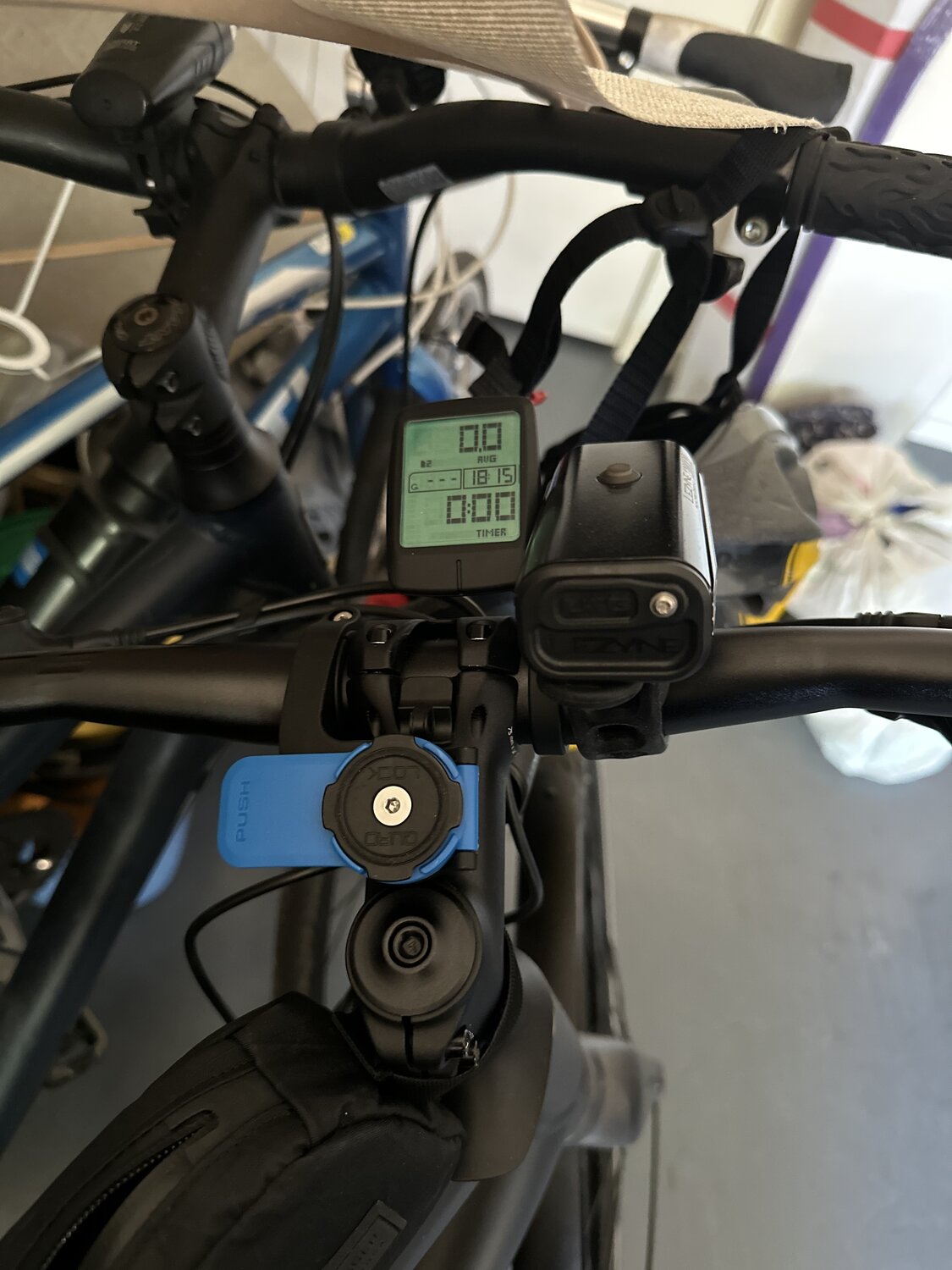

- Quadlock holder for my iPhone
- TCD computer

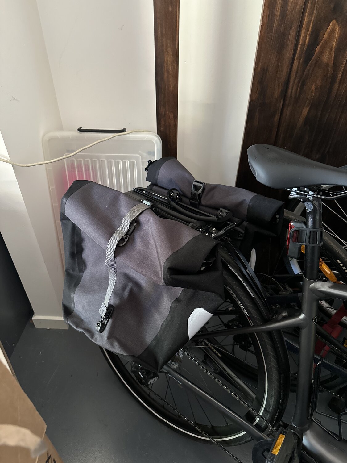

- Ortlieb panniers (they don’t look great because they are empty)
I’m waiting for a bracket for my light to mount under my TCD from my LBS.
