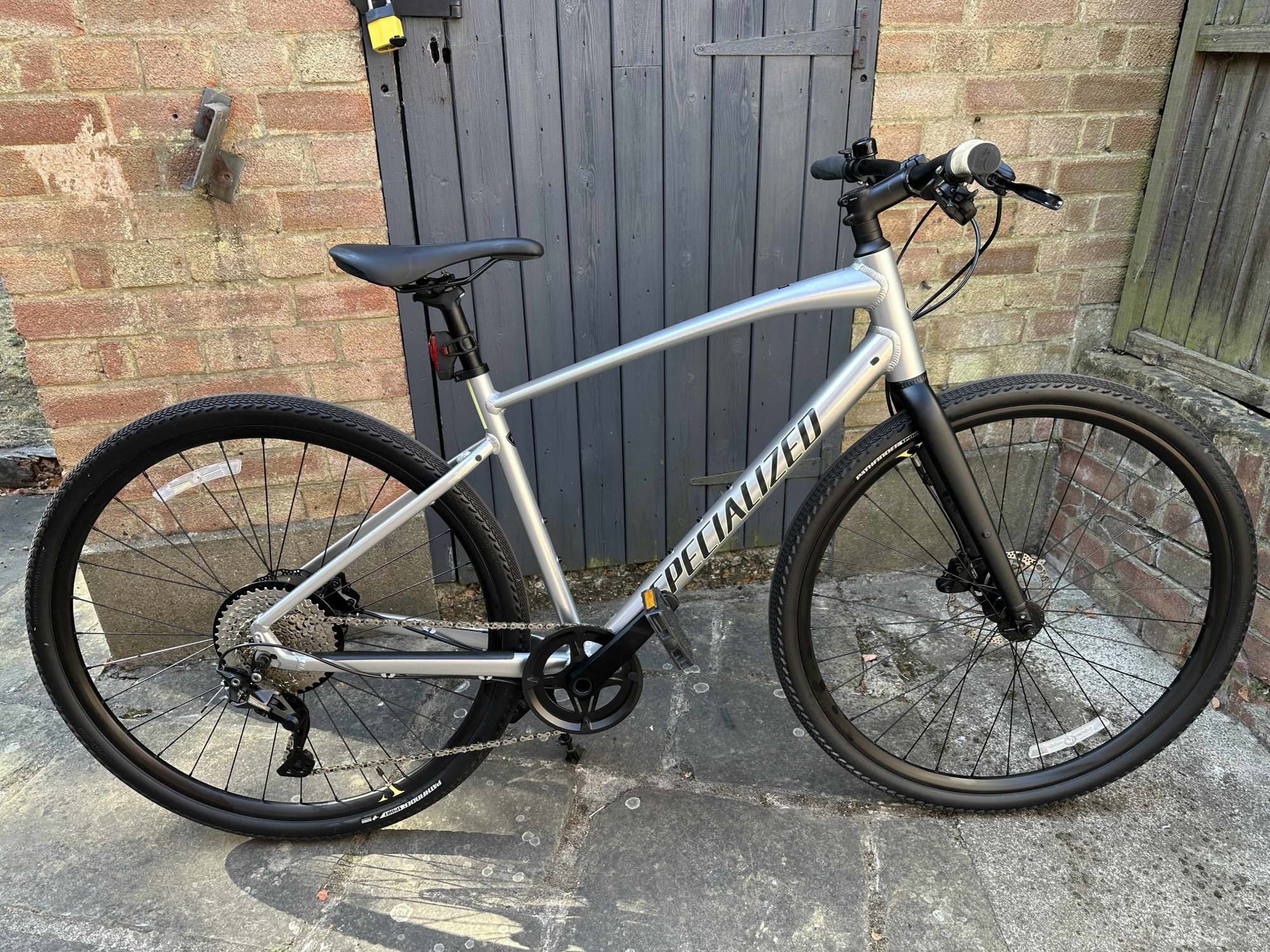

Looked online for an immediate second hand replacement maximum 200 pounds. But I was drawn to an immaculate looking Sirrus X 3.0 that was 4 years old just 2 mile away. I was not paying the asking price but offered 400 dependant on inspection as my thinking was that as it was similar to my Vado SL - same size, geometry etc it could be a backup ride for me as well. It was sold by a lovely elderly couple who had clearly bought the bike after Covid with the intention of getting out but sadly I think health had got in the way. It was stored covered and dry and had clearly never, ever been used - showroom condition.
And what a lovely thing it is! rides like a conventional 11kg version of the Vado SL but beautifully tight and smooth and a really lovely gear change with the Deore 10x setup that I am not sure my Eagle AXS could match at its best. Pathfinder Sport 42s as well. I was not intending to pay so much for a run around but I am glad I did on this occasion!

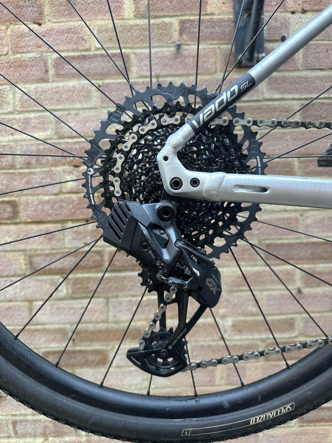

I somehow managed to trash my Eagle AXS derailleur :(
My new XX1 chain came off changing down on a hill and wrapped around the cassette and bent the cage
LBS is telling me the cage is not replaceable on older GX AXS and the entire derailleur needs replacing although their senior technician will do a proper inspection today.
Hopefully the 3 week old XG-1275 cassette is not damaged or I am no doubt looking at a seriously hefty bill
Cycling is expensive.
I might have not sized the chain right. It was a couple of links longer than the old one but as the old one was still not shifting perfectly I was willing to try it and sacrifice a couple of power links getting it right. It seemed to shift fine for awhile until armageddon struck.
LBS is saying a replacement is a S500 AXS full derailleur and a new S500 chain - they are also saying the bottom bracket needs a look at as there is play. I am not ruling out they messed up something fitting the XG-1275. They do seem to return the bike in a worse state than when I take it in - I often find things not tightened correctly. Hard to find expertise these days I guess.

It's not recommended to use the existing chain to measure length other than a quick reference. SRAM has specific instructions for chain sizing. "Wrap the chain around the chainring and largest cassette cog (bypassing the rear derailleur), with the flat edge of the chain links facing away from the chainring and cassette. Add two inner links and two outer links where the chain starts to overlap, and cut there." (The "flat edge" refers to T-type chains which aren't needed on Creo's or Vado SL's non-T-type transmissions until they go to 13 spd.)
