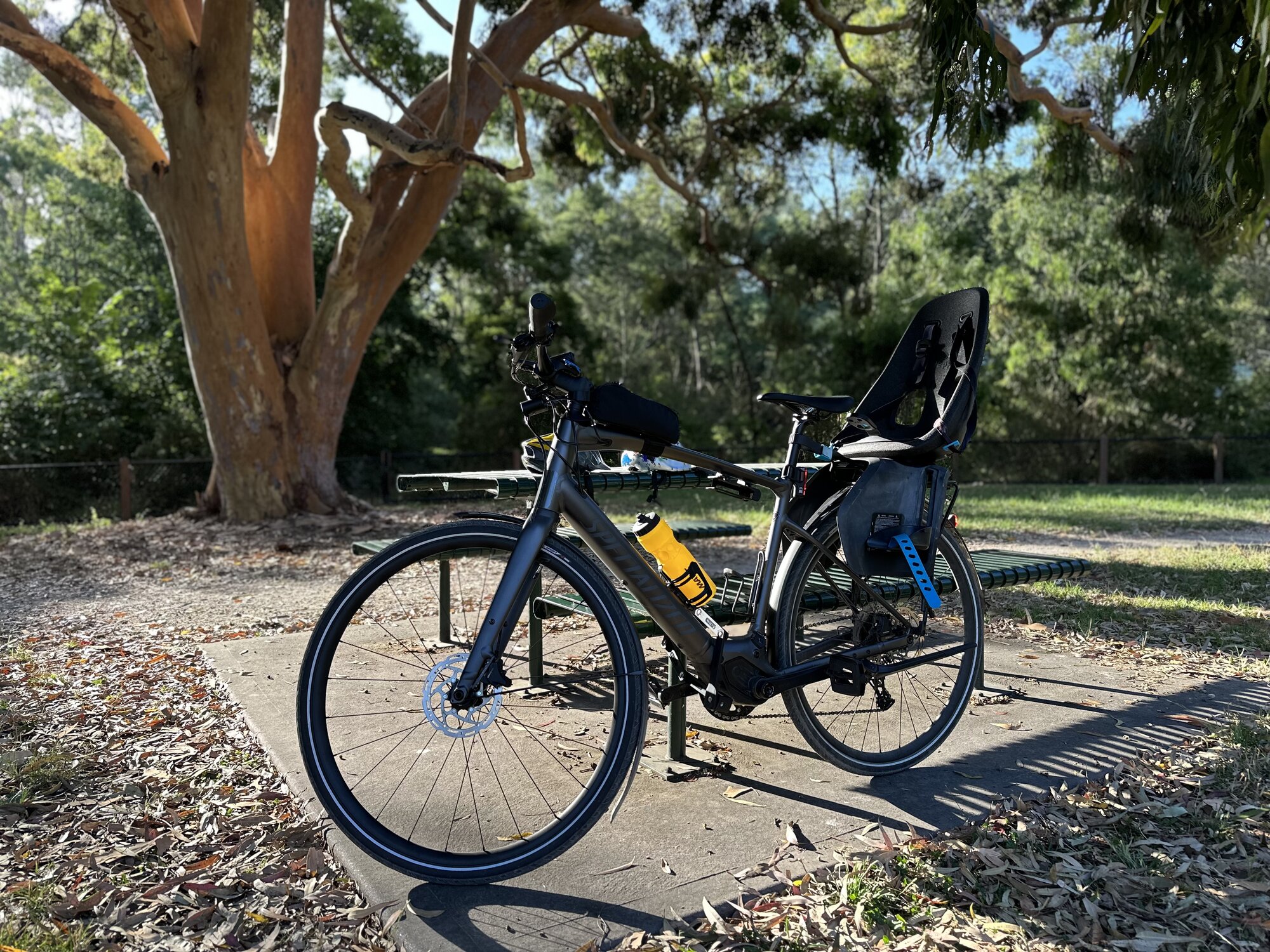

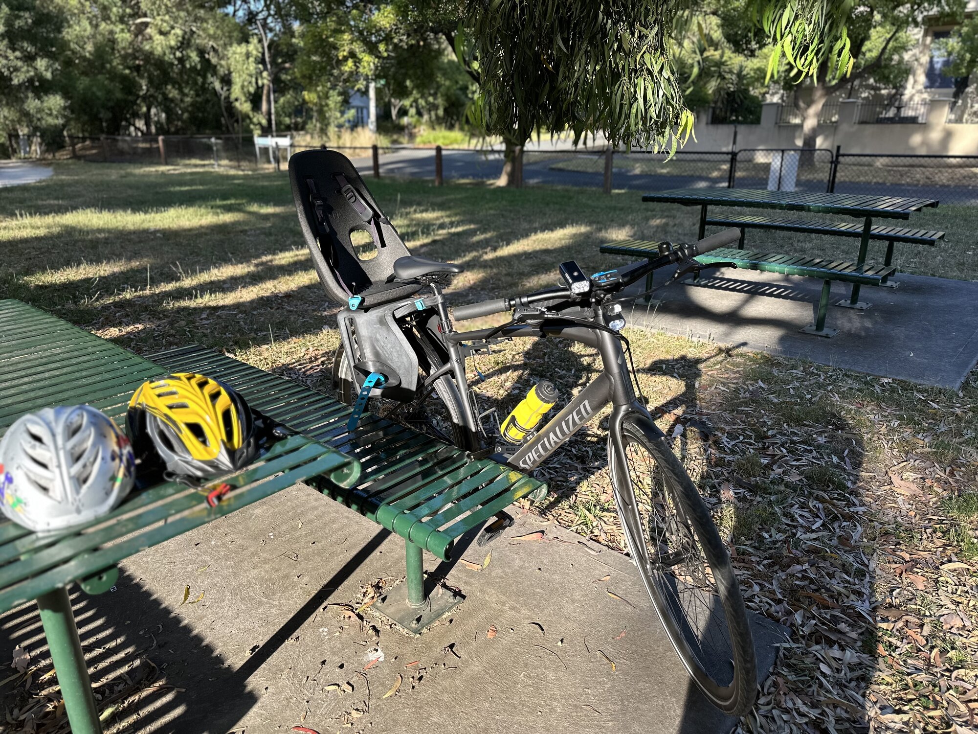

Gday from Australia 🇦🇺
I love my bike - anyone else?
I also being able to take my daughter around!!
